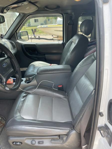

2002 Ford Explorer seat and console in 1996 Ford Ranger:
2002 Ford Explorer seats

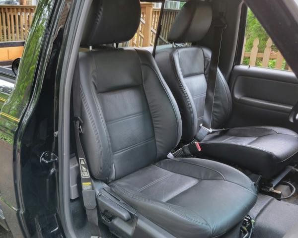

Sport Trac Seats in a 2001 Ford Ranger:
Sport Trac seats in a Ford Ranger

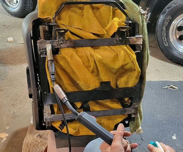

Forum member Lefty added leather seats from a Subaru by welding a bar across the bottom of the sliders and then welding the feet from the rang seats to them.
Subaru seats in a Ford Ranger
Welding seat brackets
