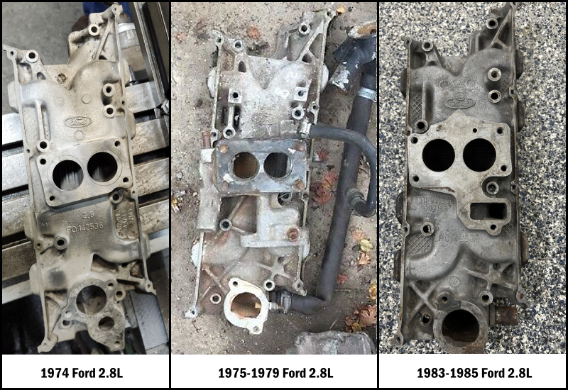

Intake Manifold
The Ford Ranger intake manifold had a taller plenum and slightly longer runners to improve torque. The car manifold had a short “pancake” style plenum.

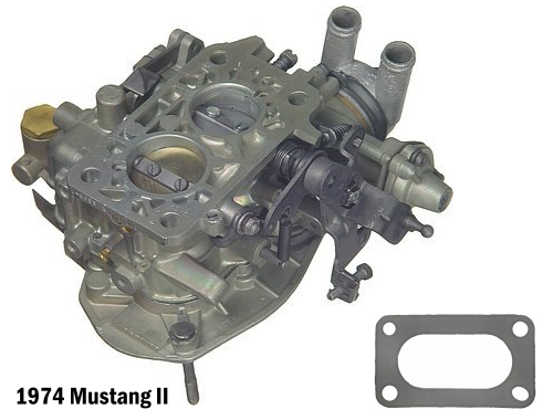

Carburetor

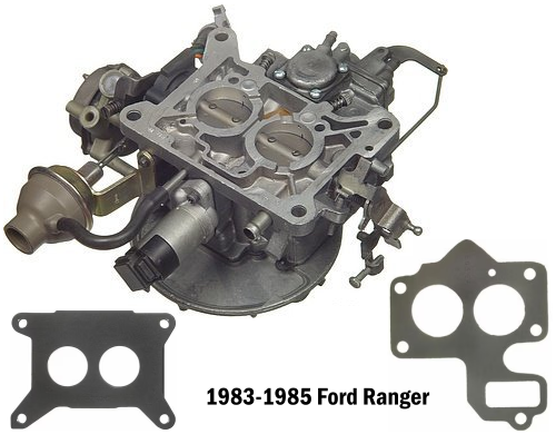

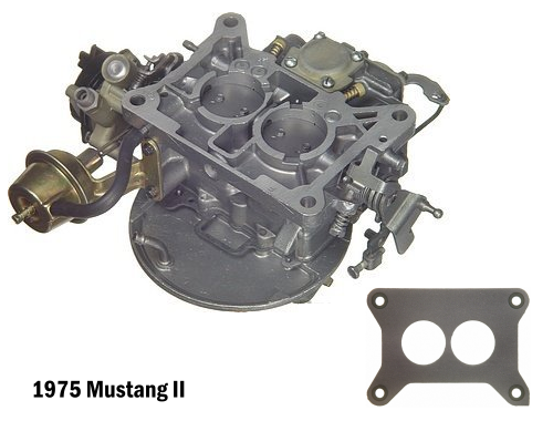

The Ford Ranger comes stock with the 2150A carburetor, which is computer controlled unlike the previous 2150 models; without a computer, the 2150A is basically useless. An easy performance add-on is a Holley 350, or 300cfm 2bbl carb and should bolt in place of your old one (it comes with either automatic or electric choke).
The Mustang II and pinto used a regular 2150 carburetor that doesn’t require computer feedback.

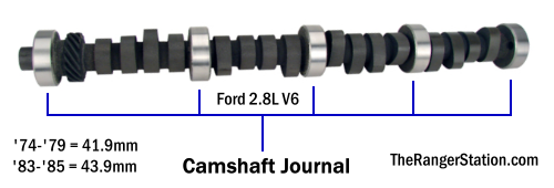

Camshaft Journal
The Ford 2.8 used in the Ranger & Bronco II have a 43.9mm camshaft journal.
The Ford 2.8 use in the Mustangs and Pintos have a smaller 41.9mm camshaft journal.

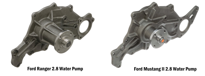

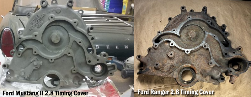

Water Pump / Timing Cover
The Ford Ranger 2.8 uses a different timing cover and water pump than the Ford Mustang II / Pinto 2.8. Use can see the differences in the casing (The Mustang II has an extension on it) and the Ford Ranger water pump reaches out about 1.5-inches further than the Mustang II pump.

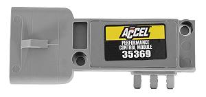

If you’re wanting to maintain the stock ignition, I would at least switch to a Remote Mounted TFI Module with a heat sink and actually replace the TFI module with a Holley Accel 35369 TFI Ignition Module.
Holley Accel 35369 TFI Module

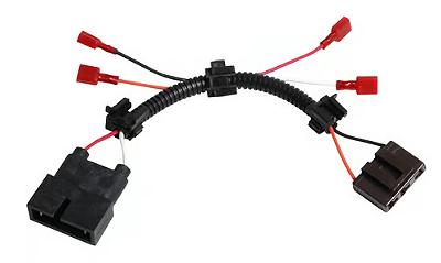

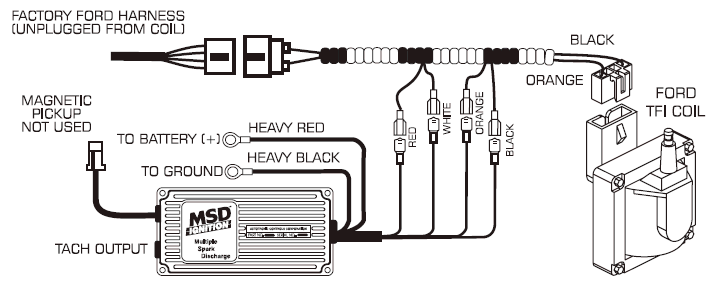

MSD offers wiring harnesses to simplify the installation of a MSD 6 series box on late model vehicles. The harnesses plug in between the ignition coil and the factory coil connector. Four wires with corresponding colors and matching connectors then connect directly to the MSD 6 wires. These harnesses reduce the installation time, reduce or eliminate cut wires, and allow you to quickly convert back to the factory ignition.
MSD-8874 Harness
MSD-8874 Shown Above
The MSD to Ford TFI Coil Harness is designed to provide a splice-free and simple installation of an MSD Ignition Control to Ford vehicles equipped with a TFI Coil. On MSD 6 & 7 Series Ignitions all of the wires connect to the corresponding colored wires. MSD 7 Series Ignitions share the same color wires.
1. Disconnect the connector from the coil and connect it to the MSD PN 8874 Harness.
2. Connect the other end of the Harness to the Coil.
3. Connect the four wires of the Harness to the MSD Ignition Control.
MSD 6 Series Ignition
MSD TFI Ignition Wiring Diagram

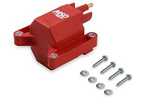

Ignition Coil
MSD Blaster TFI coils will work with stock TFI ignition systems as well as MSD-equipped cars and trucks. Looking to get a little more output voltage from your Ford ignition system? Just bolt in one of these MSD Blaster TFI coils.

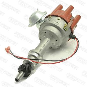

Duraspark Conversion
The better option would be to do a Duraspark Conversion and replace the EEC IV computer system / TFI Module. This is going to require finding a distributor from a 1975-1978 Mustang II, 1979 Mustang or 1975-1979 Ford Pinto. You’ll also need a Duraspark ignition module, coil, and a normal, non-feedback, 2-barrel carburetor.
Powerspark Conversion
If you can’t find the right distributor for a Duraspark conversion you can opt for an aftermarket Powerspark Distributor. The Powerspark distributor has a built-in ignition, so you don’t need the Duraspark ignition box, just a coil.

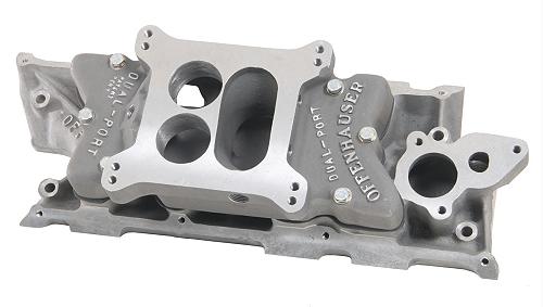

Intake Manifold
The 2.8L V-6 comes with a 2-bbl carburetor and manifold with a traditional round metal air filter container. Offenhauser offers a 6097DP 4-bbl Intake Manifold.  The ignition system must be changed to earlier Duraspark vacuum advance unit eliminating the EEC-IV computer / TFI and pollution equipment.  You can use the distributor, ignition module and coil from a 1975-1978 Ford Mustang / Pinto. The Offenhauser Intake does not have an EGR setup.

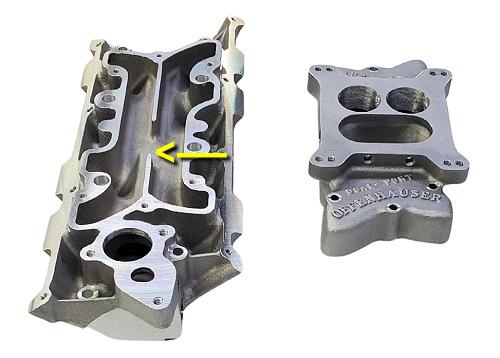

The Offenhauser intake manifold offers very good low and midrange power and torque characteristics. The patented Dual Port design actually separates the primary and secondary carburetor circuits into two individual (relatively small) passages. As a result of this unique arrangement, a high mixture velocity is maintained in both the primary and secondary passages of the manifold thus creating a wider torque curve than would normally result if a conventional manifold were used. An added benefit of the dual port concept is that carburetors can actually be a bit too large and still perform well. In fact, Holley 465cfm carburetors are frequently used in racing V6’s with little to no loss in low and midrange power.
Offenhauser 6097DP Intake Manifold

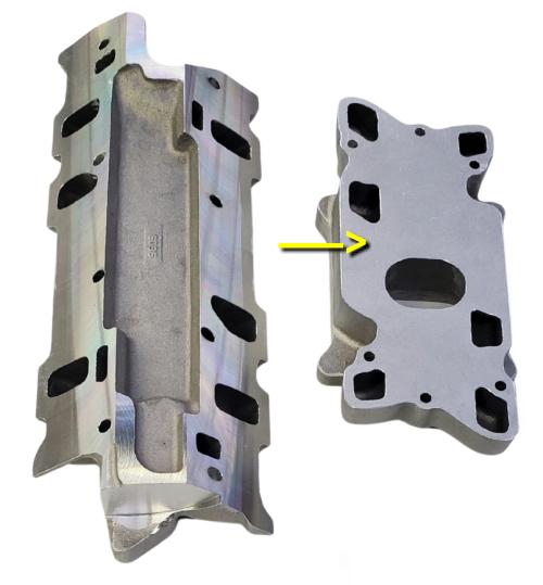

The lower half of the Offenhauser intake manifold is almost a carbon copy of a stock intake manifold except that the plenum divider has been relieved in the middle. See the yellow arrow in the image below.
The upper portion of the Offenhauser intake shows an empty separate secondary manifold channel. This, in essence, creates a manifold inside a manifold.

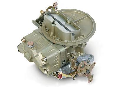

Two-Barrel Performance Carburetors:
Ideally, a good two-barrel carburetor would be easily available, inexpensive, very tuneable, easy to service, and would provide exceptional performance. The Holley Model 2300 (0-7448), 350cfm two-barrel performance carburetor meets all of these criteria with ease. This carburetor is essentially the front half of a standard Holley (4150/4160) four-barrel carburetor. Therefore, most of the tuning tips applicable to Holley four-barrels also apply to this one. This carburetor should be used in all performance applications that require a two-barrel manifold combination. Interestingly, this carburetor is so user-friendly, it makes a very desirable replacement to the stock factory carbs.
Holley 0-7448 Two-Barrel Carburetor
NOTE: The Holley 0-7448 Two-Barrel Carburetor has been discontinued, and Holley recommends the 0-7448SA as a replacement.

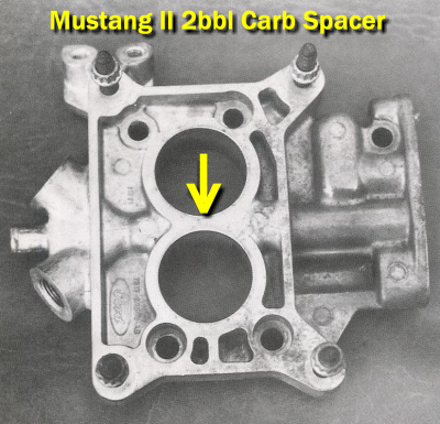

When restricted to the use of a two-barrel carb, you should remember a few rules of thumb to get the most from your investment. First, resist the urge to “over-cam” the engine. Two-barrel carbs will respond better to relatively short duration cams with fast lift rates. Look for something in the 210-225 degree duration (@ 0.050in) range. Second, install an open plenum spacer under the carburetor. This spacer should be a minimum of 3/4in thick. An inexpensive alternative to making a spacer of this type is to use a spacer from a 1976 Ford Mustang II or Capri that was fitted with the Motorcraft carburetor.
Simply mill out the divider between the two throttle bores on the plate and seal off any remaining holes once dedicated to emissions devices. Install the spacer using new gaskets on each side. These gaskets should also have the material between the throttle holes removed. Once you have completed these steps, simply follow the tuning suggestions that apply to the primary side of the Holley four-barrel carburetor.

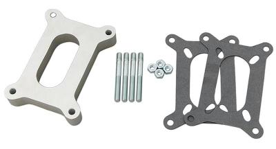

You may want to try the Trans-Dapt 2-Barrel Carb Spacer #2135.

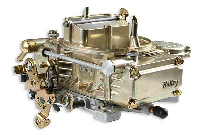

The Holley 390cfm Four-Barrel:
When Offenhauser introduced its Dual-Port four-barrel manifold for the Ford V6, it exposed Ford V6 enthusiasts to an entirely new performance carburetor option. That option was the 390cfm Holley four-barrel carburetor. The Holley four-barrel is without question one of the most versatile, successful, and tunable carburetors in the world.
For performance Ford V6 applications, the best Holley four-barrel carburetor available is the 0-8007, 390cfm, model 4160. Although other 390cfm carbs are available, the 0-8007 requires the least amount of modification to provide optimum performance. The 0-8007 will accept most of the Holley “tick” parts such as center hung floats, secondary metering blocks, 50cc accelerator pumps, and so on. It works very well with increased compression ratios and “big” camshafts. In fact, the 390 four-barrel easily accommodates engines capable of producing in excess of 220 horsepower. The Holley 390cfm carburetor/Offenhauser Dual-Port intake manifold combination is, without question, the most effective readily available intake system for a high-performance Ford V6.

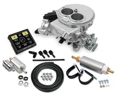

Holley Sniper EFI 2300 Conversion

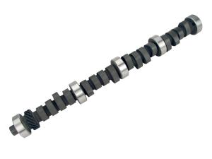

Comp Cams offers three different camshafts for the Ford 2.8L (2800):
38-101-4: Solid: Good Cam for OEM replacement or rebuild. Low RPM torque with good economy. Very Smooth idle.
38-240-4: Solid: Performance with economy, power increase in low-mid RPM range. Smooth idle.
38-241-4: Moderate performance Camshaft. Strong in mid-range RPM. Noticeable idle.

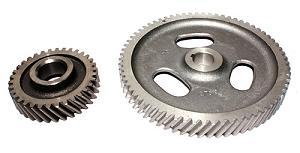

New timing gears are offered by both Comp Cams (3236CPG) and Racer Walsh (RWA 6548). These are an all-metal design and will outlast the stock fiber type timing gears. These are designed as a stock replacement upgrade.

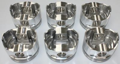

Pistons
Racer Walsh sells a set of Wiseco Ford 2.8L 9-1 Pistons. The stock 2.8 compression ratio is 8.7:1.

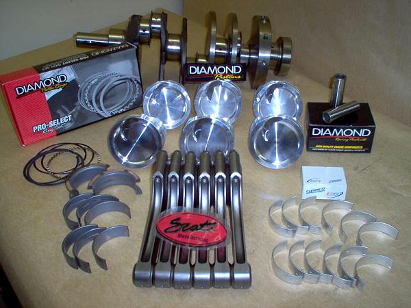

Stroker Kit
Tom Morana sells a Stroker Kit. A Stroker Kit is forged replacement engine components (forged custom pistons/compression of choice, forged connecting rods, performance piston rings, rod & main bearings, and Stroker crankshaft), which is much stronger than stock internals, and a good solid foundation, for those who intend on using boost e.g. Nos, turbo charging or supercharging, or N/A. This Stroker Kit will take you from 2.8-3.2 for 3–40 hp gains depending on compression ratio, cam etc. $3,500. USD.
**Your crankshaft core IS REQUIRED as an exchange for the Stroker Crank** Special shipping instructions needed before shipping. We pay for your core return shipping.
