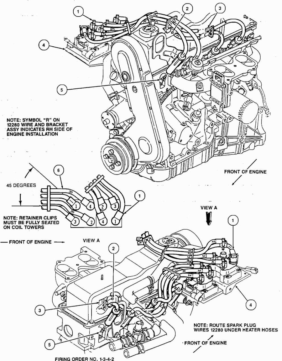

Hi ya'll. I'm in need of help with my 2000 2.5 8 plug. I hired a guy to do plugs and wires and now the idiot cant remember how to wire the coils. I thought I saw a diagram on this some time ago but can't find it. Can anyone help? Thanks! Edit- Below is one I found. Can anyone confirm this is correct?
  • 2.5 8 plug coils/plugs wiring
I posted a picture HERE if you scroll down a bit, it shows the coil with numbers on the Motorcraft sticker, on both coil packs just make sure 1 and 4 are on the 1 and 4 side and 2 and 3 are on the 2 and 3 side, you can mix up 1 and 4 or 2 and 3 but not across those pairs
Thanks. I found a diagram shortly after I posted and got the job done. Local shop wanted $300 to do plugs and wires. My neighbor wanted to help me because I've fixed a few things for him and I'm dealing with a neck injury. Good guy but hopeless at car repair. Lil Red is running great at 280k plus.
