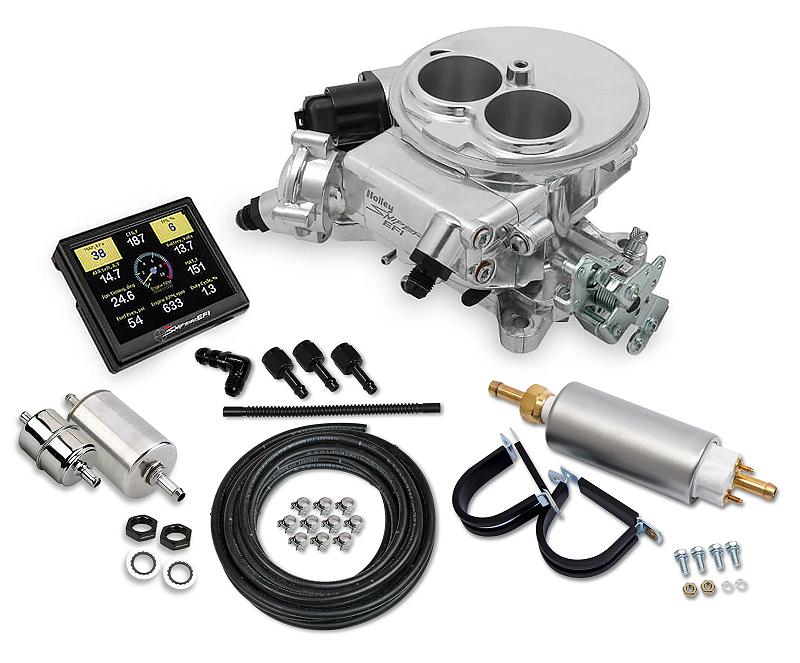

Holley Sniper EFI 2300
With the Holley Sniper EFI 2300, you can put an end to cold start issues, hesitations, vapor lock, and engine flooding on many vehicle applications. Our kit is the easiest way to upgrade to EFI in a cost-efficient package with just four connections to get started. This kit is capable of supporting up to 350 HP naturally aspirated or 285 HP forced induction with (2) 100 lb./hr. fuel injectors. Sniper 2300 was designed to be installed at home in your garage with minimal tools and the support of Holley’s comprehensive installation manuals and online videos. The high resolution 3.5” LCD touchscreen user-friendly setup wizard has you answer a few simple questions about your engine and the system will begin self-tuning with no laptop or tuning experience required. This kit also includes 20 ft. of 3/8″ Earl’s Vapor Guard fuel hoses, fuel pump, fuel filters, and all necessary hardware for installation to return fuel into your fuel tank. For a more comprehensive installation and maximizing performance, check out our HyperSpark Ignition, air cleaners, and digital dashes.
You can purchase this as a Master Kit which includes the fuel pump, filters, and fuel line, or with just the O2 sensor, coolant temp sensor, throttle body assembly, harnesses, and 3.5″ touch screen controller.

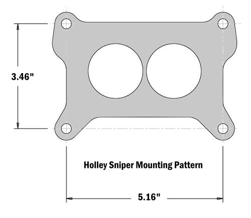

1974 Ford Mustang II 2.8L – This engine used a Holley 5200 carburetor with a 92x45mm mounting flange bolt pattern. You have to convert it to a Holley 2300 5.16×3.46″ mounting flange bolt pattern. It does NOT have the proper carburetor flange bolt pattern to mount the Holley Sniper.
Holley Sniper mounting bolt pattern

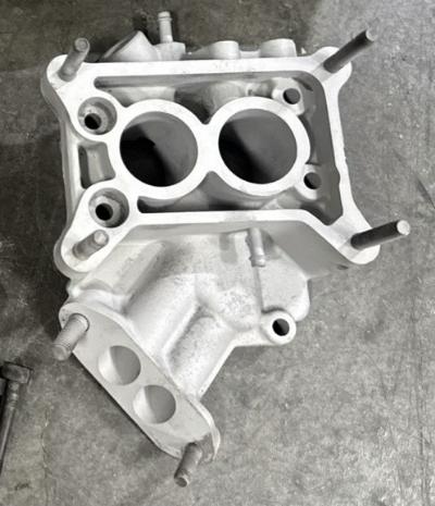

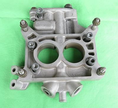

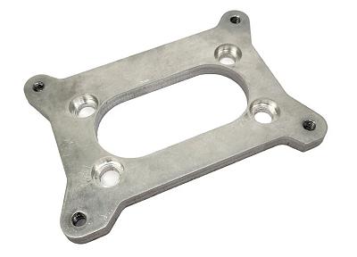

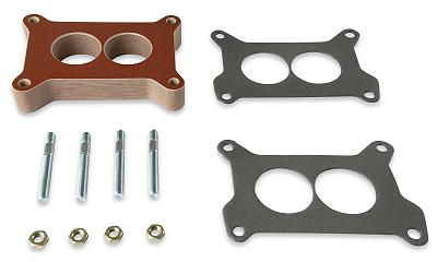

You’ll need the two-barrel carb spacer used for the 1975-1979 Ford Mustang and Pinto, or the carb spacer used on the 1983-1985 Ford Ranger, 1984-1985 Ford Bronco II, and 1986 Ford Aerostar as shown below. Plug any openings in the spacer that were once used for vacuum & emissions. You can also get a Weber to Holley 2300 adapter if you can’t find a factory spacer. In addition to the factory spacer to adapt the bolt pattern, you’ll need a Holley 2BBL Carb Spacer to make sure that the Sniper EFI clears the valve covers.
Ford Mustang & Ford Pinto carburetor spacer
1975-1979 Ford Mustang and Pinto carburetor spacer
1983-1985 Ford Ranger 2.8 carburetor spacer
1983-1985 Ford Ranger, 1984-1985 Bronco II, or 1986 Ford Aerostar carburetor spacer
Weber to Holley 2300 carburetor adapter base
Weber to Holley 2300 carburetor adapter base – Converts 92x45mm to Holley 2300
Holley 2BBL Manifold Spacer
All Other 1975-1986 Ford 2.8’s – The Holley Sniper EFI will bolt to your factory spacer, but you’re going to need to add the Holley 2BBL Manifold Spacer to make sure that the Sniper EFI clears the valve covers.

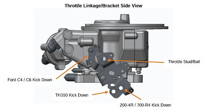

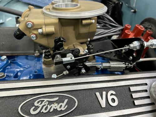

2. Place the Sniper EFI throttle body on top of the new flange gasket on the manifold. Install the hold down nuts and snug down progressively in a “criss-cross” pattern (60-80 in./lbs.). Depending on your application, this is also the time to install your throttle bracket and transmission kickdown brackets. You may be able to re-use the stock style throttle stud or transmission studs from your carburetor.
Holley Sniper 2300 throttle and kickdown linkage
3. Reconnect the throttle and if applicable transmission kick-down linkage. Be sure to check for any binding conditions and correct before proceeding. Poorly routed throttle cables & linkages can cause throttle pedal issues.

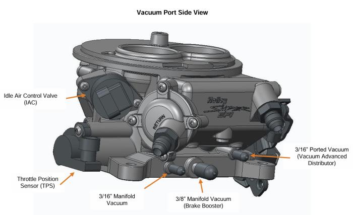

4. Reconnect the appropriate vacuum hoses to the Sniper EFI throttle body. Be sure to plug any vacuum sources not used on both the Sniper EFI Throttle Body and on the Engine.

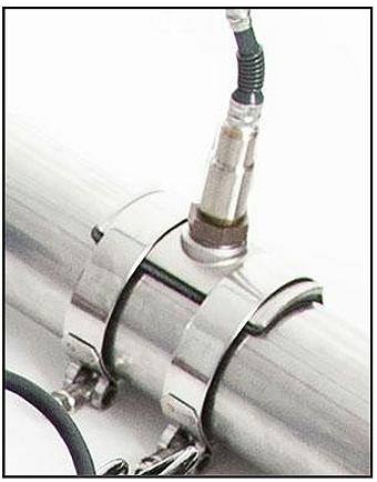

You’ll have to install the O2 sensor that comes with the kit. The kit comes with a mount so all you have to do is drill a hole in the exhaust, clamp on the mount, and install the sensor.
Holley Sniper 2300 O2 sensor

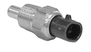

Coolant Temperature Sensor
Install the Coolant Temperature Sensor into a 3/8” NPT coolant passage in either the intake manifold or cylinder head. Do not overtighten or damage to the cylinder head or intake may occur. It is best to drain the some of the coolant before the sensor is installed. Use thread sealer or a small amount of thread tape. Do not install the sensor in the thermostat housing, or in an area that will not see a constant flow of coolant.

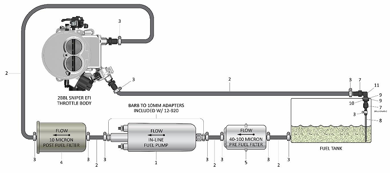

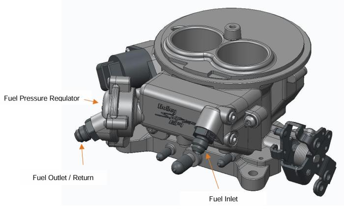

Connect fuel feed and return hose. It is mandatory that the fuel outlet/return comes from the fuel pressure regulator and the fuel inlet must go to the inlet fitting on the 2300 Sniper EFI. The inlet and outlet are indicated in Fuel Fitting Overview below. The Sniper EFI System comes with a built-in fuel pressure regulator, factory set at 58.5psi. We recommend at least a 3/8” feed line and 3/8” return line.
Note: Fuel pressure should be checked on the inlet fuel line before initial start-up during the fuel pump prime. We recommend Earl’s Part number 100187ERL (0-100 psi Liquid filled gauge) & AT100199ERL (-6AN Gauge Adapter) to check fuel pressure.
Holley Sniper 2300 fuel connections
DANGER! Take precautions to ensure that all fuel components are away from heat sources, such as the engine or exhaust pipes. A fire or explosion hazard could cause serious injury or death!
DANGER! Before disconnecting or removing fuel lines, ensure the engine is cold. Do not smoke. Extinguish all open flames. An open flame, spark, or extreme heat near gasoline can result in a fire or explosion causing property damage, serious injury, and/or death.
DANGER! Never get under a vehicle supported only by a jack. Serious injury or death can result from vehicles falling off of jacks. Before working underneath a vehicle, support it solidly with jack stands.
Follow the instructions and make sure that you install the fuel system properly.
Holley Sniper 2300 fuel line diagram
The Sniper EFI system requires a return fuel line to the fuel tank. The “Master Kit” includes the hose and fittings necessary for a return line installation on most vehicles.

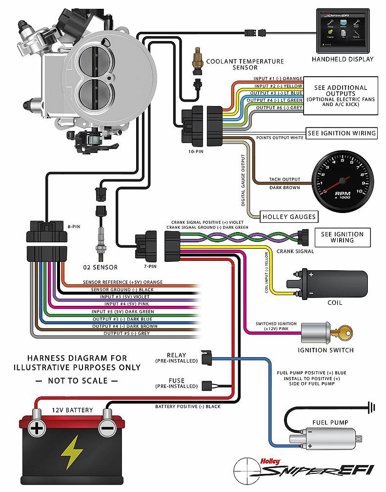

ECU Wiring Overview
The Sniper EFI throttle body comes with sensors pre-wired for easy installation. The illustrated diagram below is intended as an overview of how the system should be wired. Remember, the main ECU power and ground must be connected directly to the battery AFTER all other wiring installation has been performed. The 8-pin connector applies to part numbers 550-852, 550-853 & 550-854.
Holley Sniper EFI ECU wiring diagram
Pigtail & Loose Wire Connections
1. Pink Wire = 12V Switched – Should be connected to a switched +12 volt power source. Power source should only be active when the ignition is on. Make sure source has power when engine is cranking as well (check with voltmeter). Not all sources apply power when the ignition switch is in “cranking” position. DO NOT connect to a “DIRTY” source like an ignition coil!
2. Red Wire = Battery Positive – Connect directly to the battery post. This powers the Sniper EFI system.
3. Black Wire = Battery Negative – Connects directly to battery negative post.
4. Blue Wire (Optional) = +12v Fuel Pump Relay Power Output – Used to directly power a fuel pump (max current 15A). Make sure to terminate blue wire properly if not utilizing blue wire to provide power to the fuel pump.

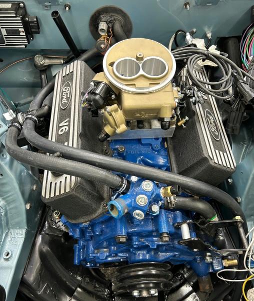

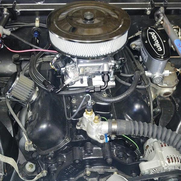

Installed photos
Holley Sniper EFI fuel injection on a Ford 2.8L V6
These next two are a ‘work in progress’.
Holley Sniper 2300 EFI on a Ford 2.8L
Holley Sniper 2300 EFI on a Ford 2.8L #2
