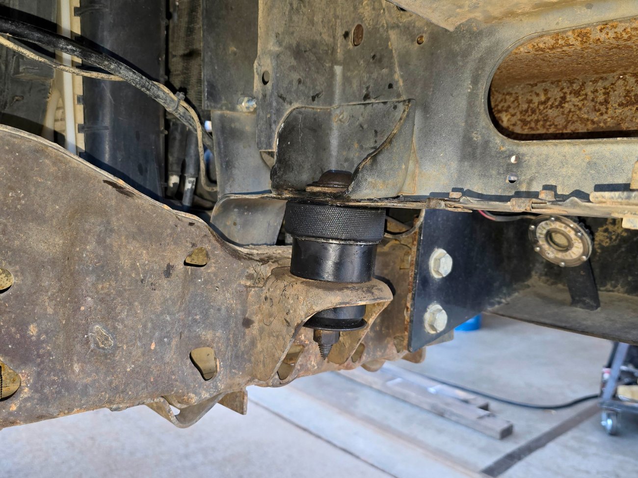

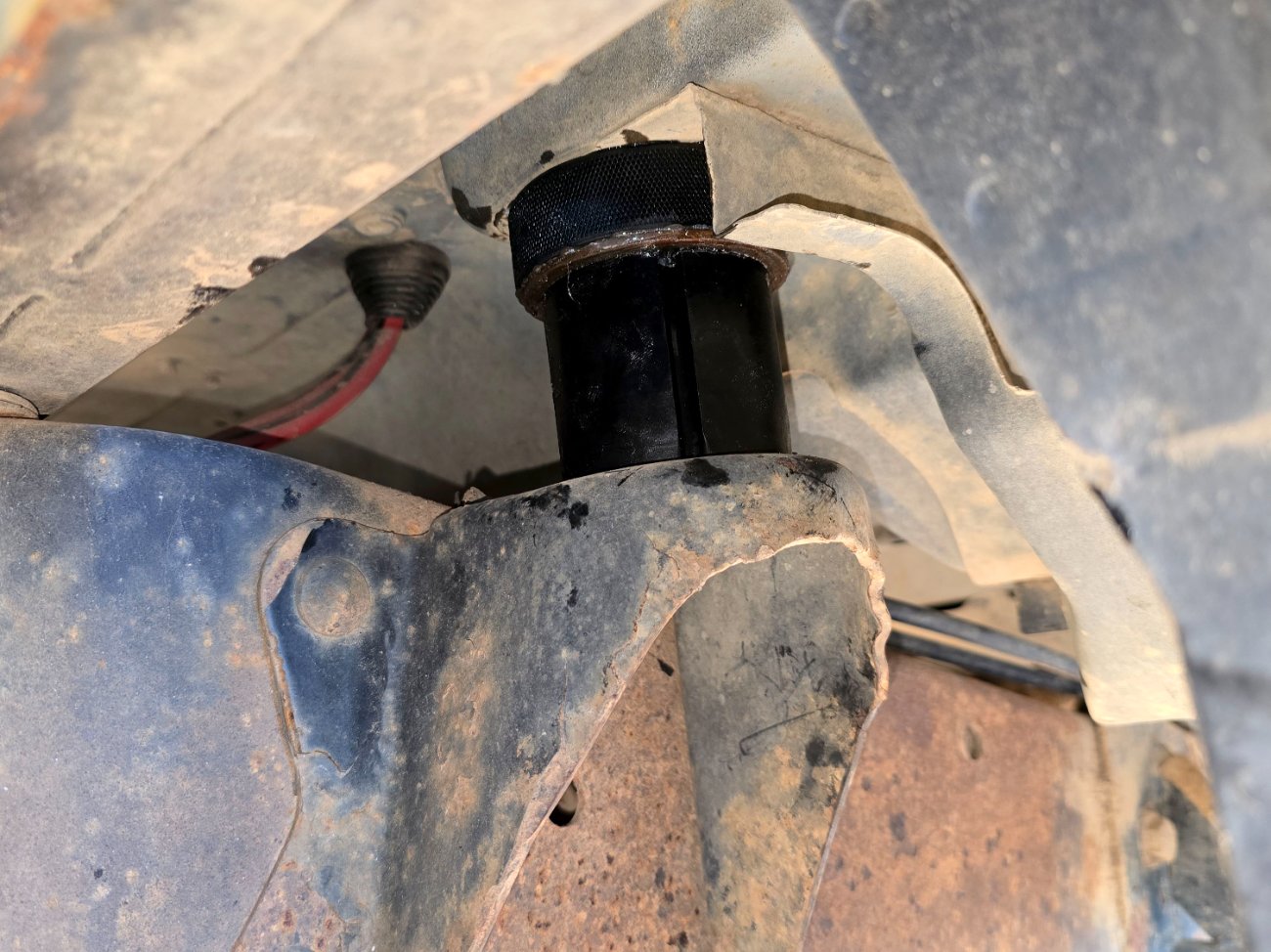

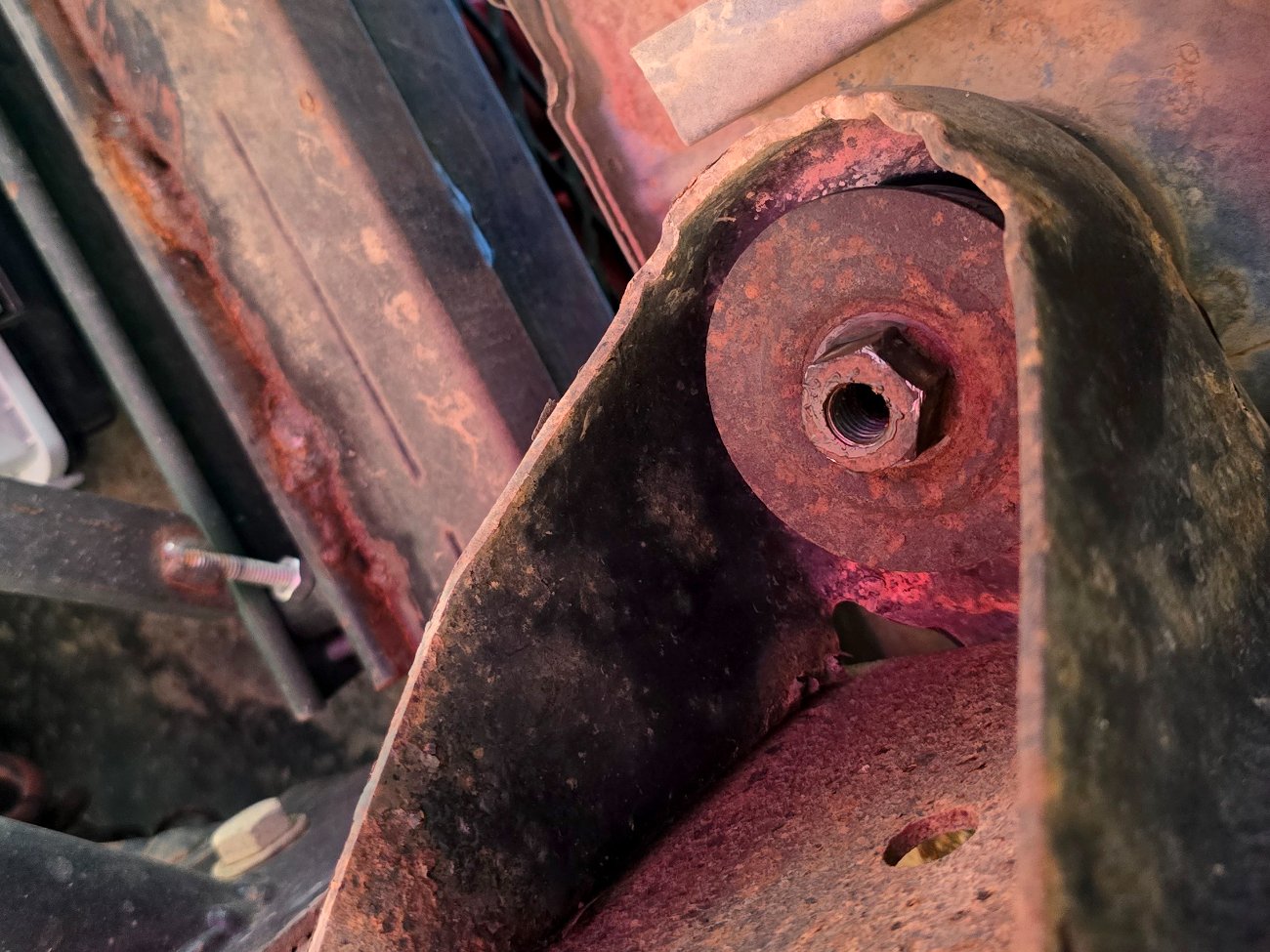

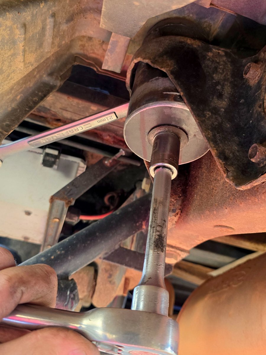

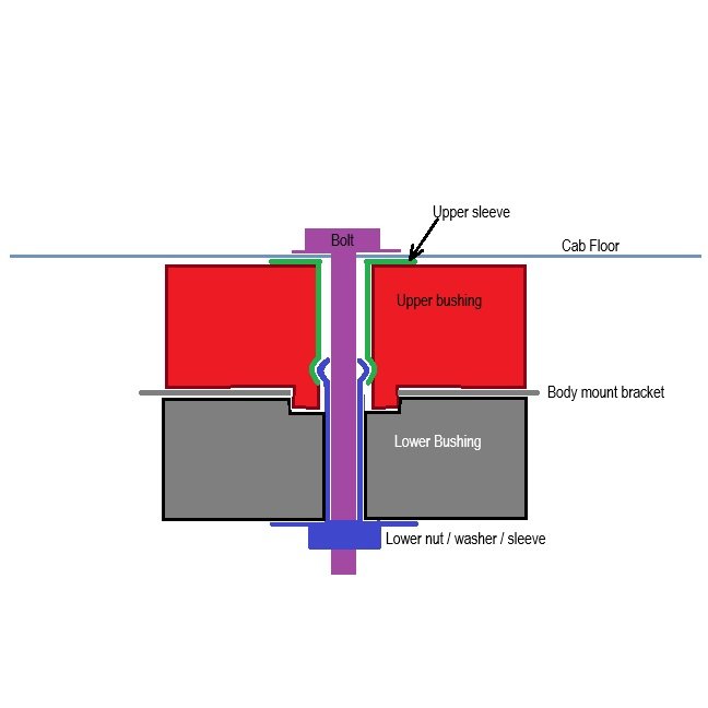

6. For the middle and rear mounts, use the 18mm socket on the bolt head in the cab and the 21mm socket on the nut at the bottom. Loosen and remove the bolts. The nut on the bottom is attached to a washer and a sleeve that is pressed into another sleeve at the top of the bushing assembly. So, it will not fall out easily. See cutaway drawing of the assembly.

Use a 21mm socket on the nut at the bottom
Cab mount bushing diagram

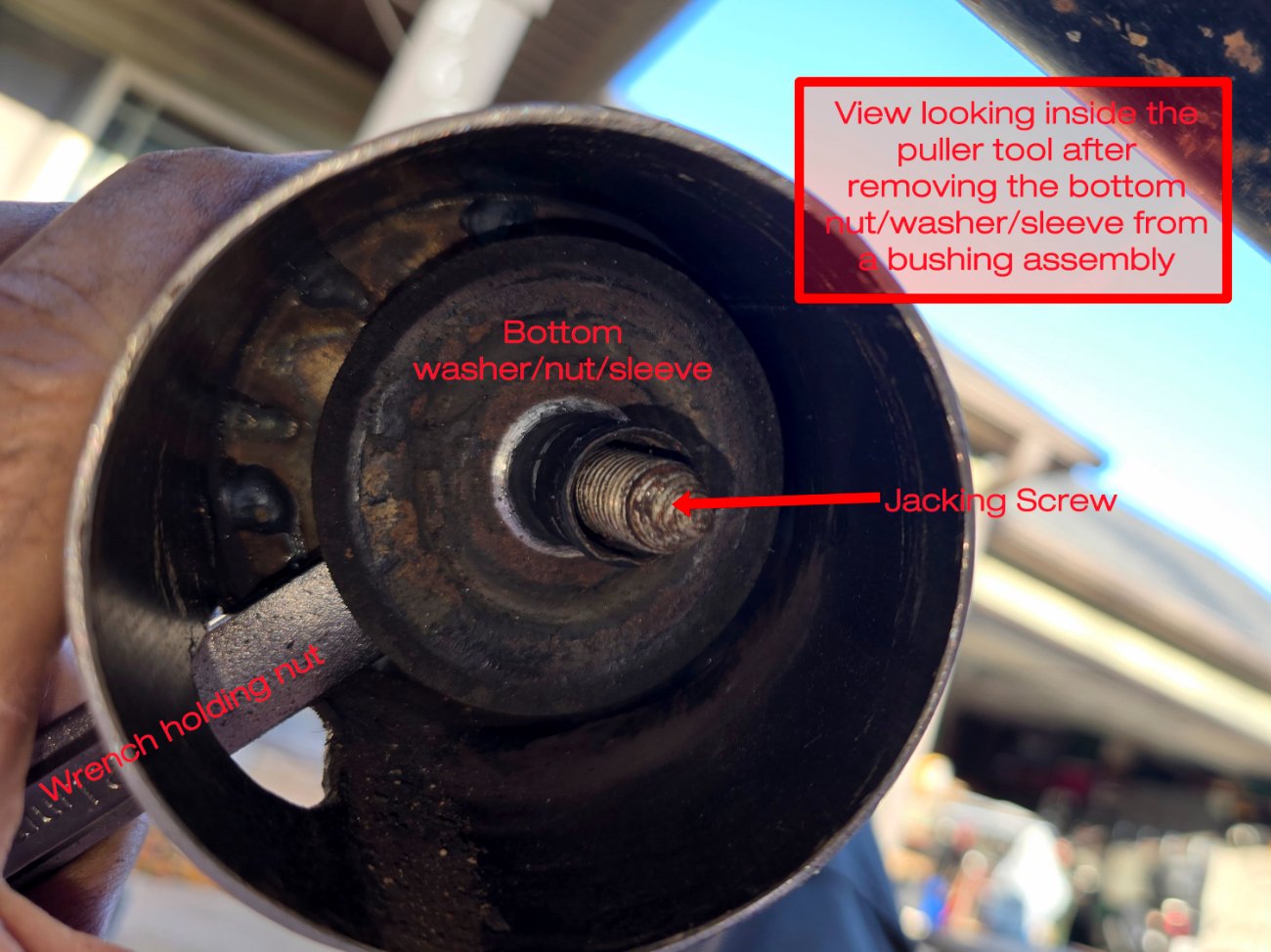

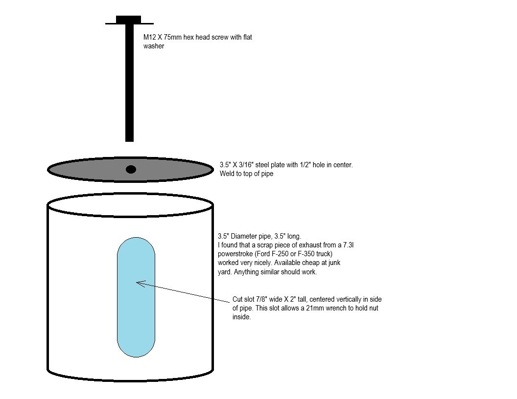

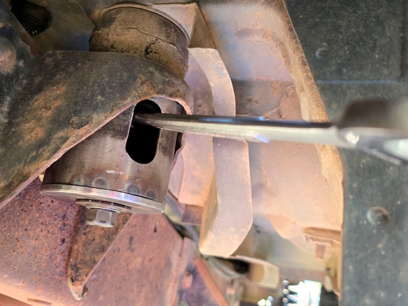

7. Separate the lower and upper portions of the bushing and sleeve assembly from each other. This is a challenge. You may be able to pry them apart with pry bars. I found that to be very difficult and time consuming. I also tried beating them apart with hammer and punch with no success. So, I made a special puller to separate these pieces. Drawing and photos are in the “Special Puller” section at the end of this article.

Separating bushings with a special tool
View looking inside the puller tool after removing the bottom nut, washer, sleeve from a bushing assembly

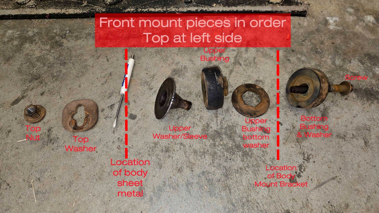

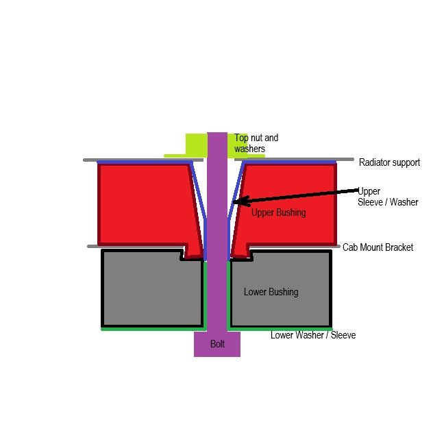

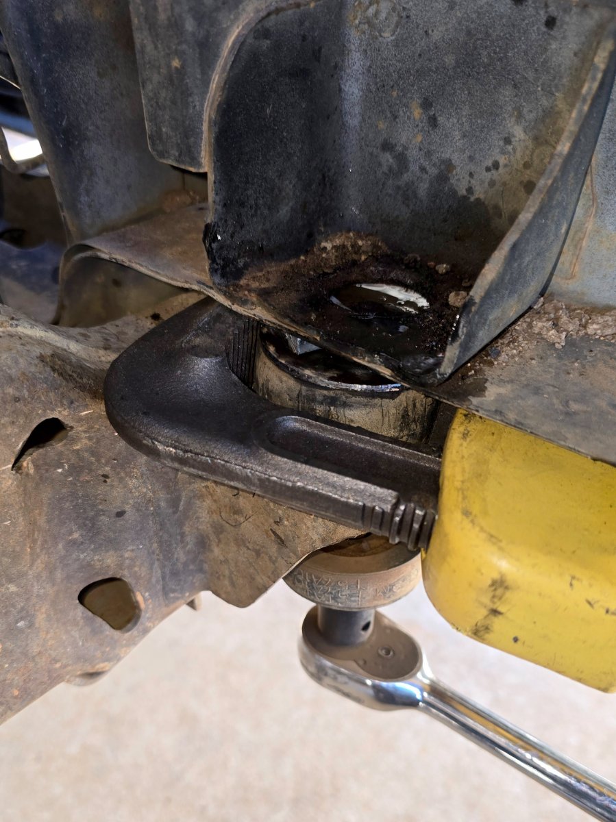

11. Now, comes the “fun” part. I recommend having a friendly helper. It is well worth the price of buying his lunch. Again, there is an upper sleeve and a lower sleeve. This time, the upper sleeve has internal threads. The bolt is threaded into the upper sleeve.
12. Use the pipe wrench to hold the flat washer attached to the upper sleeve. Then use the 15mm socket to remove the bolt. Sounds easy on paper. Doesn’t it?
Bushing diagram
Front mount pieces in order top at left side

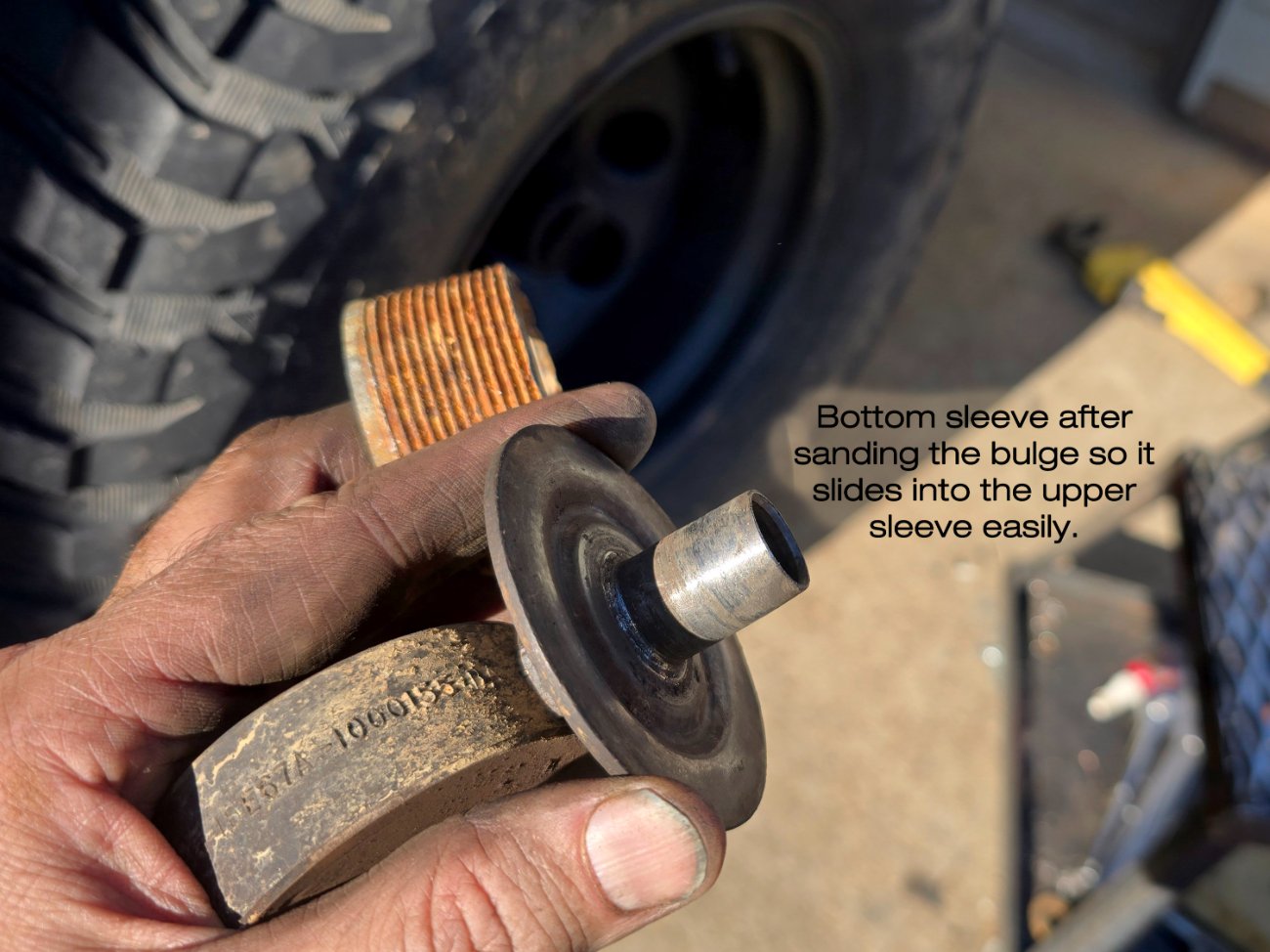

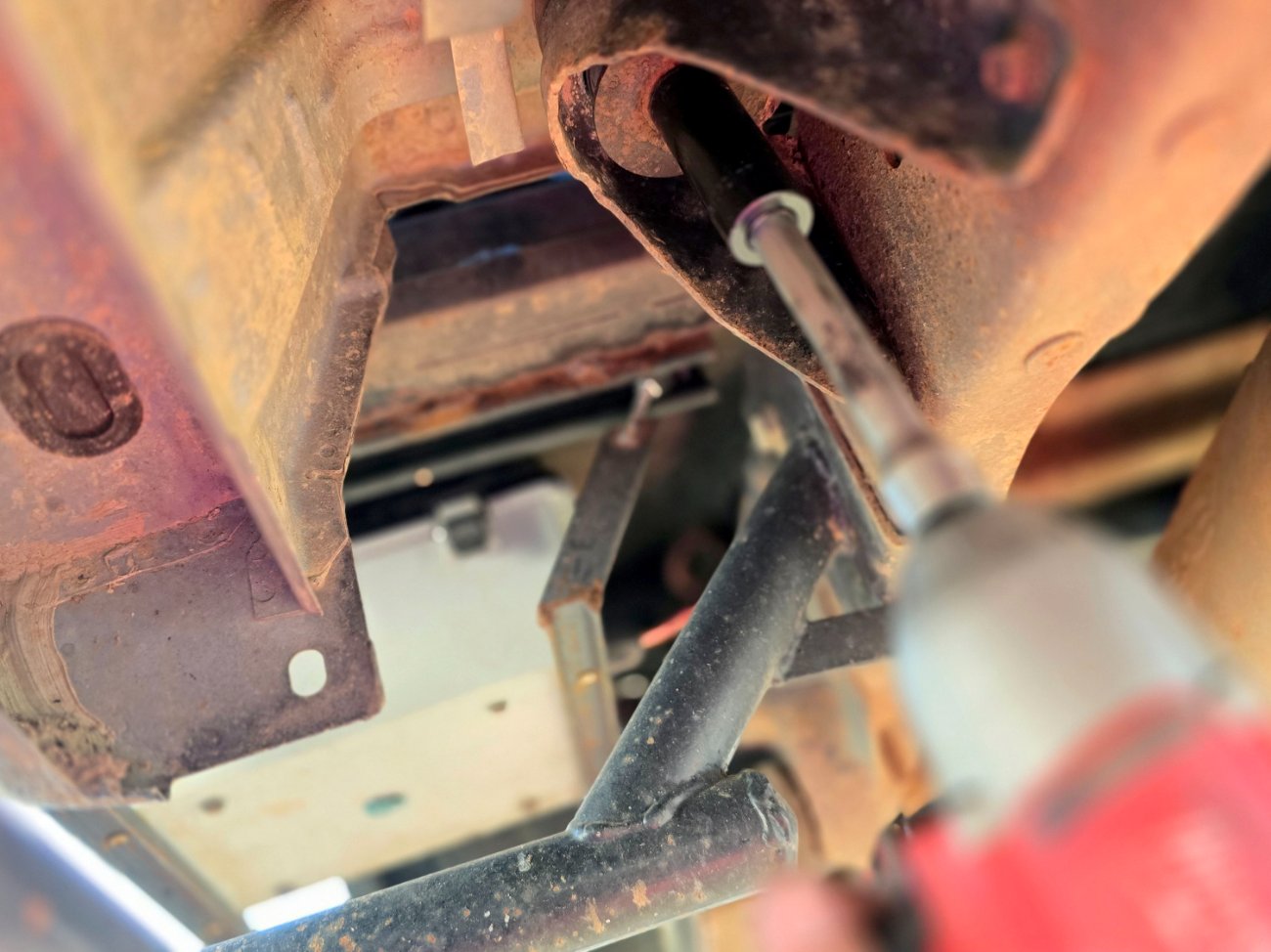

15. To make things easier in the future, I drilled the threads out of the front upper sleeves. I will re-assemble with the bolt entering from the top, just like the middle and rear assemblies. The lower sleeves for the middle and rear seemed to have a bulge that made them fit tightly in their upper sleeves. I sanded that bulge away, so the sleeves slid together easily.
Bottom sleeve after sanding the bulge so it slides into the upper sleeve easily

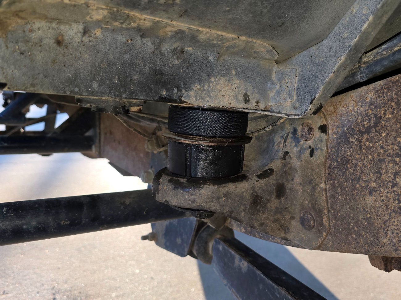

17. Place the upper bushing pieces and their sleeves in their proper locations. In the video linked below, you will note that I am also raising my cab 1” by inserting hockey pucks with ½” holes drilled in their centers. This is the time to install those also. If installing a “lift” like this, longer bolts will be required.
New bushing and spacer
New bushing and spacer installed
Ford Ranger body bushing and spacer
18. Insert the bolts from the top, making sure all original washers are in place. It is easier to do this before you lower the cab onto the bushings because the bushings are currently free to move so you can get them aligned. I also took the liberty of installing my front bolts from the top, instead of the way Ford had them. This required adding a flat washer (12mm or ½”) so the bolt head cannot pull through the slotted washer on top of the body sheet metal.

Cab Mount Puller Tool
Here is a simple sketch of the puller tool I made and showed up above. This is very useful for the middle and rear mounts. You have some leeway on what pipe to make it from. The key details are that the Inside Diameter must be large enough to fit over the bushings and metal washers. The Outside Diameter must be small enough to fit inside the cab mount brackets. The top plate must be large enough that it cannot slip inside the pipe. The plate doesn’t even need to be round, and you don’t have to weld it together. It will just be more cumbersome to use if it is not welded.​
