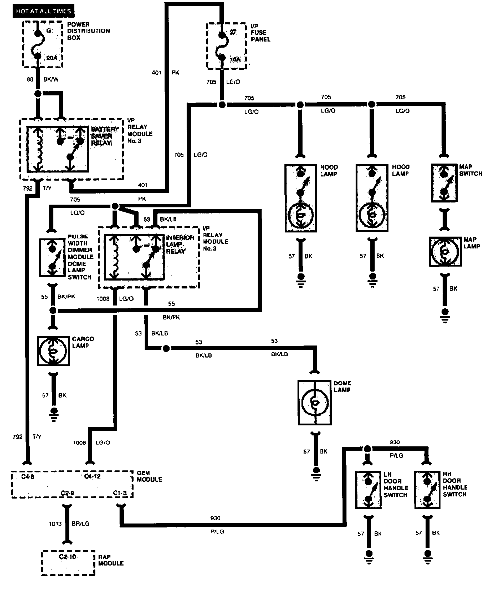

Neat little problem started last night. Opened the driver door to look for a spare 25amp fuse on the fuse panel door. Closed the cab door and dome light stayed on. Waited 10 minutes, stayed on. Turn key to accessories, goes out. Start truck light stays out. No door open light on the dash so seems like the door sensor is working? I checked the switch on the light with truck running it turns on each bulb on off independently like it should. Switch on the dash turns the light on and off when truck is running. As soon as truck is turned off, light comes on and stays on. I have to disconnect battery. Did the door switch malfunction so it’s not opening the circuit?
Thanks for any help
