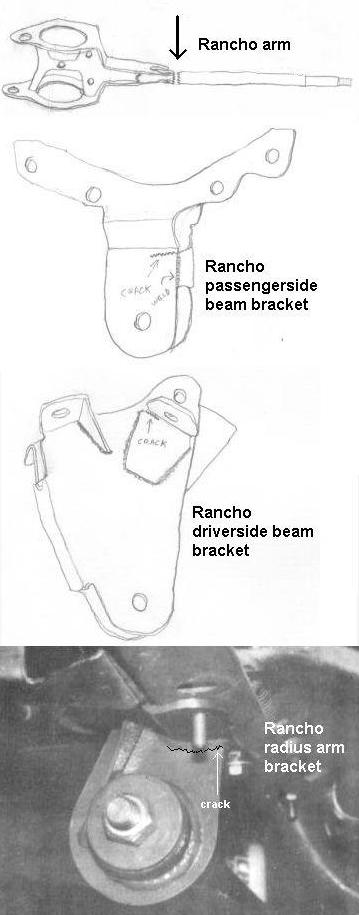

Broken Rancho Suspension Components
The above diagram and photo are from 4x4junkie.  He drew sketches to show where is lift components failed.

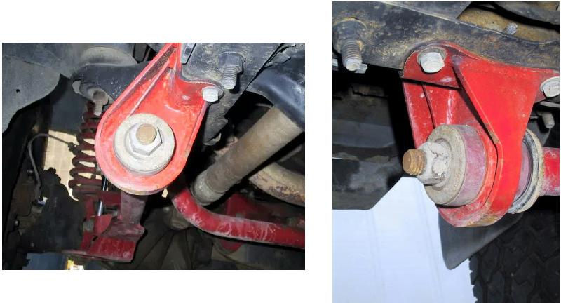

In the photo below you can see where the owner of this Rancho radius arm added a gusset in the area where the crack is in the photo above.

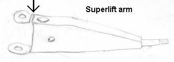

Superlift Suspension
Superlift had issues with the upper mounting tab breaking on their extended radius arms.
diagram of where the Superlift radius arm breaks
