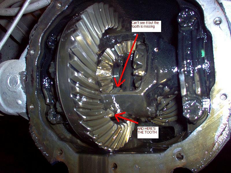

In the photo below is an example of a broken tooth in the spider gears:
broken gear tooth
