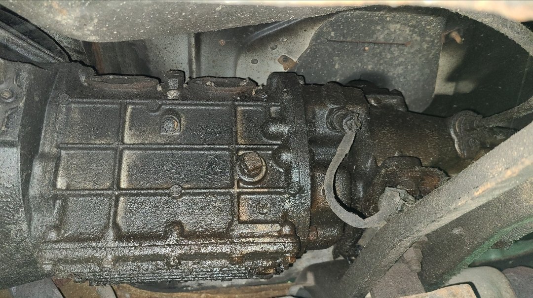

I have a 1984 ford ranger 4 speed 2.0L that I'm planning on getting the clutch replaced on. I can't find any part numbers or tags stating which transmission I have. Does anyone with experience know which one I would have?

Toyo Koygo transmission the aluminum pan is the giveaway.
Thanks! I see on Rock Auto there can be a size options. 8 1/2, 8 7/8, and 9", is there a way to tell, or should I just order the clutch kit after the old one is taken out?
I would order after you get yours out.
To my knowledge theres no real way to tell
