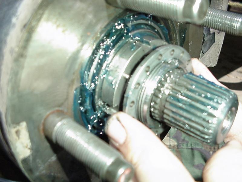

It’s important that you understand how the lock nut and lock washer works. The inner lock nut has a pin that sticks out of it. The inner lock washer has holes drilled in it, and a tab that locks into a groove on the spindle. Sorry about the blurry photo below. Hopefully it’s good enough for you to get a visual understanding. When the lock nut has seated the bearing, the lock washer is slid over the spindle, and the holes in the washer are lined up with the pin in the lock nut. This is supposed to keep the inner nut from coming loose. The problem is that these pins often break off, so the lock nut isn’t locked in place. Over time the lock nuts can come loose causing premature wear of the wheel bearing.
spindle lock washer
