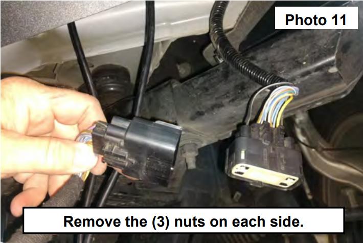

10. Disconnect the adaptive cruise control module plug. See Photo 11.

12. Using a 21mm socket remove the (3) nuts on each side securing the bumper to the vehicle. See Photo 12.

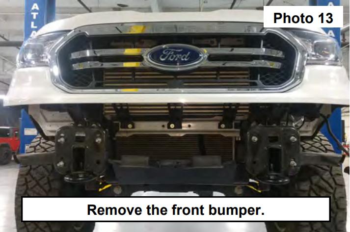

13. Remove the bumper from the vehicle. Set the bumper in a safe place to remove the sensors and wiring. See Photo 13.
