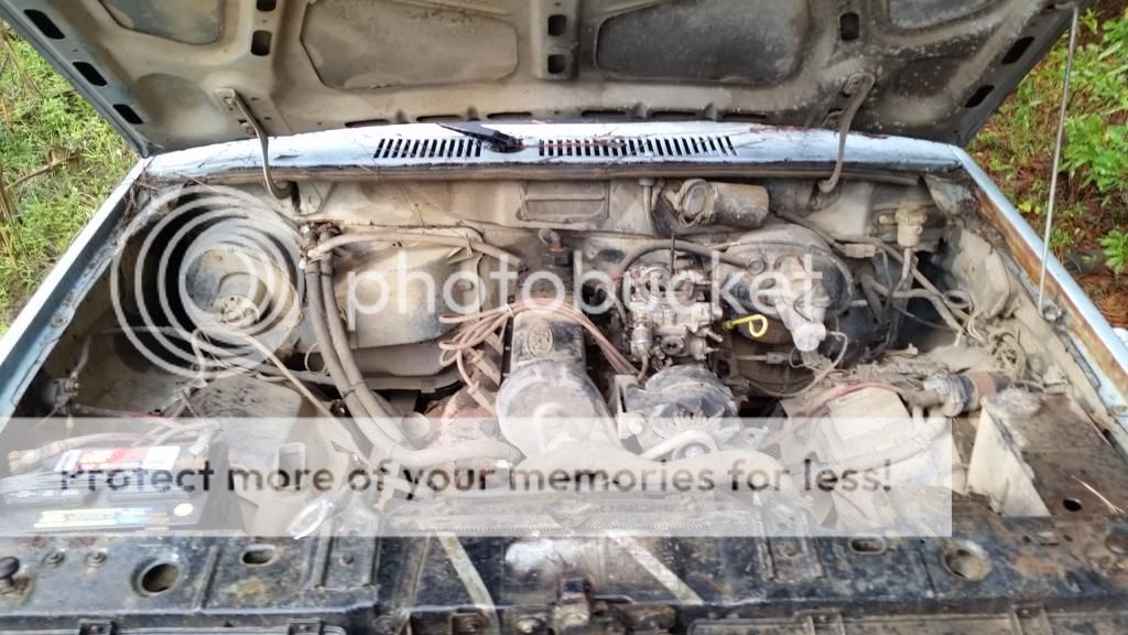

Well there's really no zombies but this thing is back from the dead. 1984 Ranger, parked for 8 years, bought for $35 and coming back to life. I have a few pictures of progress.

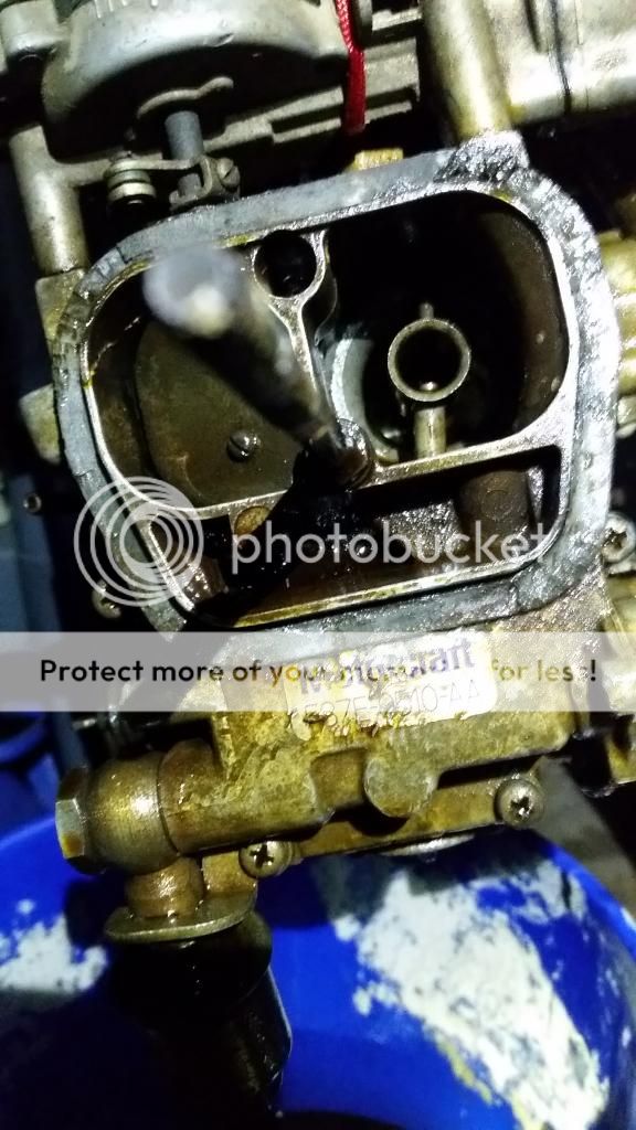

Well after the shoes, we decided to try and wake the zombie, turn over and run with the choke. But as soon as the throttle opened any and choke cut it would die. So I pulled the carburetor to give it a nice cleaning.
Soaking in the bath.

Well another Saturday to work on the zombie. Seems to be about the average amount of time I get to work on it. Cleaned the carburetor jets, float bowl, float needle etc. There was so much crap from sitting for eight years.
Slapped it on, ran gas from a can direct to the pump. Ran good and strong.

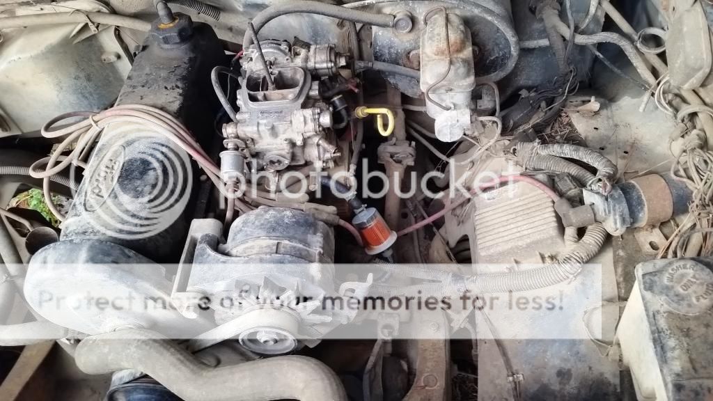

Decided to try from the tank (hoping it's not full of water/snot/crap) put an in line fuel filter between the fuel line and the pump. To help double filter the gas and see what's coming out of the tank. 4 bucks at Walmart.
Put 5 gallons in the tank and crossed my fingers. Yea so, full of snot. Took the carb back off, cleaned it out again. So now the next step is to drop the tank and clean it.

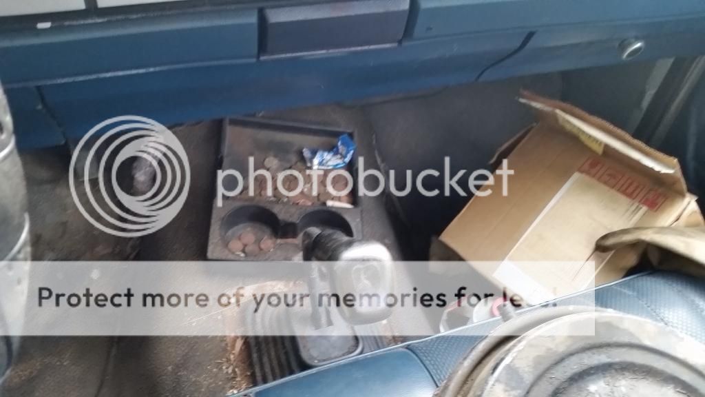

Shifter and enough change to pay for the truck!

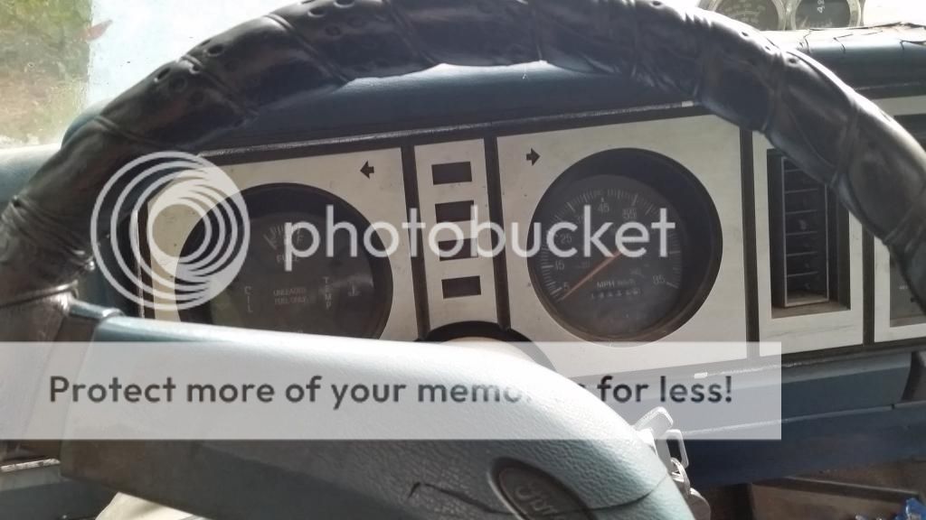

My high tech instrument cluster.

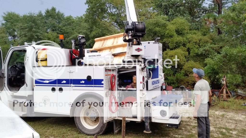

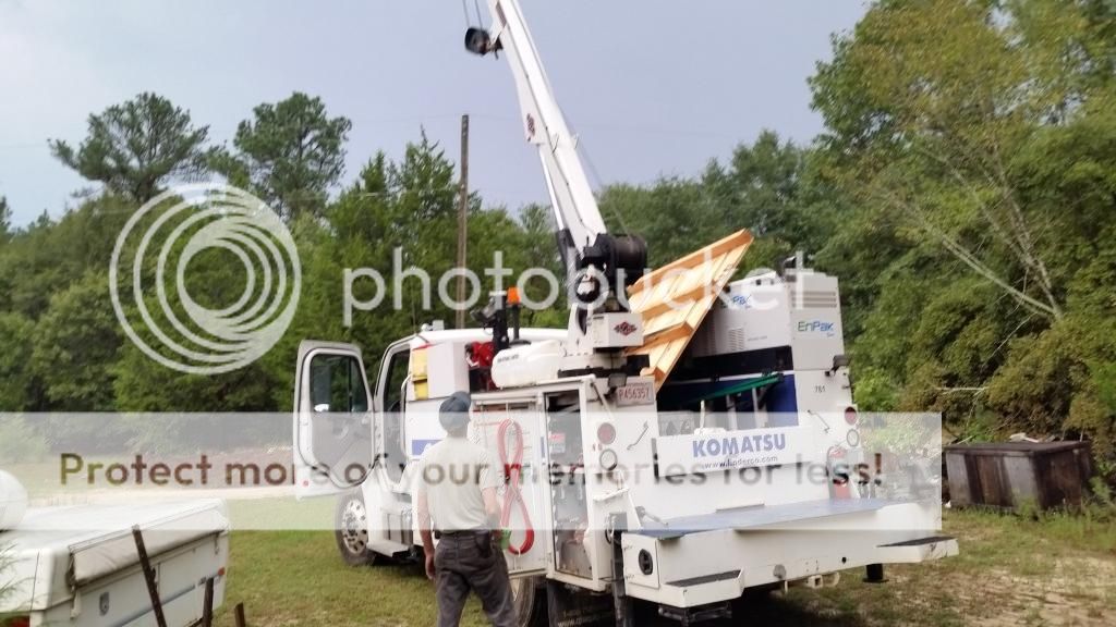

It's always nice to have a thirty ton service truck, every tool imaginable and a master mechanic of 35+ years.
