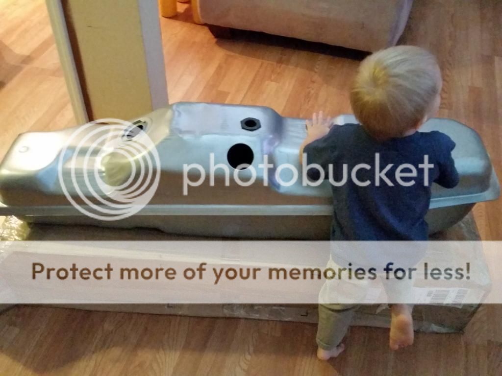

Finally got my tank in after out waiting those crooked ebay guys. Listed for 32 then doubled after a few days, slowly they dropped the price to under 50.

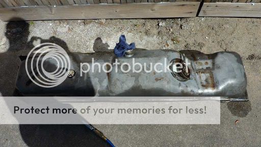

Finally got a chance to get the tank in. Always check your gas tank before you install it!

Yea, so another challenge was the filler tube neck. I'm guessing there's a gasket or something these aftermarket tanks need? I don't care screw it, brazed on the one from the factory tank!
Done, next time I run into one of these "challenges " I'm gonna bring out the torch first thing! !:icon_welder:

The bed and frame flex when going done the road. Having the filler neck brazed to the tank maybe a problem. It may also be harder to get the bed to line up with the filler neck with out being about to move the neck around for alignment. Ford and Doorman sell replacement filler neck seals.
Not my photo just used as reference. Where the blue rags are stuffed into a "neck" of sorts is what I cut off the old tank and brazed onto the new tank. Then the filler neck itself slides into that 2 inch neck. Hope that helps explain. More or less factory so there should be no issues. :D
where did you get your tank from? just wondering why you didn't go for the tank with a rubber filler neck...
