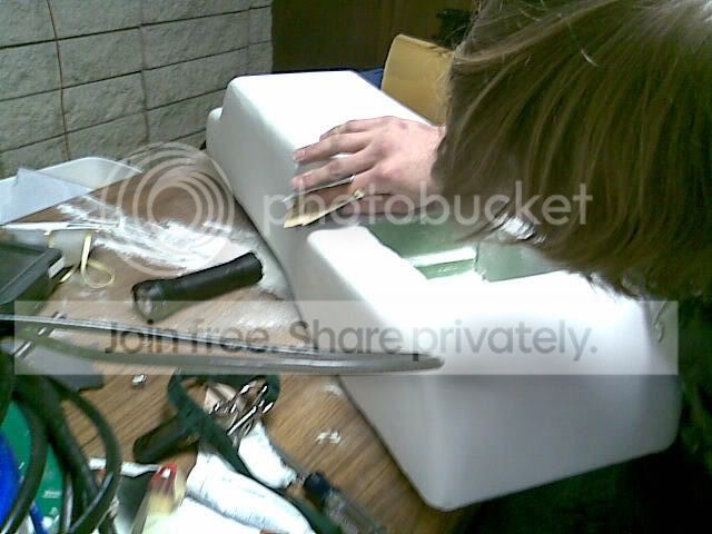

My friends dad's helping with the glaze coat after body fill:

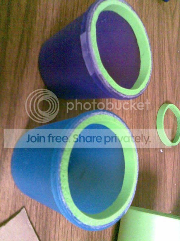

cupholders, trimmed them down from some in the kitchen cabinet (sorry momma) and used a piece from a beer cuzie:
