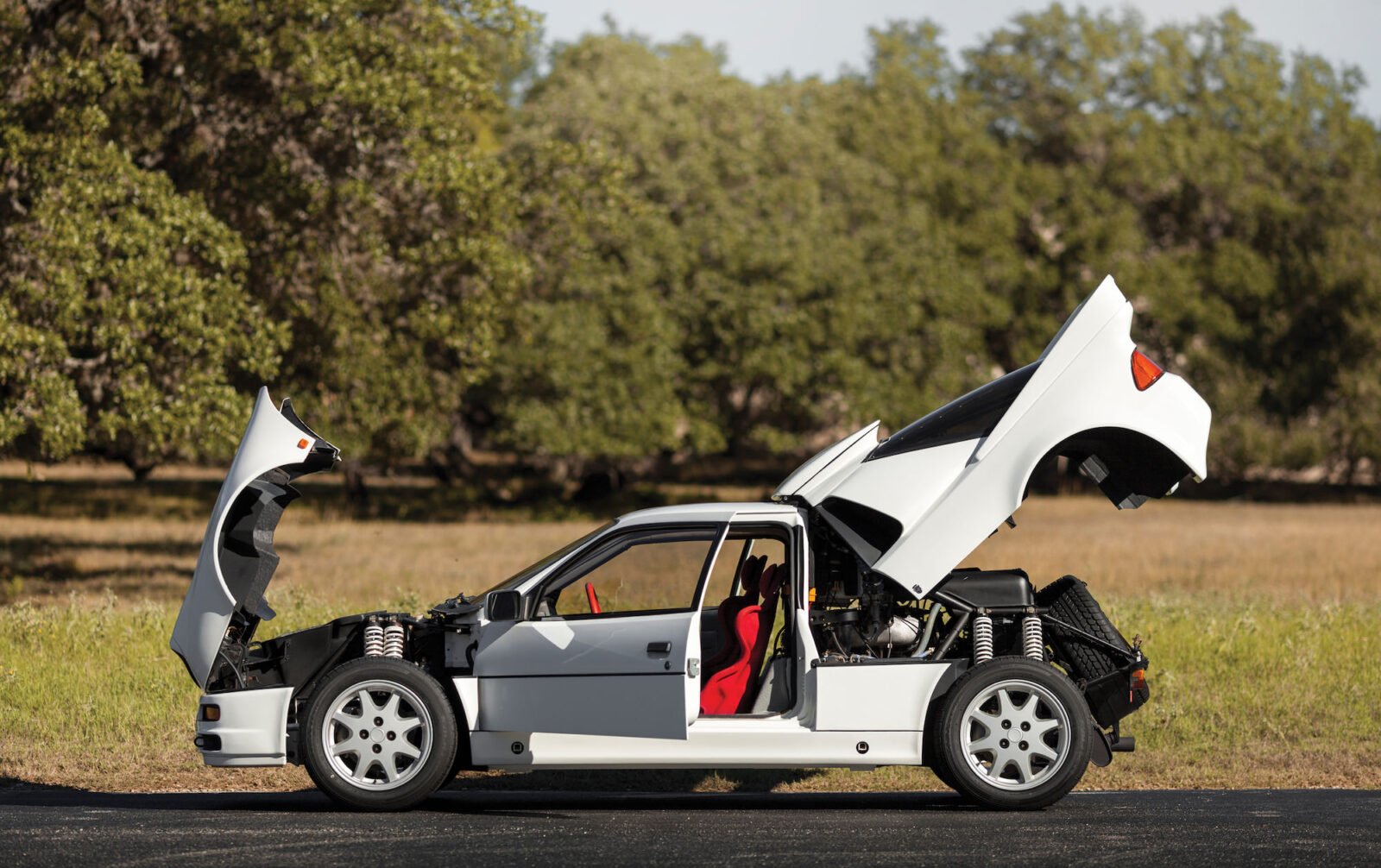

This is what I would like to do for the rear. I'll have to see how low I can get the shell first though.
That's way more refined then my simple solution... and way cooler too!

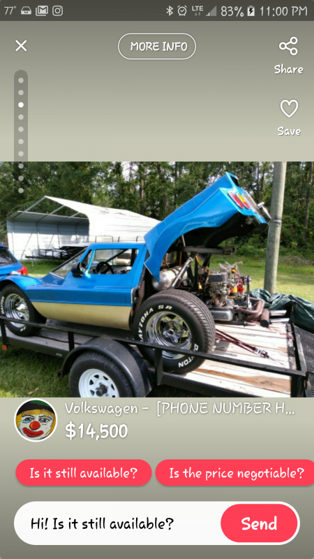

i just saw it on Letgoand it was vaguely familiar to me.
