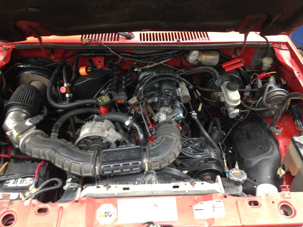

Alright boys, a few months ago I finished wiring up my 4.0 swap and I promised myself that I would write the article that I wished I had at the time. There’s a lot of great articles on the mechanical aspects of the swap, so this is just going to be all about the final step- wiring. The first generation dash is one of my favorite things about my Ranger, so I did not want to do a dash swap! I noticed a lot of people have felt the same, but getting the 4.0 to work with the older dash is where a lot of people get stuck. Hopefully this will help other poor souls like me get their Ranger on the road and enjoy their new 4.0 as soon as possible! I’m by no means a wiring expert so if anyone can suggest improvements or changes to my method that would be great. I also want to thank Adsm08 for taking the time to help me with the final troubleshooting that would have otherwise taken me a long ass time.

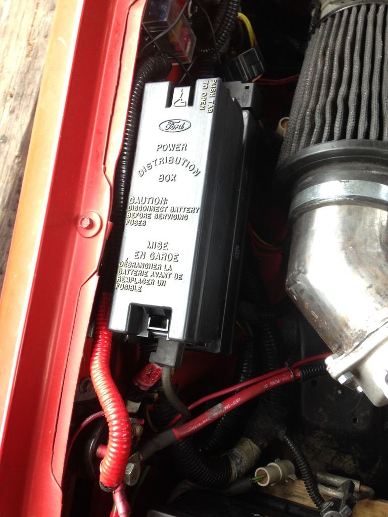

Mount the distribution box to the side of your engine bay. Connect the large black cable on the distribution box to the positive side of your starter solenoid. Connect the 4-pin connector on the distribution box to the 4-pin connector on the new harness. This plug gives power to your fuel pump and ECC relays. There should be a spot for the relays to click in under the box, neat!
Wiring Write Up for 2.9 to 4.0 Swap with Original First Gen Dash

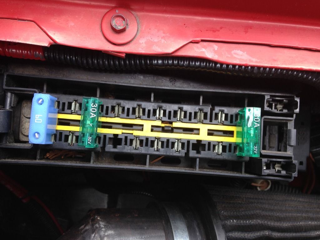

Remove all the fuses from the power distribution box, except a 30A fuse in slot 1, a 30A fuse in 8, and a 60A fuse in slot 10. Congrats, you now have power from your battery to your relays! You can also use the other wires and fuse slots as an easy way to wire in aftermarket accessories. Hell yeah.

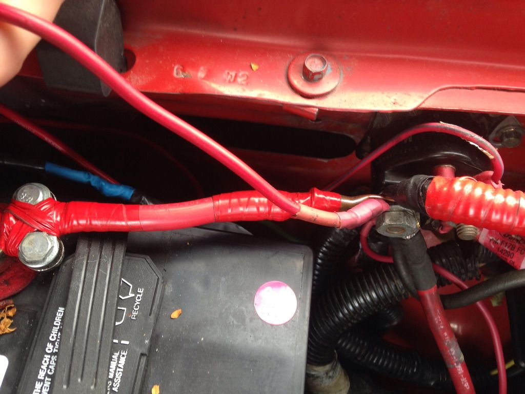

Step 3: Alternator Wires and Power to Ignition

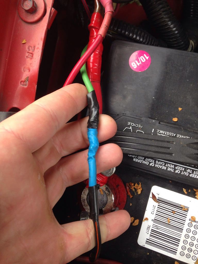

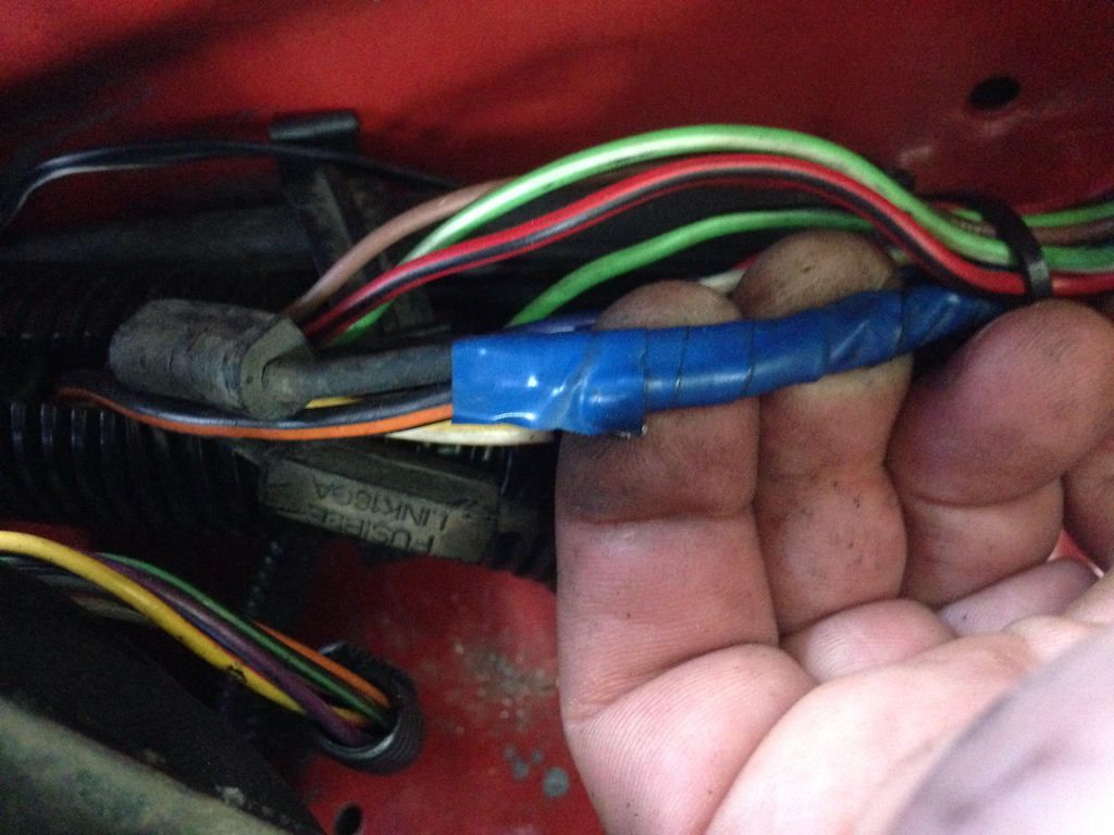

Now you should be able to hook up the 4.0 alternator as it was in the donor vehicle. Remove the thick orange/black wire from the positive side of the starter solenoid and splice it into the thicker light green wire in the cluster of wires coming from the power distribution box. This will provide power to your ignition.

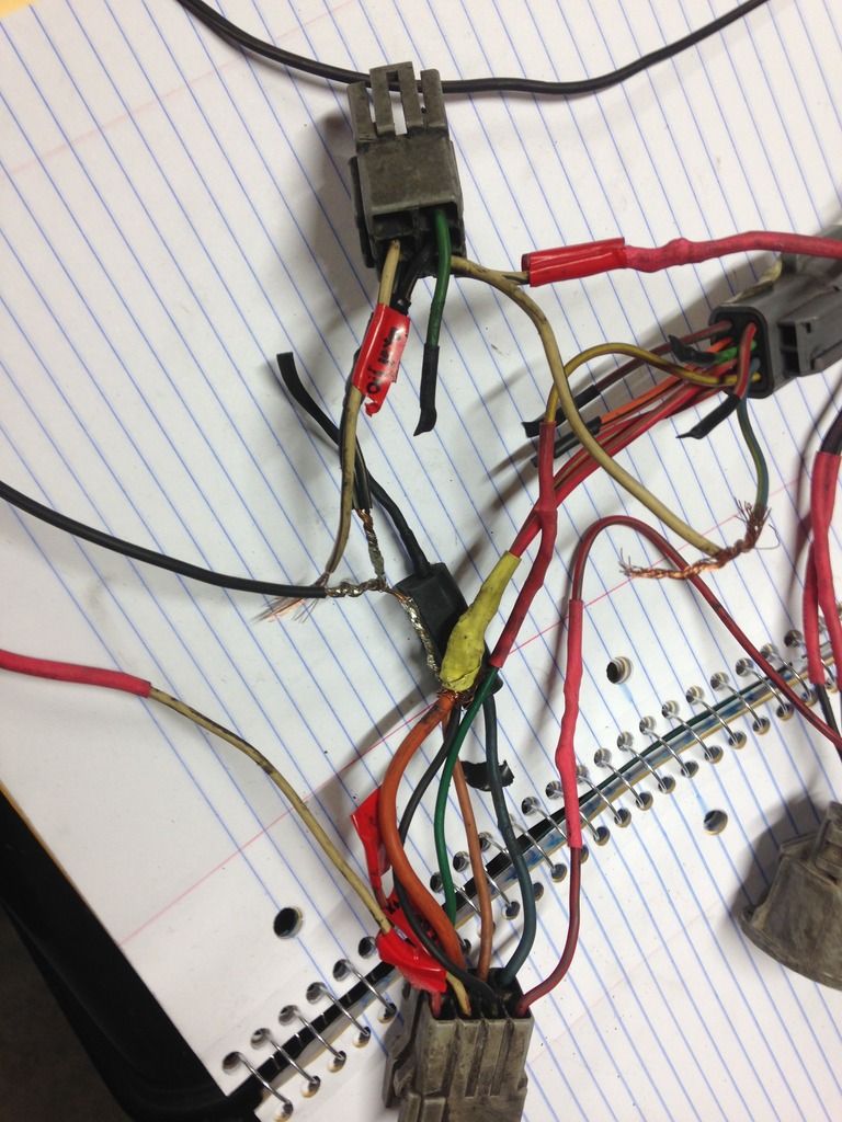

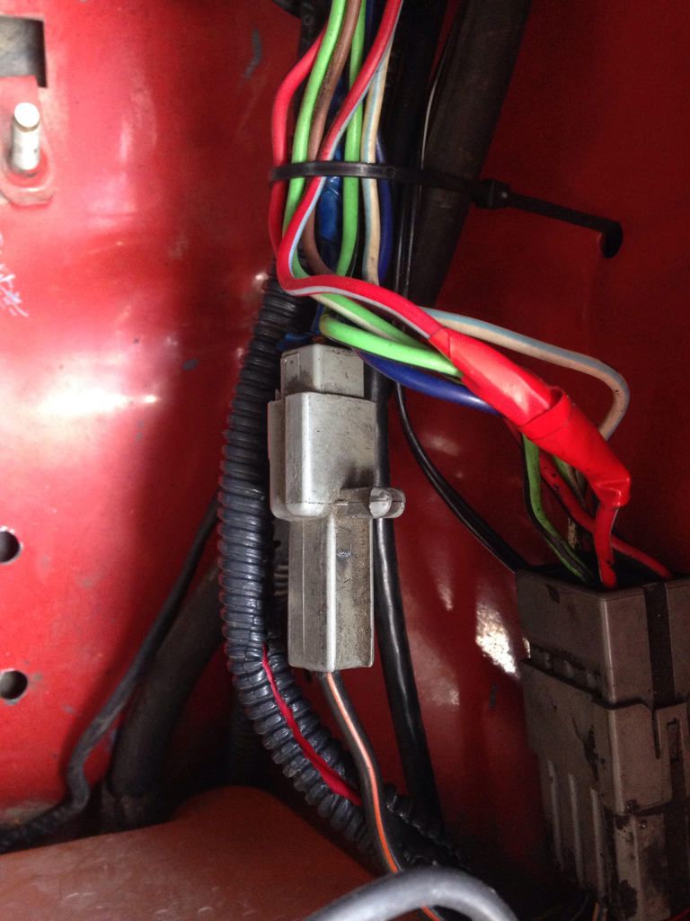

The previous owner of my truck fiddled with the wires alternator wires and instead spliced the 4.0 alternator into the 2.9 alternator harness. I don't recommend this route but here's how I wired it up if it pertains to anyone. If not, skip to step 4. Follow the black/orange from the alternator through the original harness to the drivers side wheel well. At this point, the orange/black wire and a wire with a fusible link are spliced together (not sure if by factory or previous owner) and meet at a small connecter where a orange/black wire comes out of:Wiring Write Up for 2.9 to 4.0 Swap with Original First Gen Dash
Trace the orange/black wire around the front of the engine bay to the power distribution box, and splice it to the large green wire in the cluster of wires coming from the power distribution box: This will give fused power to your ignition.

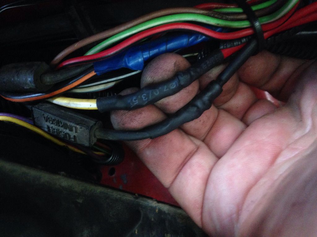

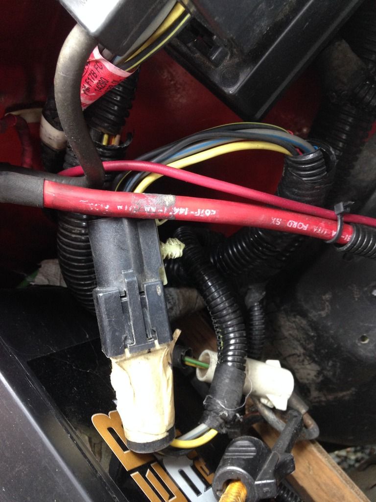

Now go back to the same area and find a large yellow/white wire and another fusible link. Splice them together if they aren’t already and run a heavy gauge wire from them to the positive side of the starter solenoid. Somewhere along this wire you should put an inline fuse or fusible link. Ideally you could use a wire coming from the distribution box for this too and just put a another fuse in the box, but I wasn’t comfortable with how small the rest of those wires are.

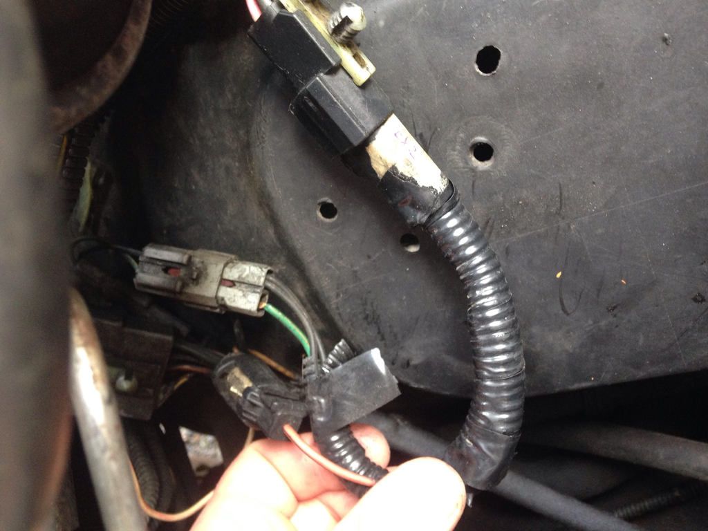

Step 4: Fuel Inertia Switch
The fuel inertia switch is located under the passenger wheel well and is used to shut off the fuel flow in the event of an accident. The plug that goes to this switch is on the end of the harness near where it connects to the computer. There are 3 options to get it working with this swap:
Simply remove the old inertia switch and replace it with one from the donor vehicle, and plug it right in. Make sure to press the button on top to reset the switch in case it got tripped in the process.
Use the old inertia switch by directly splicing the wires from your new harness to it. Pink/Black goes to Pink/Black, and Dark Green/Yellow goes to Orange/Light blue.
Remove the inertia switch connector off the end of the 4.0 harness and splice the 2 wires together. WARNING: in the event of a crash, your fuel pump will not turn off.

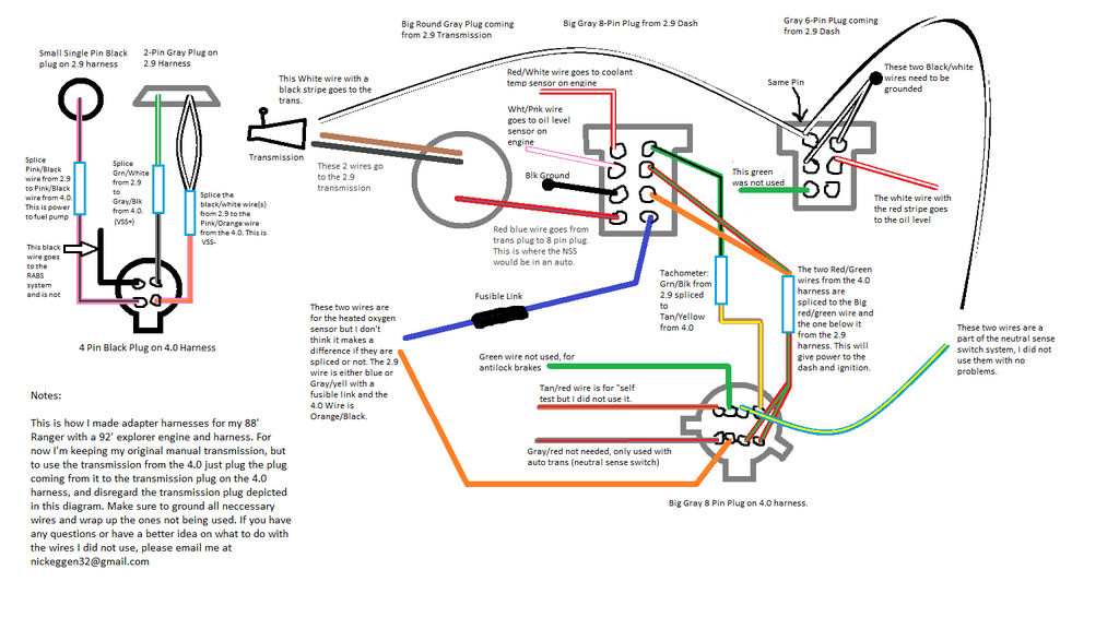

We will now make 2 adapter harnesses that will connect the 4.0 harness to the dash, ignition, gauges, fuel pump, and other components. You will use the plugs you cut off the donor vehicle, as well as plugs cut off the old harness to bridge the two. Here is the wiring diagram I made that pretty much shows how everything goes, but I will also explain them in more detail:

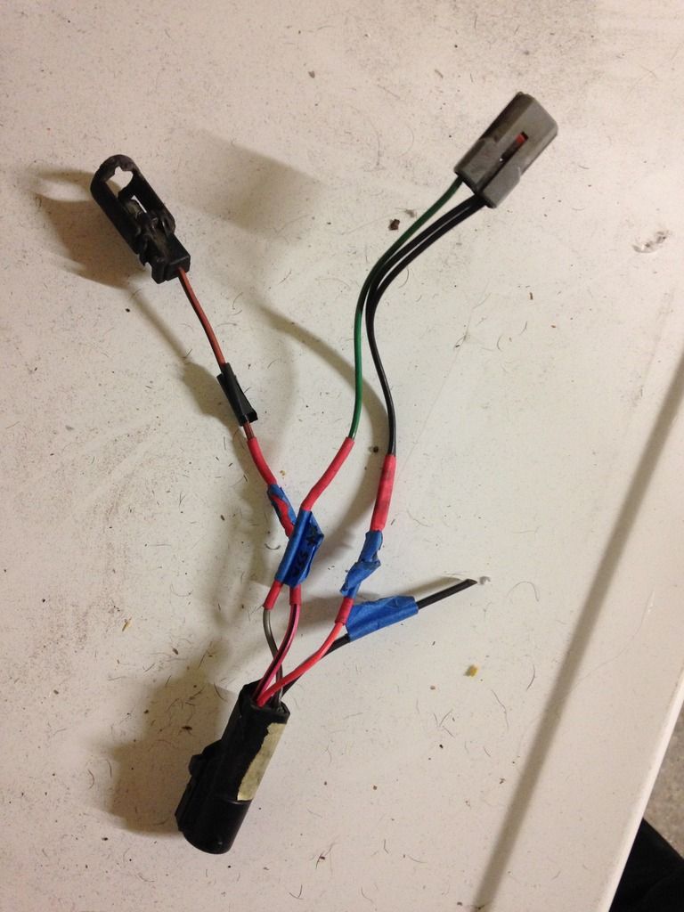

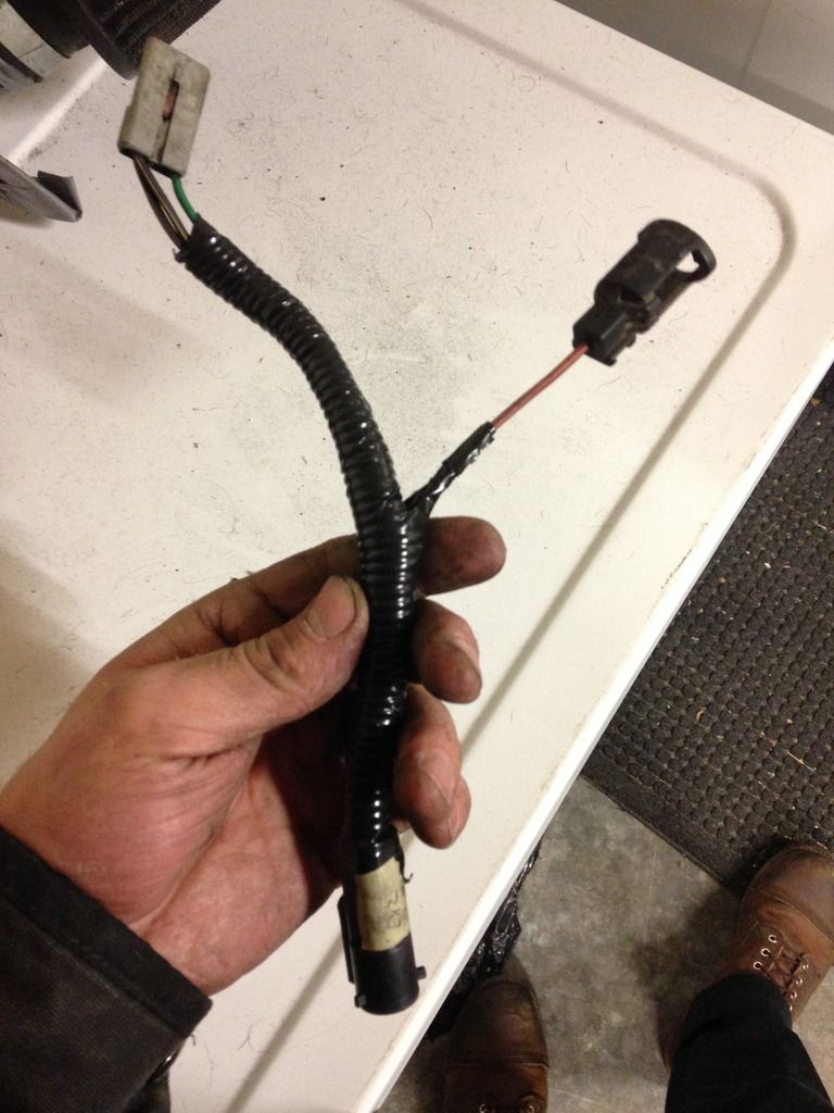

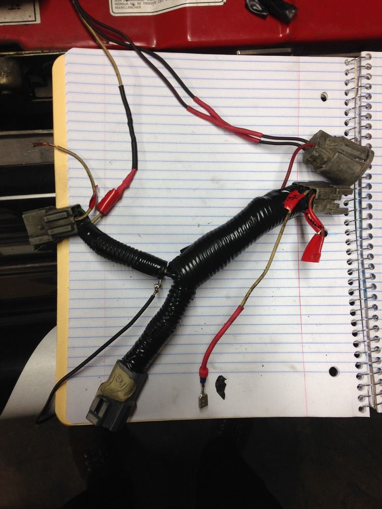

The first, smaller adapter harness will connect one plug from the 4.0 harness to two plugs from the original truck. It gives power to the fuel pump and gets your speedometer working

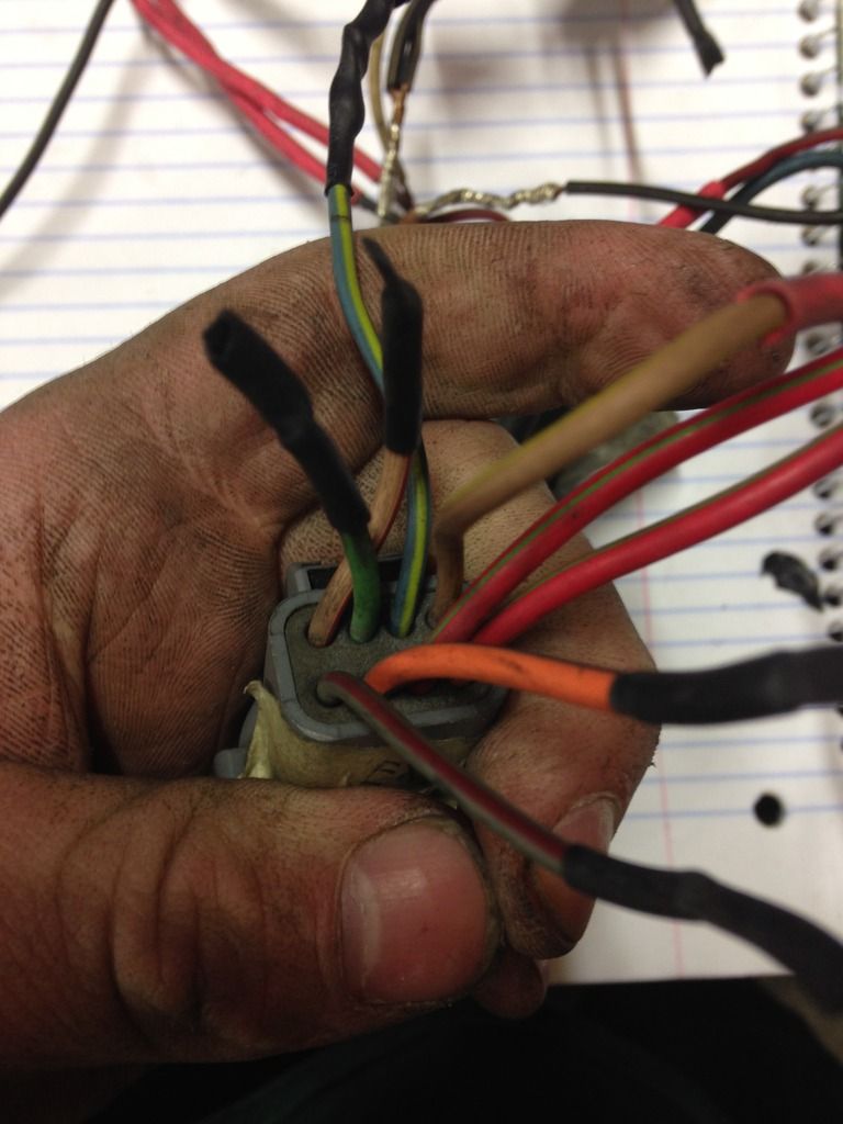

The second adapter harness is bigger, and bridges 3 plugs coming from the original vehicle (one from transmission, 2 from dash) to the big 8 pin plug from the 4.0 harness. Not all wires are used, so make sure to trim and tape the ends of all unused wires. All of the ground wires I spliced together to make one big ground wire.
In the end, you will have something that looks like this. The plug on the top goes to the 4.0 harness, the 3 plugs on the bottom go to the plugs from the original truck. The three wires on the top right are going to the transmission. The black wire on the top left is my ground, and the two wires on the bottom left are going to the oil sensor and the coolant temp sensor. I just spliced them into the single wires coming from those sensors. The coolant temp sensor wire on my 4.0 was Gray/Blue.

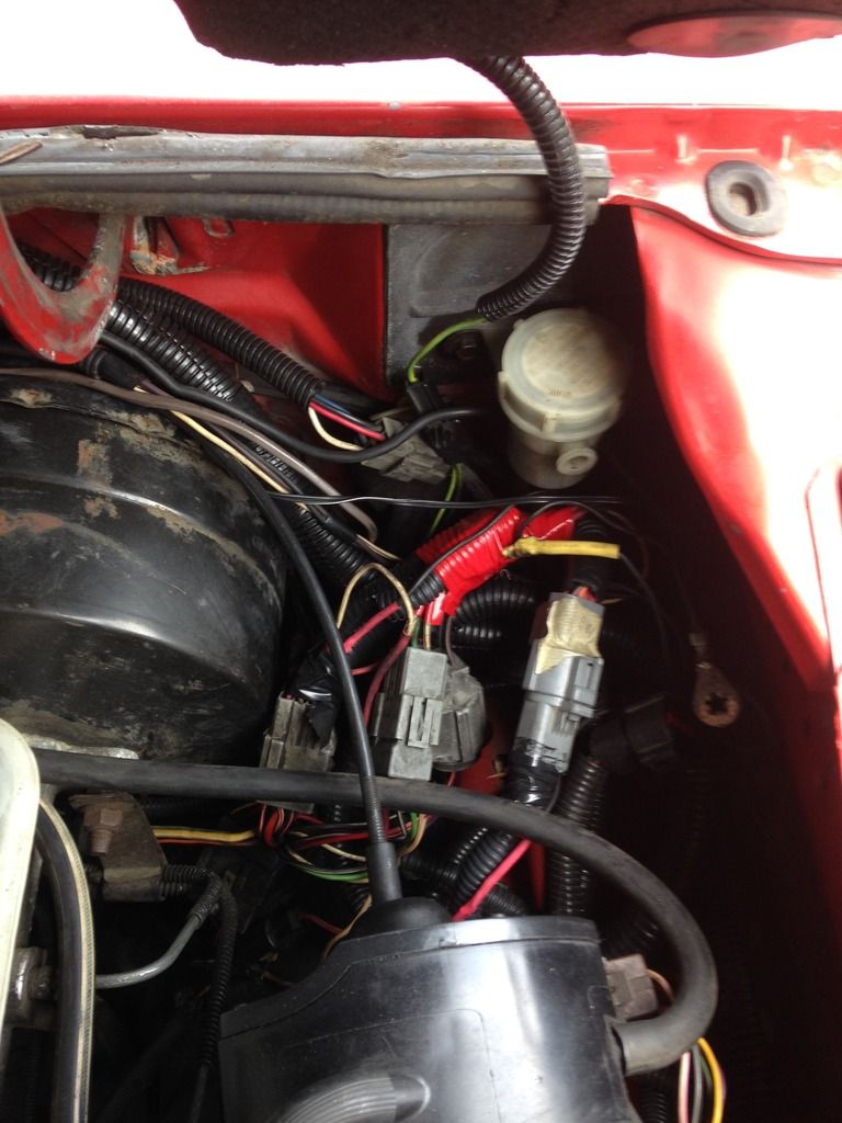

Install both your adapter Harnesses, making sure to ground the ground wire coming from the large adapter and hook up the coolant/oil sensor wires. Coolant/temp wires are not needed to start engine but are nice to have.
Other grounds: ground anything else that needs it. If I remember correctly there should be a wire near the computer that needs to be grounded, a 2 pin plug with black wires near the power distribution box that needs to be grounded, and another one somewhere in between
