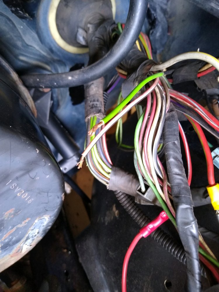

The harness that is connected to the ECM and that runs across the engine to the plugs at the firewall has been butchered and repaired over the years. I am trying to figure out a couple of wires on the harness. There are some wires that do not match the other wires that they should plug into. I need some help finding out what they connect to. Here are some pictures. There is also a picture of the plug so you can see which set of wires I am talking about. Thanks.

Trying to sort that out is going to be tough without an EVTM (Electrical and Vacuum Troubleshooting Manual- Ford's wiring book) for your year model.
Which gray 8-pin connector is that? Any idea where it plugs to, or any wire colors that were in it originally?
Also, that type of gray 8-pin connector is used in multiple locations. You can't rule out that in the past a differently-wire-colored connector was cut out of a donor, and used to replace a destroyed original 8-pin connector.
You NEED a 1988 Ranger/Bronco II EVTM
$42 here: https://www.crossroadbookstore.com/product/sku/60996
Here's the thing, Ford used EXACTLY the same wire colors in multiple systems
There are alot of color combinations, but wire costs money, so they repeat color combos, since its a separate system, and not at all confusing to a Ford Tech with an EVTM, lol
So a pink/black wire could be engine system, lighting system, fuel system, seat belt system and/or ALL 4
EVTM has the locations of connectors and sub-systems, includes all options as well
And wire colors for each system, and where each wire can be found for each system

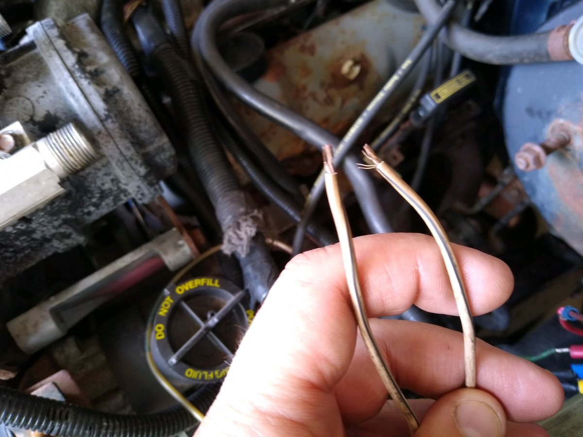

I know it has been a while but school started so I haven't been in the garage as much. I have been trying to figure this wiring out and I know it is probably something stupid because it all worked before I took the truck apart but I can't figure out what it is. I can hear the relays clicking when I turn the key on and off. I have no lights inside or outside. Nothing is working inside, no blower motor dash lights, nothing. When I try to turn the starter over I have nothing there either. I checked all of the grounds and all of the connections are correct except the ones I have pictured. I don't know where those wires go and I don't have anything that tells me where they go. I bought the book that was suggested and that hasn't helped. Can anyone help me with this?
68508
One wire is green and the other is light purple with a black stripe. They come from the firewall.
68509
These two wires are pink with black stripes. They are coming from a harness off the engine.
68510
This wire is purple and comes from the same place as the pink with black striped wires.

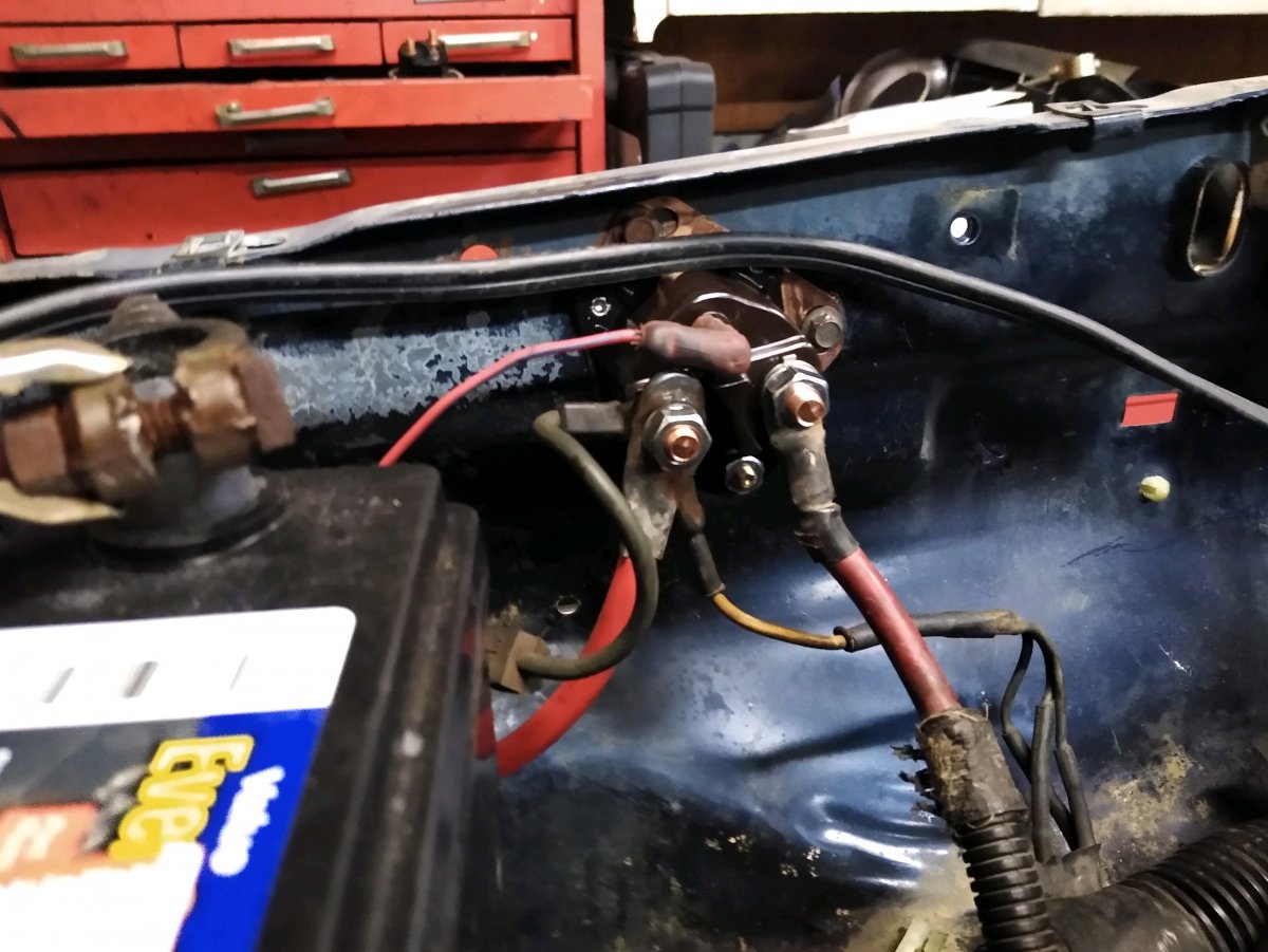

This is how I have the lights and battery hooked to the starter solenoid. I checked the starter and I checked all connections. Everything is where it should be I think. The big red wire is to the battery. The other big wire with the plastic ribbed cover goes to the starter.
What the heck am I doing wrong/forgetting? I can take more pictures if you need them. I really need help with this guys. I am at a stand still on my project until I get this figured out. Thanks!
Looks like you are missing a few wires on Starter Relay(solenoid)
The big red cables are correct
And the one black and one yellow wire are on correct post(battery positive), this post is where ALL the 12volt power for the whole vehicle comes from
The alternator is hooked to this post as well, via the black or yellow wire, assuming you don't see any loose wires with eyelets on them
The Yellow one looks like it splits off to 3 wires which is correct, but you will need to open up the harness to makes sure the fusible links hooked to that yellow wire are OK
The ignition switch gets its 12v from either the yellow or black wire, usually the yellow wire
Black one should also split off to at least 2 wires as well, does it?

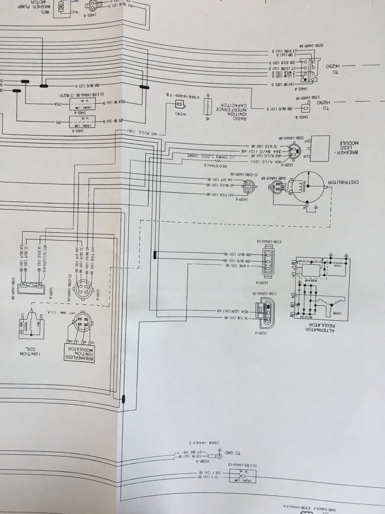

I'll try to get up today to a 1988 Ranger I got the motor and relay plugs and ALT harness with wires off of. I don't think that side of the harness has been cut. If not , I will follow that harness from the engine and remove it with plugs. Where it goes into the harness inside the cab will have to be cut. In one picture your thumb is pointing to a harness . It has had end connectors put on it. Follow it to see if that is going to the Altenator? That would be the 12 volt supply to inside the cab and charging system.

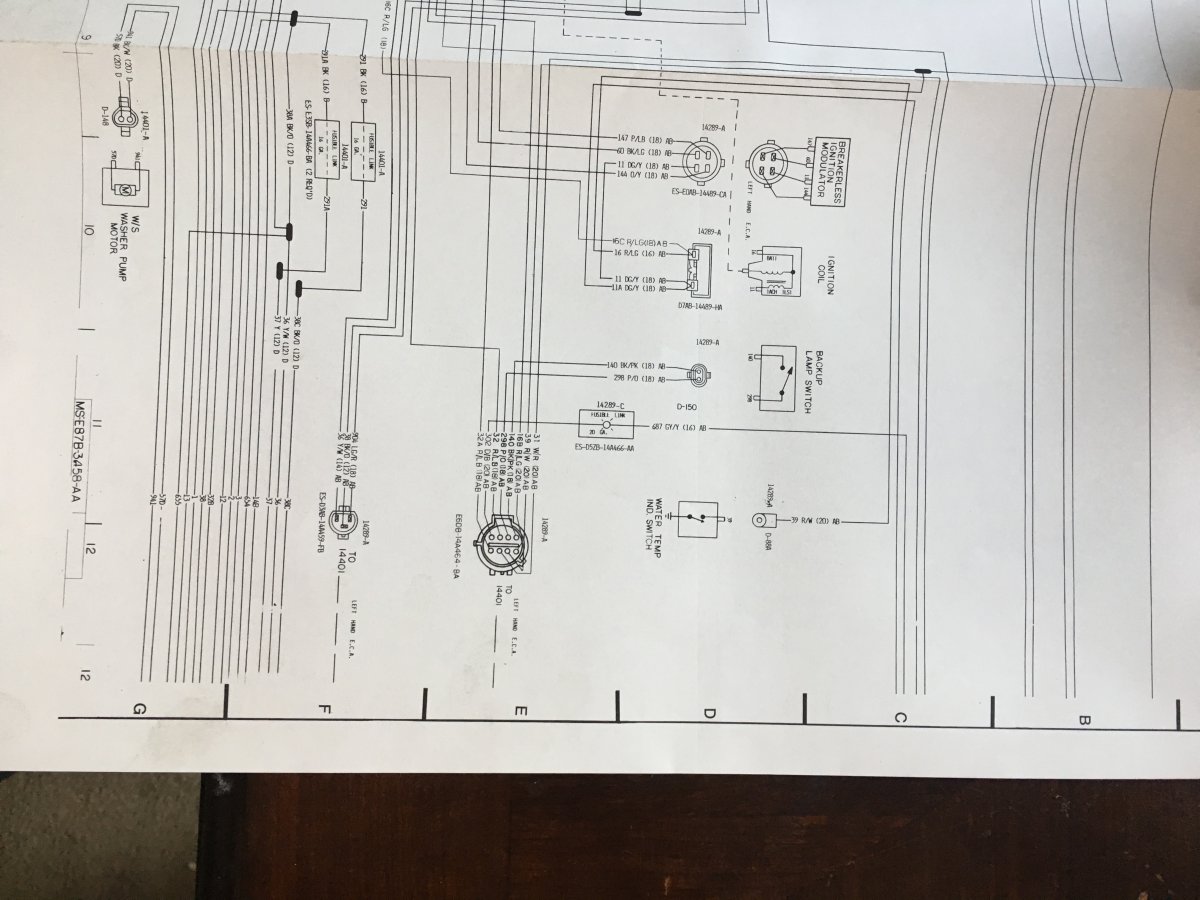

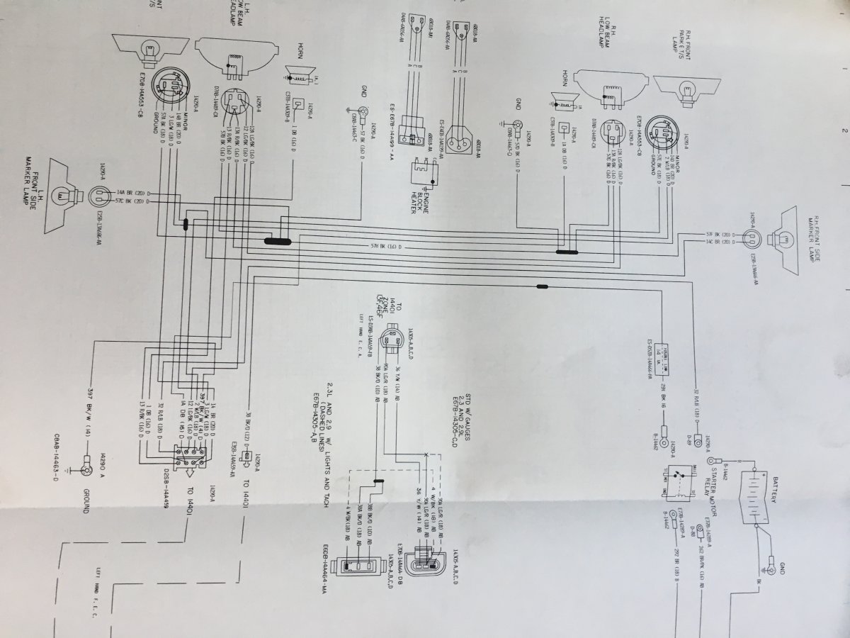

I can walk you thru this. Would prefer to talk to you though. I have the Factory wiring diagram. All colors and part numbers. Or if anyone needs to purchase a wiring diagram ; here is where to get them. They have more of other years. Faxon Auto Literature. I have redone 2 88 Bronco 11s . I am going to try and post the 2 pages of what you will need. But these pages are like 18 X 24!!

There are 3 things to check also regarding the lights. Pull the cover off the steering column. Yellow wire on ignition switch should be 12 v all the time. Look at turn signal switch plug. See if RED wire has melted the plug. If so fix. Also the head light switch plug are noted to melt plug also. Its fun to get to. I don't know if you can blow these up to read. If you can I will send the second page.On my I phone I can read these. Not real good with computers!!
