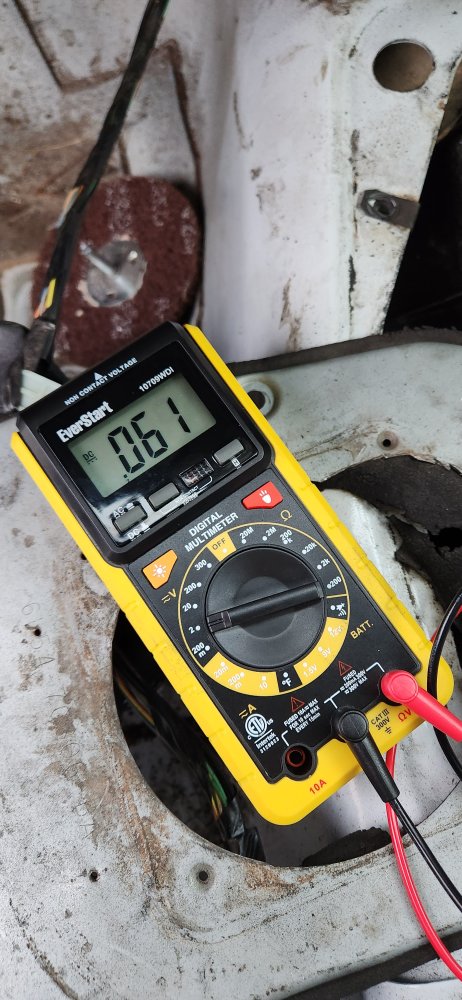

This is what I'm seeing

It never got to one volt. I don't know if that's because of way I'm using to test it, or if something's wrong

If possible have someone turn the key to START while you test the pink wire for 12volts, test light or volt meter is fine
If no 12volts then check fuse 21 in cab fuse box

Fuse 21 should show 12v(10v) with key turned to START on one of its terminals
Currently out of light to work today, and the battery is down to 10v so it won't be able to work the starter until I try to jump it
I only got a max of 0.033 with the voltmeter set to 20v. I'm not sure if I was hold the probes tightly enough against it, as the probes on that one is super short and it's difficult to hold em. But there was a spike in voltage when the key was moved to START
Reconfirming with a set of better leads jammed into the fuse sockets I got the same result. Clearly being a low voltage situation, but I have no idea where to look to try and find where the issue is.

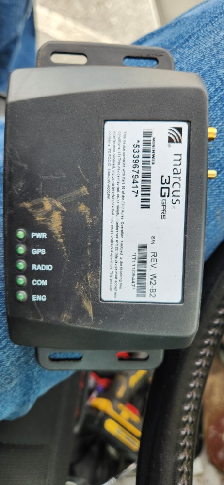

Well, in trying to check the ignition switch I found this little guy. Not too sure if this would cause the issue or not
Tracking unit. It's probably dead.
Oh yeah, that does explain the wear on the steering wheel and why it felt like most of the maintance was "just get it to run and keep the AC blowing cold"
My only question with it, and I couldn't find anything myself is. Would that be the source of the issue?
