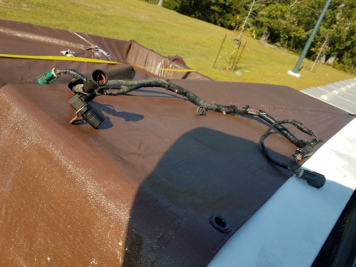

Alright sorry for the long delay. Work got really hectic. But here's the part of the harness I was able to snag. Hopefully this can work, and if so what wires do I need to put this into?View attachment 67311
After looking back and comparing the two, and I'm seeing that I mainly need to figure out what the 8 pin connector does, and a way to merge/splice the reverse lamp sensor and the, I think, speed sensor into the harness. Would the same colored wires in the automatic harness be the same as the ones in the manual harness? I've been trying to find a diagram of both harnesses, but with no luck. Not too sure if I'm searching the wrong things or just looking right past it
There is no reverse light sensor, its just a switch, on/off that passes 12volts to the bulbs at the back
Diagram attached
purple(vt) / orange(OG) striped wire is 12volts IN from fuse
Black/pink wire is 12v OUT to bulbs
Yes, this shows them to be the same color wires on both manual and auto
So then how who I get that to work then? And what about the output shaft sensor?
OSS(speed) sensor, which you need, will have a dark blue/yellow stripe wire, also grey/red wire
ISS sensor, which you don't need, will have grey/orange wire along with grey/red, most sensors share that grey/red wire, just FYI
DTR connector will have a Purple/orange stripe wire from Cab fuse 2, that key on power for Reverse Lights
There will also be a black/pink stripe wire, that's OUT to Reverse light bulbs
You will need to wire those 2 wires to the 2 wire connector for reverse light switch on the manual trans, order doesn't matter, switch is either open, no lights or closed lights on
On the DTR connector will be a Pink Wire, thats from cab fuse 24, only has 12volt with key turned to START
And a Tan/red wire, that's OUT to starter relay in engine fuse box
You can just twist the ends of these wire together, to by-pass Neutral switch, or run then to the Clutch switch in the cab so starter motor will ONLY work when clutch pedal is pressed down all the way
