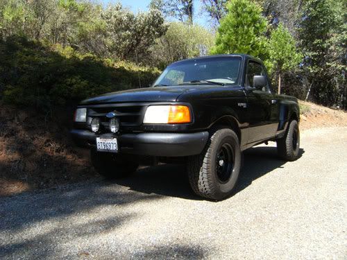

when I got this truck it looked like this:
It was a decent shot at a desert pre-runner. However, it was Hell to drive, rough and unpredictable bump steer. I decided it needed to be fun to drive first. Even after replacing a ball joint, adding a 4x4 pitman arm, and installing adjustable camber bushings it still drove like s__t. The coil spacers had to go.
I added the factory sway bar and replaced the radius arm bushings. I basically rebuilt most of the twin I-beam set up. Then I put aluminum wheels and realistic tires back on. It became much easier to drive.

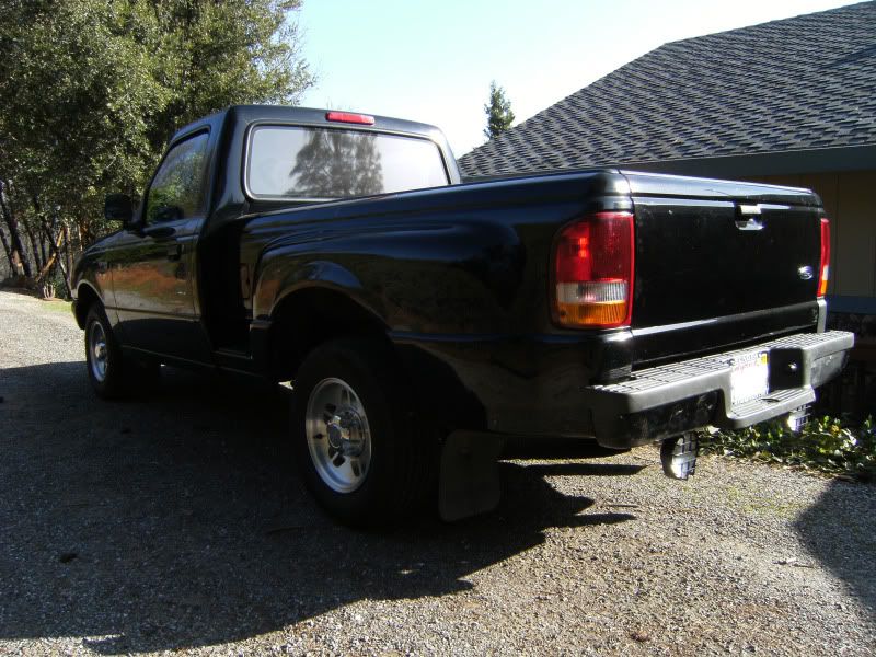

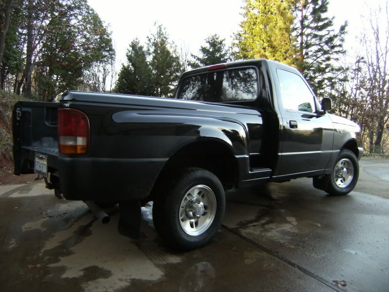

Recently I located a tailgate and bumper at a recycler for $200. I sold the 31"s and spare tire mount for $400. Picked up the Deer Prints wheels for $50.00 on craigslist. I welded up the holes in the bed and repainted it. This all started in may of 2009 and here it is today march 2010. I relocated the driving lights to the rear bumper. I have started to fix the cracked bedsides and hammer out dents in the fenders and bumpers. The heater core had to be replaced. Here's the dash pulled back, tedious.

More pics with tailgate and bumper.
