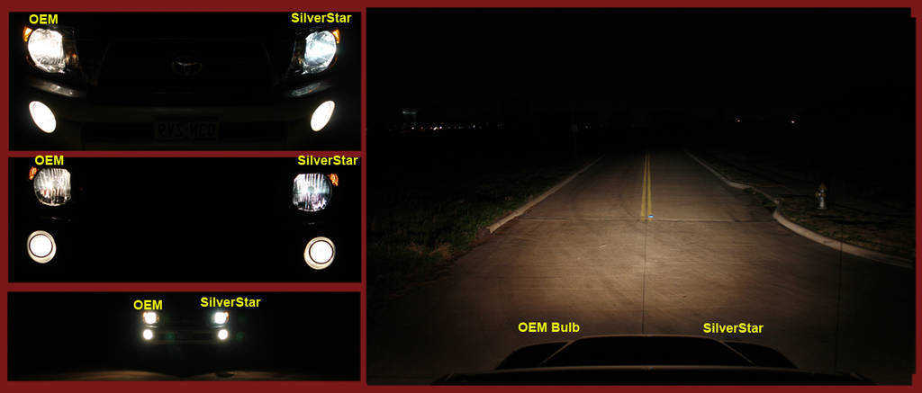

To be honest leave your headlights stock. Just but in a glare reducing bulb like a Sylvania Silverstar or GE Nighthawk. The yellow bulbs only help to cut through fog, they won't have the punch to do the highway light. The Nighthawks & Silverstars are slightly blue but much more powerful than stock. The blue light reduces glare like the yellow but still carries. And these are not douchebag blue lights they are 100% street legal autoparts store bulbs.
NOT THE ONES YOU NEED I DON"T REMEMBER THE ONES FOR THE 99: http://www.amazon.com/GE-NIGHTHAWK-H7-55NHP-BP2-Replacement/dp/B002UXBELY?tag=959media-20
