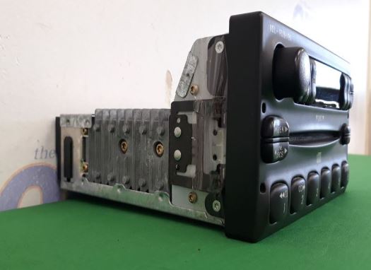

Is there a way to install a single DIN CB and single DIN radio into the factory radio location? I don't want to mod the dash or the surround. I was hoping there was an install kit out there for this like there is for a single DIN radio into the double DIN space. I can't find it if there's one available.
Maybe
Depends on the radio in the car, Most factory radios are only double din at the face plate.
You may not be able to fit 2 singles in the hole. there may not be enough depth for the top unit.

Good point. Depth wwon't be a problem. Stacking them possibly. The head units I'm looking at are the digital units with no CD player, no nav, and no frills. I listen to AM/FM/HD and the stuff I download to a flash drive, SD card, or my phone. Those radios are only a couple of inches deep at most. The CBs I am looking at are about as long as to the back of the heat sink on the OE unit in your pic. So no depth issue there. Stacking them may be where I run into problems. The CB has no lip around the face but some head units do. I listen to the CB more than the radio, unless I'm driving around local to me.
