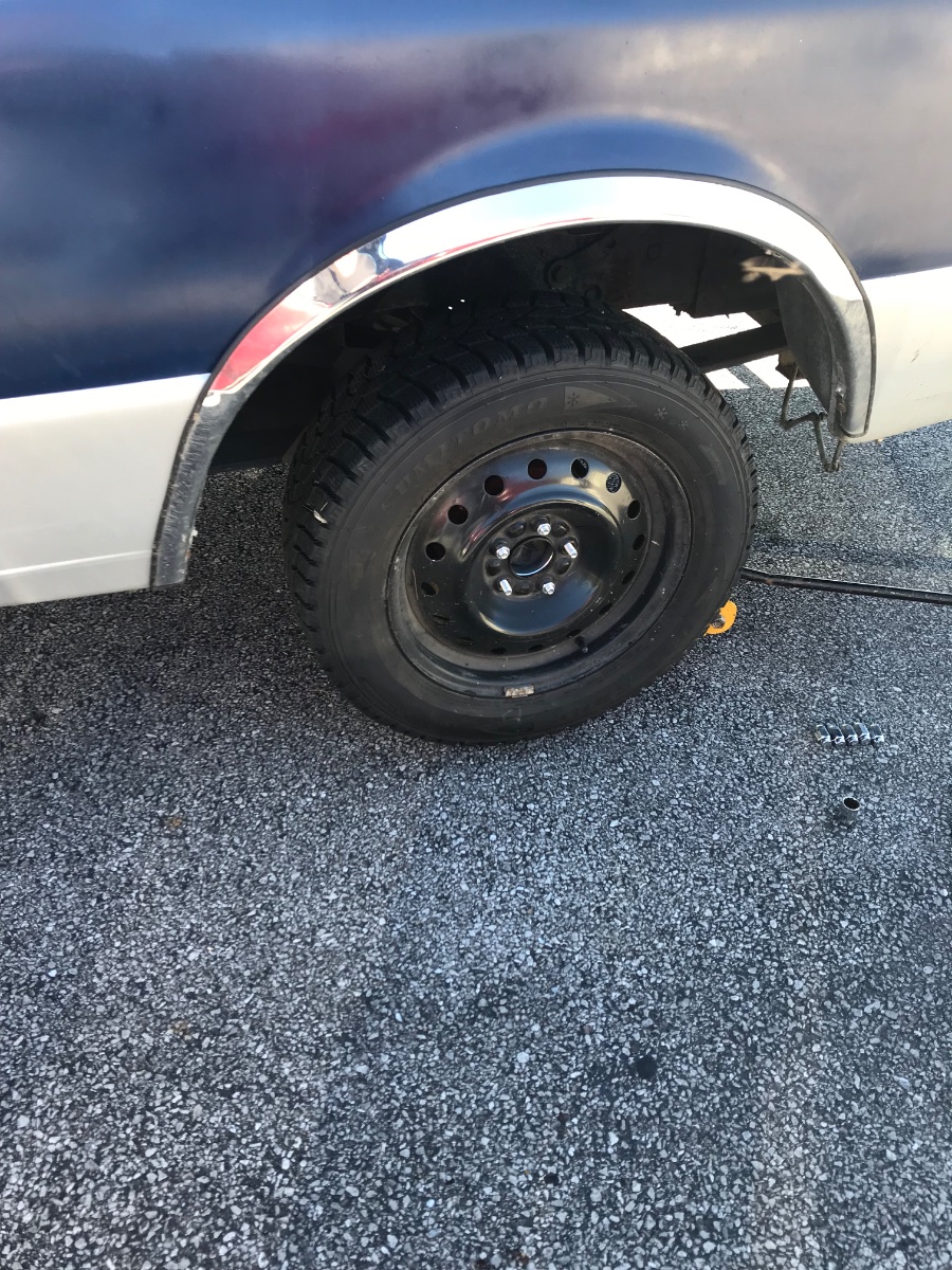

Does anyone know if a 2008 Ford Edge wheels with 245/65R18 will fit a stock 98 Ranger 2.5?
Will 2008 Ford Edge Rims fit a 98 Ranger 2WD?
Not sure about the lug nut pattern matching.
Backspacing/offset will probably be an issue.
Center bore may also be an issue.

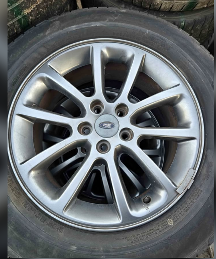

I got some 08 Explorer rims for my 00 4x4 Ranger. I know that the Explorers used the same lug nut pattern. The backspacing/offset is wrong, they set so far in that even if the center bore was big enough, they will hit stuff. Needs a 1.5” or 2” wheel spacer to fit and clear, which also resolves my center bore issue. Downside is that I’m relegated to running spacers to use the rims.

The Edge wheels will have somewhere around +38mm offset while the Ranger has somewhere around -6mm offset, so you will need adapters of roughly 1.5"-2.0" thickness to get the tires in the proper location. I can tell you from experience, it is better to have the adapter a bit thin rather than too thick - if they are too thick they move the tire out far enough it can rub in turns. FYI, the factory wheels will have the offset either cast or stamped into one of the spokes, so you can determine exactly what you need to make this work.

Center Bore / Hub Bore: 70.5 mm, Bolt Pattern (PCD): 5x114.3 (5x4.5), 7.5Jx18 ET44, 245/60R18 (stock) - they're going to be about same size as a 31x9.5R15s.
Center Bore / Hub Bore: 70.5 mm, Bolt Pattern (PCD): 5x114.3 (5x4.5), 7Jx15 ET12, 235*65R15 (stock on my '98 3.0)
So, if you remove the center cap, they probably bolt right on the front. (They would bolt right on the rear) But they will be a lot more inboard (ET44 - ET12 = 32mm in). So, running 30-35mm spacers puts them right back to stock, 38mm move them out about 1/4"....she'll probably not even notice that.
