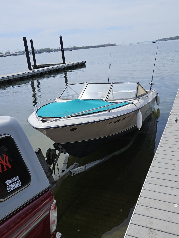

I sprung a really bad transmission fluid leak yesterday towing my boat in hot temps here in the east on my way home from the beach. This had never happened towing my boat in cooler temps. So I'm suspecting high pressure from the heat.
The leak is coming from where the engine meets the transmission I think. It's not coming from the radiator. And it's a lot of fluid. I'm gonna get under it in a lil while, and see wtf is going on..
What should I be prepared for. Ughhhh.

You are brave and foolish towing a boat with a 1993 ranger. Although I did manage to get a few jet skis to the lake once in my '93 4.0 5 spd back in my 20's during the early 2000's. It was sketchy at best...one of those times I look back and wonder how I survived my youth. Cheers.
Father in law towed everything, including a big boat, with his 83 Ranger, 4 cyl, 5 speed. And actually did fine. While nobody had ever accused him of having a lick of sense, in some things he knew when to be patient and not hurry things. So he drove slow, took his time thinking things through. Wish he did that with other things in his life.
Nothing wrong with towing with a Ranger. I’ve towed a bunch of things with mine over the years.
