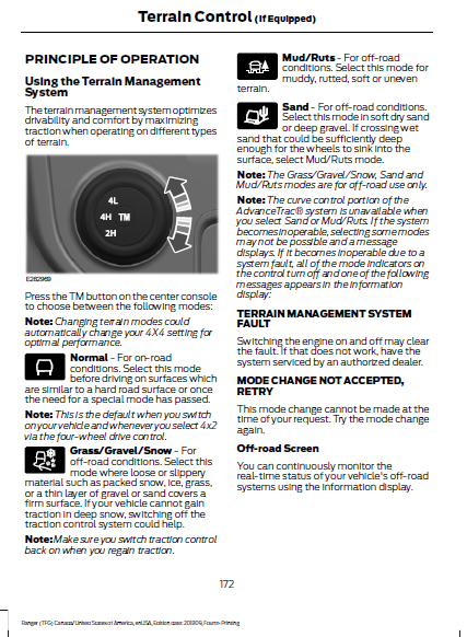

I wonder what Tow Mode (TM) does to the t-case. If Islandboy did the procedure right and the transmission failed, then something is wrong with the truck and it will happen again.
Just to be clear, so there is no confusion....
The "TM" button is for Terrain Management
The Tow Mode button is in the bottom left of the center console... looks like a trailer. It's for towing a trailer, not flat towing the Ranger.

"TM: Terrain Management" vs "Tow Mode"... Both useful items.... hardly interchangeable. Neither of which have anything to do with why Island Boy started this thread.
