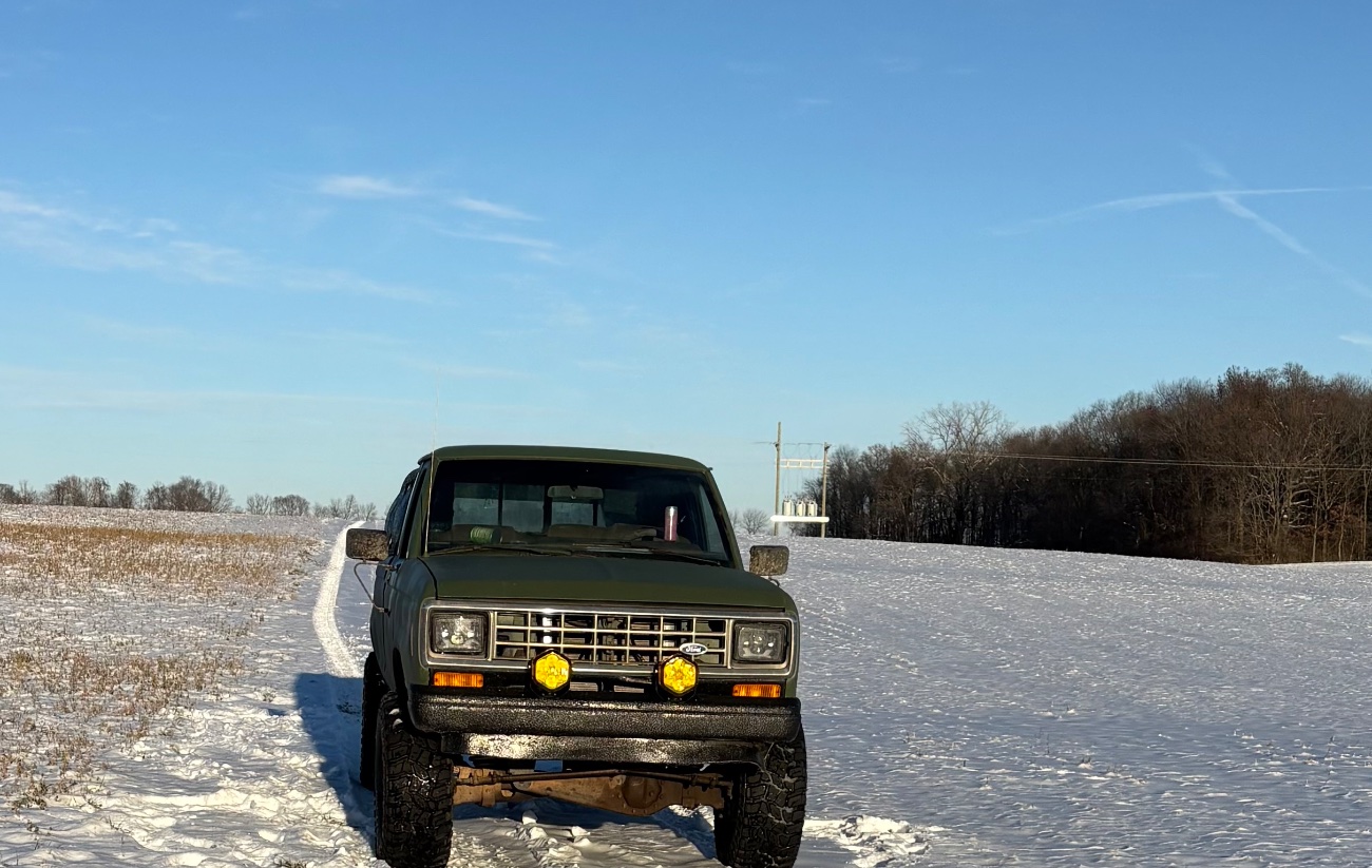

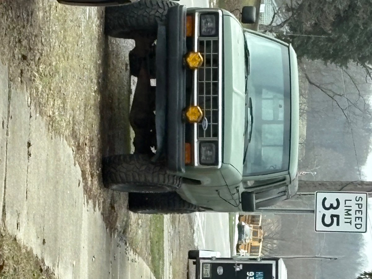

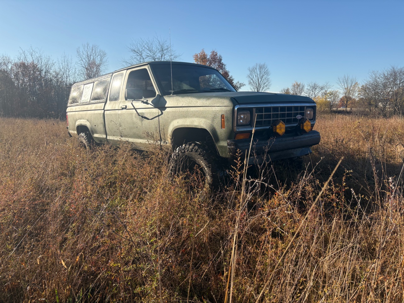

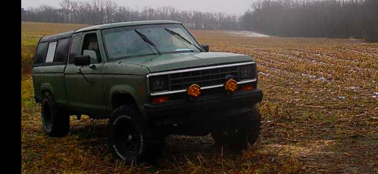

I have been building this ranger for the past couple of years. This truck is a build consisting of several Rangers. This is my first ever build. I installed some cheap hubs a couple of months ago and they completely blew to pieces!! Anyone else ever have this happen? Any suggestions? Thank you!
