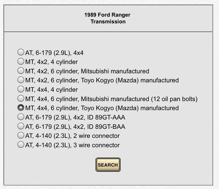

I was under the impression that if it did not have the detachable bellhousing it was an M5OD. The “M” in M5OD stands for Mazda. I thought that there were only two styles for transmissions on the 2.9 engine, the FM146 Mitsubishi and the M5OD Mazda.
If this is true then there are many, many Ranger trucks with 4x4 M5OD Mazda transmissions.
Its not true
First M5OD-R1 in a 4x4 Ranger was 1990/1 4.0l
2WD version was in 1988 and up 2.9l
While Toyo Kogyo Company was the original name of the now Mazda company, the Toyo Kogyo 4 and 5 speeds are nothing like the M5OD-R1, although both were built at the "mazda" factories
And they were not used in 1989 Rangers in any case, so its very odd they are even listed for 1989
What the hell got used behind 2.9 4x4s then after 87?
I thought both the mitsu and TK both died that year?

Politely disagree, God. My 1990 was a factory 2.9 4x4 M5OD. Surprise me as well.
My 89 STX had a 2.9L, FM146, and an 8.8 from the factory (even though everything I've ever seen said the 8.8 wasn't available until 90.)

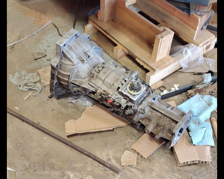

So how do you know if it is an M5OD? If it has a non-detachable bellhousing then it IS a M5OD correct?
From memory, the M5OD will have a fixed bellhousing and no removable bottom pan, where the TK and FM series would have both.
Can someone please confirm this ^^^
