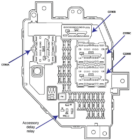

OK, so I can't get the picture from the online EVTM to render properly as an attachment here, but if you would remove the SJB completely, and hold it so the fuses face you, and the SJB roughly resembles the shape and orientation of Nevada, the accessory delay relay is the big one between Las Vegas and Reno on the California border. Much closer to Vegas than Reno. Like right where Nellis AFB and the Nevada testing range are.
Yea mine just has a blank spot where that relay would go.... if there's no relay what the poop is physically responsible for disconnecting all that nonsense? Now I'm even more confused. I've been out here fiddling for hours. Had it shut down once (only takes a couple minutes) tested it again and now it's been stuck on for 2 hours.

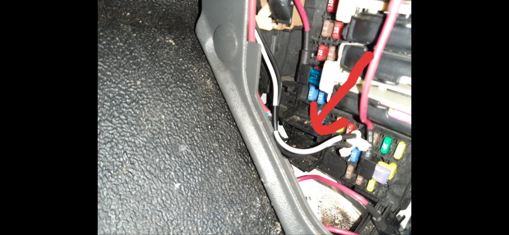

Yea see... I know where the relay SHOULD be, but there's nothing at nellis air base! Just a blank spot the shape of a relay plug... government cover up?

See! Missing! So with no relay what actually turns crap off? Something in this dumb thing is sticking open...
Ignore the strange wires that don't belong or go anywhere...
