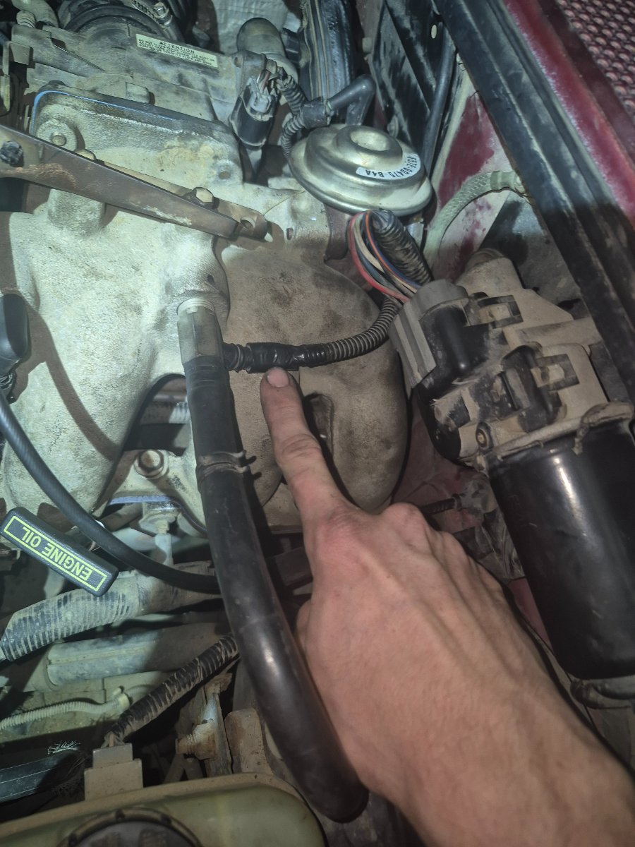

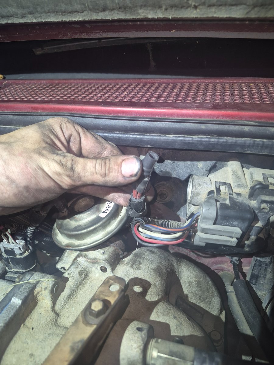

Hello, this is my first post and I apologize beforehand if this is in the wrong section. I replaced the intake manifold & now I can't figure out where the 2 red wire connector (that's a part of the green wire going to the top of the EGR valve) goes.

Is that wire or vacuum tubing? Looks like vacuum tubing to me. If so, you're looking for some vacuum device (egr valve, fuel pressure regulator, etc.) that isn't connected or a vacuum supply port to hook it onto.

Yeah, that's a vacuum hose, I'd look at my '97 for you but I won't be able to until tomorrow... I think it just goes to the intake manifold somewhere unfortunately I think it's under it by the throttle body or on the throttle.

It looks like a vacuum hose, however there are 2 red wires that go in. It looks to be an electrical connector for the purge evap system. I just can't find the spot to connect this to, unfortunately. I went ahead and checked the sticker that you referred to & it shows that it goes to the same area as the green plug on top of the EGR valve.

Your first picture, showing the plug in question, sure does look like two red vacuum lines on a single plug-on port. That is very typical for how vacuum lines plug onto the vac tree or nipple at the source.

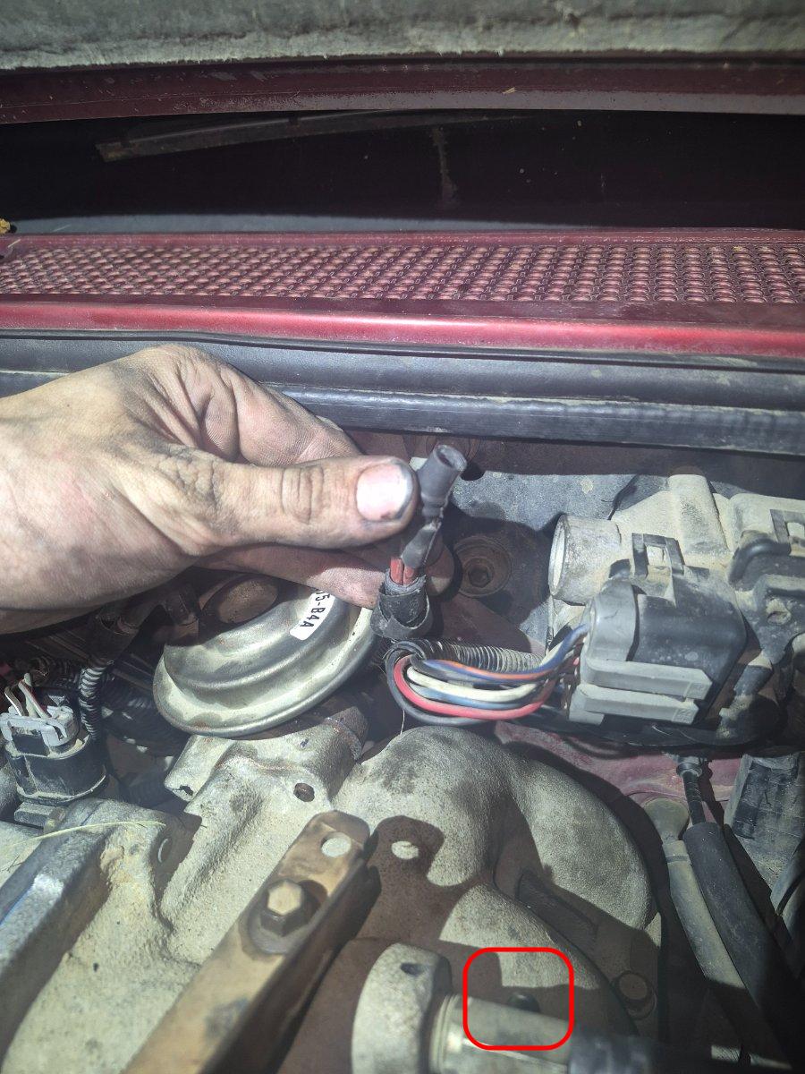

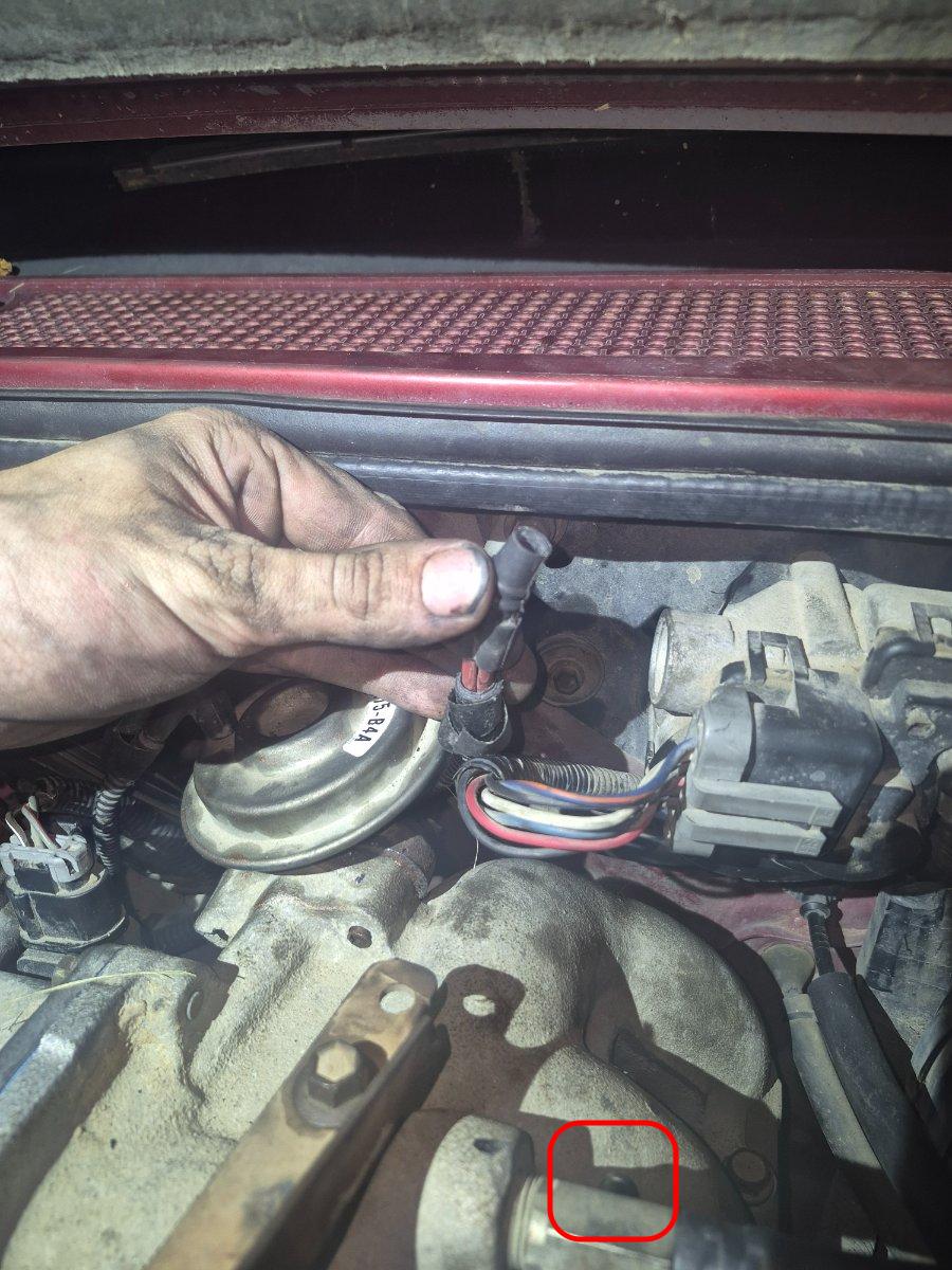

Have you checked real good at the area that I've circled in your second picture?
Hey RobbieD, I have inspected both on top and under. I suspect I may have to pull the intake manifold off again. However I'm trying to hopefully locate where the part is, so that I can avoid doing that.
Thank you for circling it and pointing out how this works. This is all new to me, so it's very appreciated, and discovering the diagram yesterday was shocking (in a good way)!
Those are not wires. They are hollow plastic vacuum tubes.
Mine tees off the line to the brake booster.
As soon as I read this and looked again at the picture (where you circled) I jumped out of bed and straight to the shop!
You found it and solved my 2 day headache. I thought I was going crazy. Thank you very much
