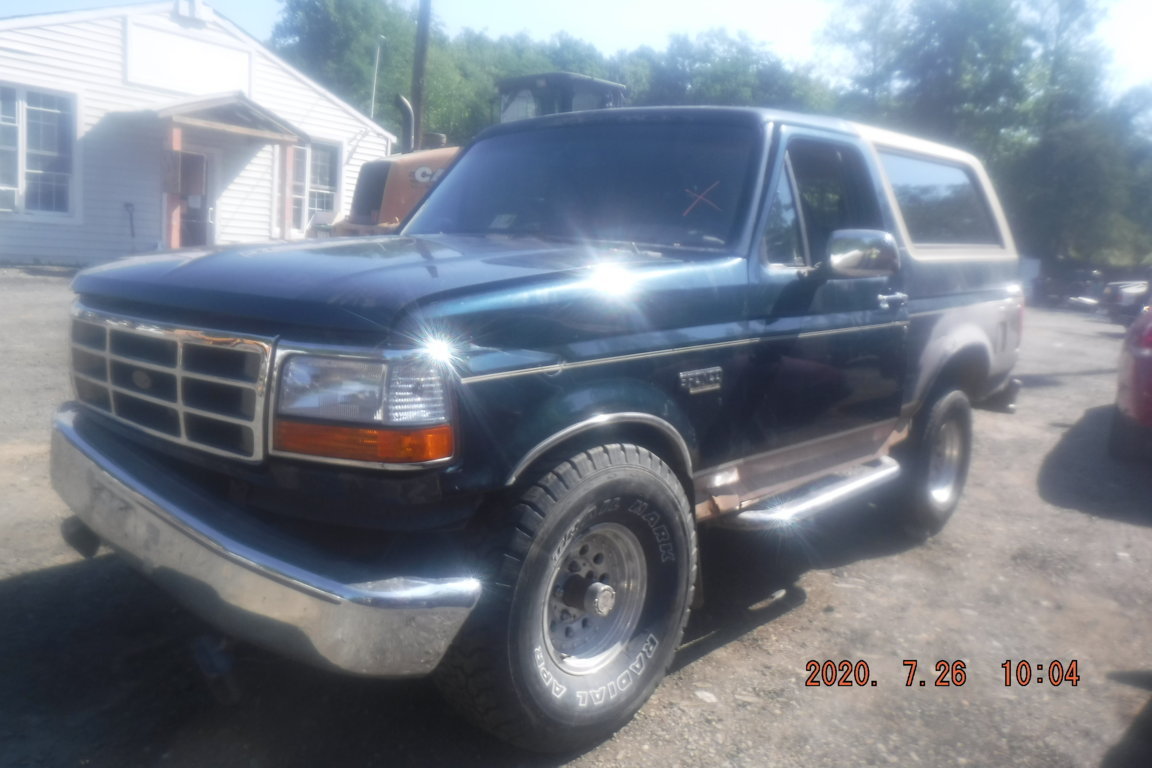

Are the offset, lug pattern, and bore size the same? I'm looking at a set of Ford aluminum Alcoa style 15'' from a 1994 Bronco. Will they fit my 87 F150? The front shaft seems to stick out past the wheel, further than my F150. May just be missing the cover.

AFAIK, The Bronco frame is a shortened version of the F-150 frame, so wheels/rims should fit.

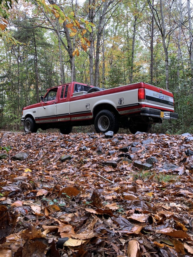

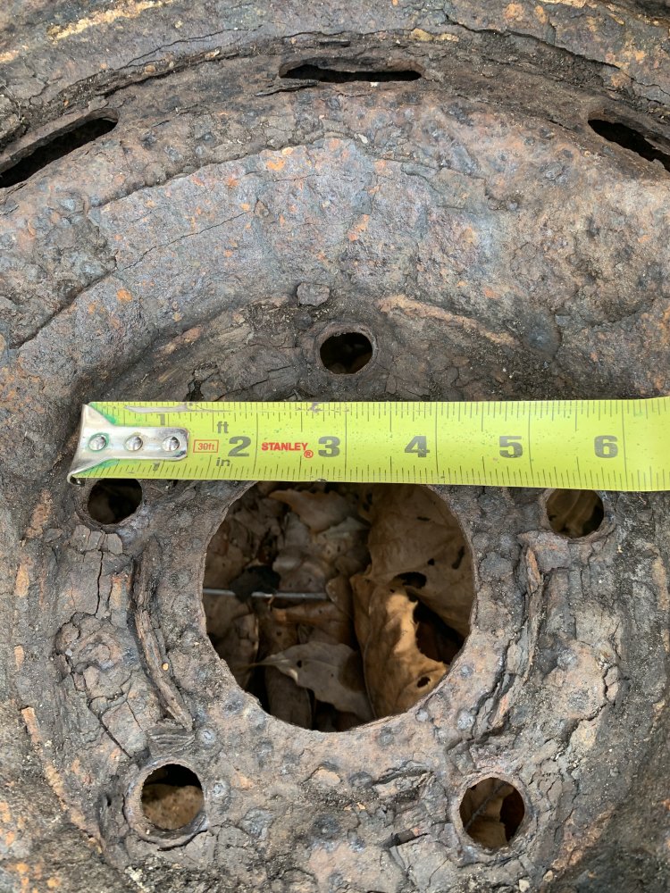

Just figured out how to properly do this. Looks like I have 5x5.5. Thanks.

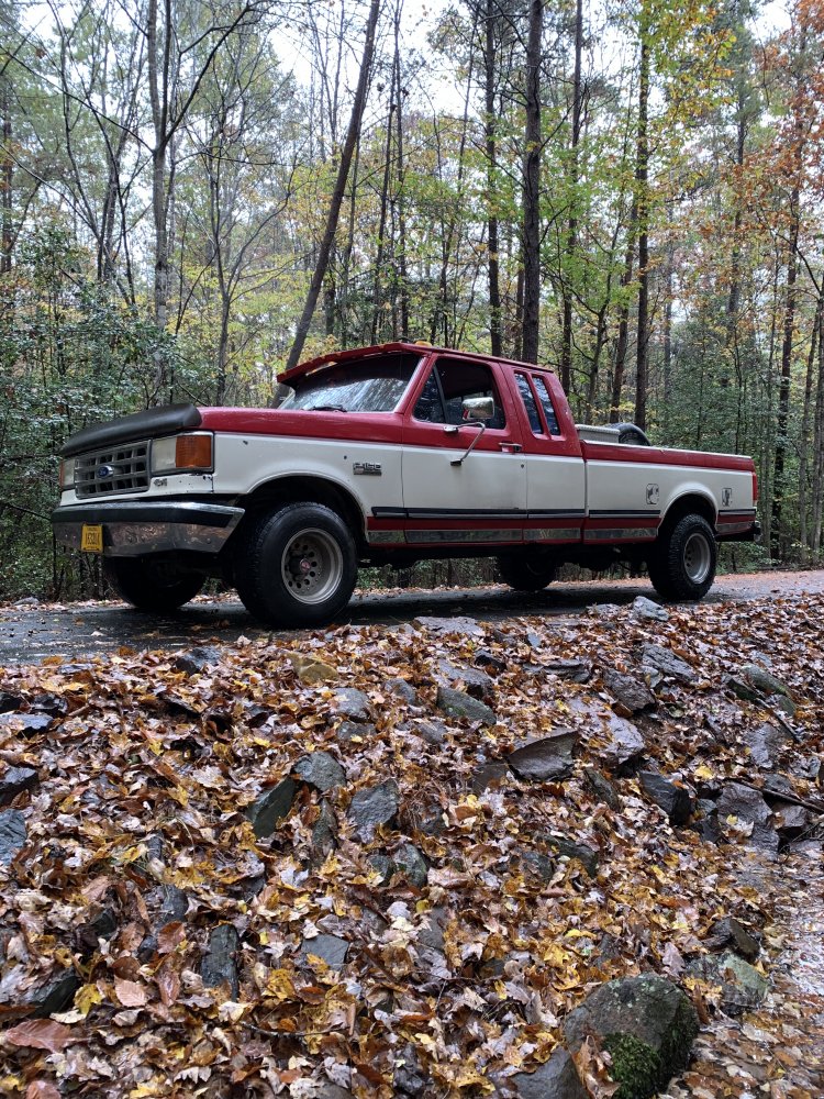

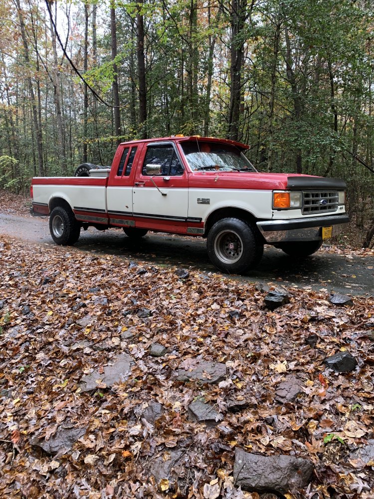

Thanks guys, they fit perfect.
