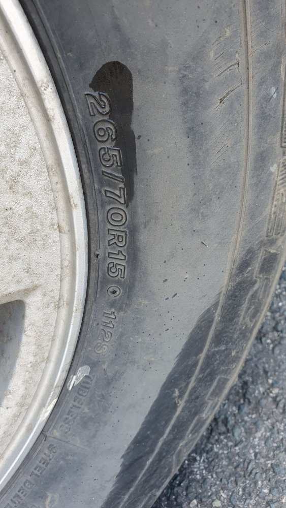

I'm going round in circles a bit trying to get my head around rims and tyres. I know I want slightly bigger (taller) overall wheels and for them to be a bit more pronounced (Sticky outy / Negative offset).
I'm struggling to get comfort on which tyres would fit - Currently I have 265/70R15 and I'm just assuming 0 offset as I cant find confirmation. As Im looking to negative offset by 20mm or so I'm guestamating that this should be fine? Any advice would be great thanks.

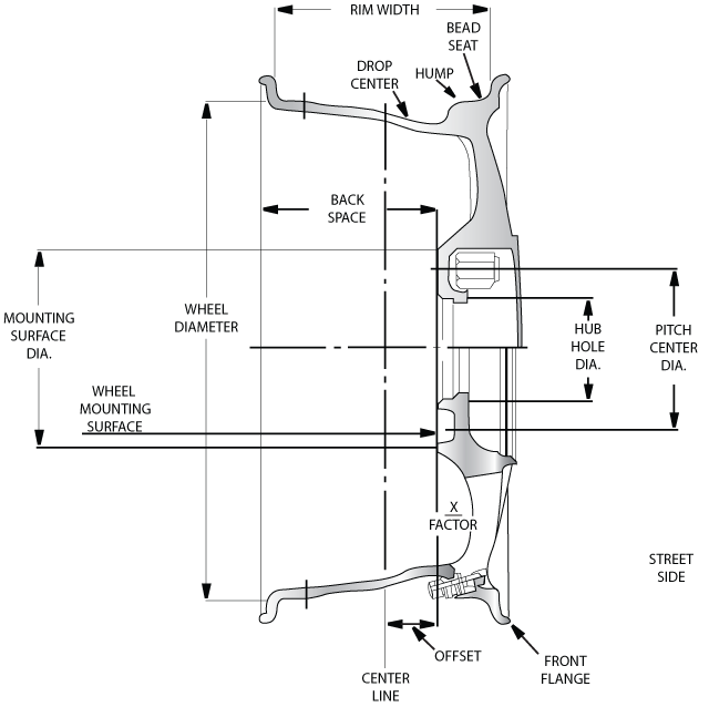

If you take a wheel off and lay it face down you can put some kind of straight edge across the bead of the wheel and measure down to the mounting surface that mates to the hub. That measurement is the wheel's back spacing. Flip the wheel over and repeat the measurement on the face and the difference between the 2 is the offset.

If you take a wheel off and lay it face down you can put some kind of straight edge across the bead of the wheel and measure down to the mounting surface that mates to the hub. That measurement is the wheel's back spacing. Flip the wheel over and repeat the measurement on the face and the difference between the 2 is the offset.View attachment 41895

in the US the size and offset is stamped on the back of most factory wheels.
I would expect the factory offset to be more than 0.
on my 2000 and 2005 the offset is 12mm.

As previously mentioned, yank a wheel off and measure the backspacing and width. Then you just have to decide how much more "out" you want them to be, and just buy wheels with that much less backspace.
So say your current wheels are 4.5" backspaced, and you want the tires to stick out another 1.5".. You would want to order wheels with a 3" backspace.. Or just run spacers in the desired size. Proper offset wheels are preferred though.
