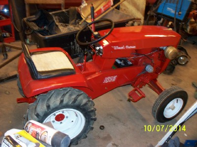

Here is a picture of my 1055, only difference is it has 10HP Kohler.View attachment 26544
Nice looking unit.
