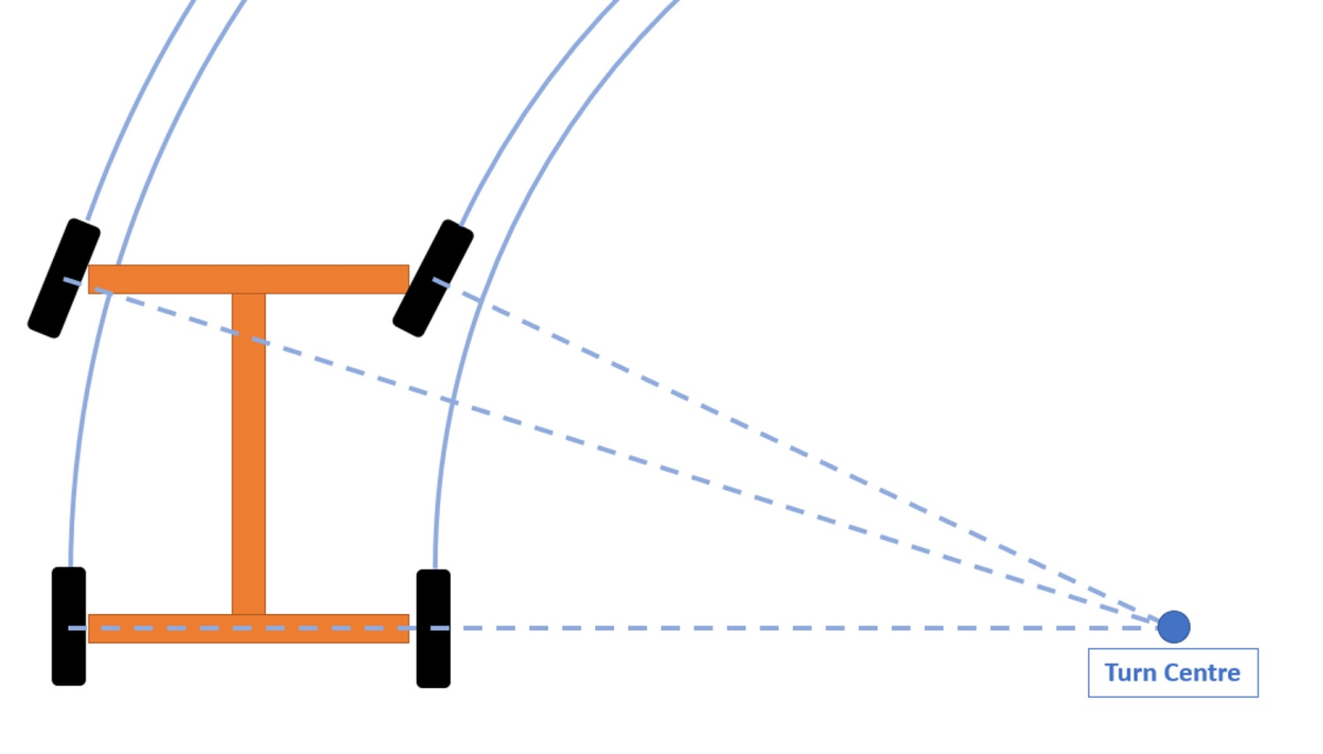

Picture is worth 1k words
As you can see the front wheels turn a larger radius than their rear counter parts. So, you either need a center differential or loose material on road or things bind.
