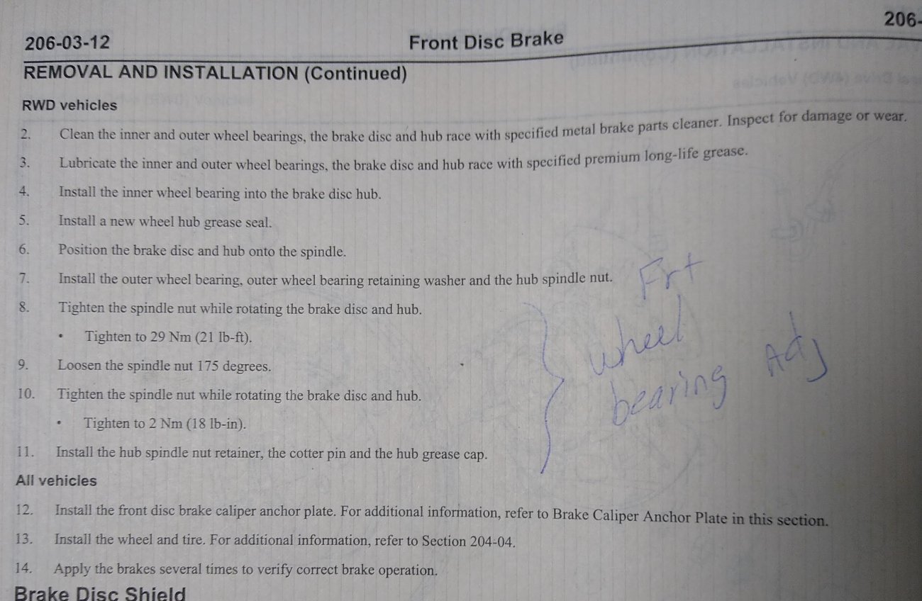

I am looking for the actual torque spec for the front wheel bearings spindle nut. 2011 Ford Ranger 2WD
Please do not reply "tighten until..." Looking for the actual Ford spec.

From the haynes manual:
1)tighten to 17-25 FT lbs while spinning the rotor around.
2)backoff 1/2 a turn
3) re-tighten to 18-20 INCH POUNDS

I have the 3 volume set of 2011 Ranger Ford factory service manual set.
It's not really a final torque. Its a sequence of two torques while rotating the rotor (calipers removed) as was described in post #2. See photo below from my manual.

Nah they kept the old school jobbies right up until Ford started the ranger hiatus in 2012.
I thought the Ranger went to unit bearings in 98?
Just the 4X4 models got unit bearings. The RWD models kept the conical inner and outer bearings to the very end. I haven't paid attention to the 2019+ Ranger bearings to say if RWD models went to unit bearings then or not.
