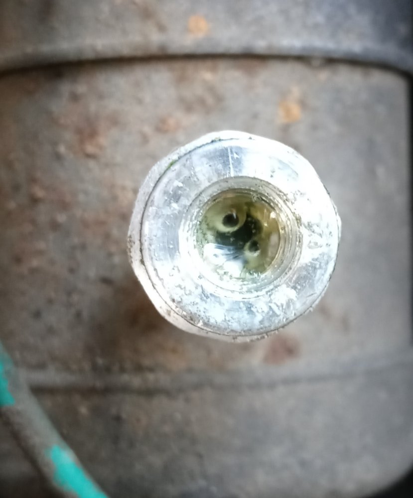

What's this AC component?

I put a couple cans of stop leak and another can of 134a and got it blowing cold then it leaked down within a couple hours. So I dribbled some oil in the schrader valve on the high side and found the leak. Pretty much what I figured.
So I screwed in a fine thread sae bolt with some pipe sealer and that seems to have stopped it. On the low side I'll try a bolt with teflon tape and see if I can get through the rest of the summer.
