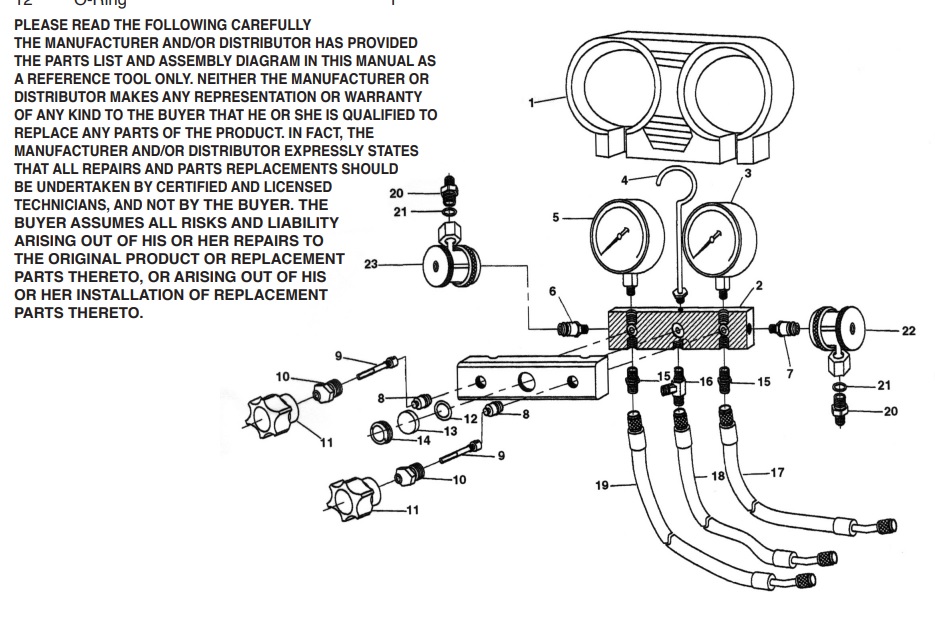

What more tools are needed? I bought the orifice tube puller, vac pump, and gauge set. I already have the AC/fuel line disconnecter things. I have everything 10x over to work on engines. If I buy more tools I'll have to build a new garage lol

You got a can tap for the gauge set? A HVAC thermometer is also handy.
I don't see one.

Only other tools you might need are a can tap adapter if you're planning on filling through your manifold set. Otherwise you can pull a vacuum, remove the manifold & hoses and fill the system with one of those cheapo spray & pray hoses that screw onto refrigerant cans - that's how I do it, you only waste a tiny bit in the hoses vs quite a bit more in a manifold set. If you were weighing it in from a bigger container then it's better to go through the manifold but in our case I believe three 12oz cans should be a complete fill.
I have the cheapo one. Actually I have the tap for the old style cans that puncture and don't reseal, but I don't have a tap for the new cans. I guess I'll do it like you said.
