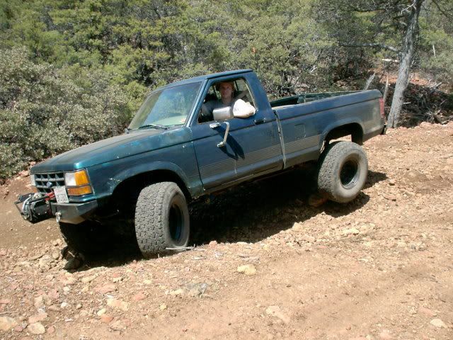

the trucks dented up but the folds are clean:icon_thumby:
Done with a Sawzall:
I used the finest tooth blade available (32TPI IIRC), laid down a piece of masking tape to follow as a guide, and went real slow with it. Afterward I used a Dremel to smooth down the edge.
