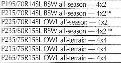

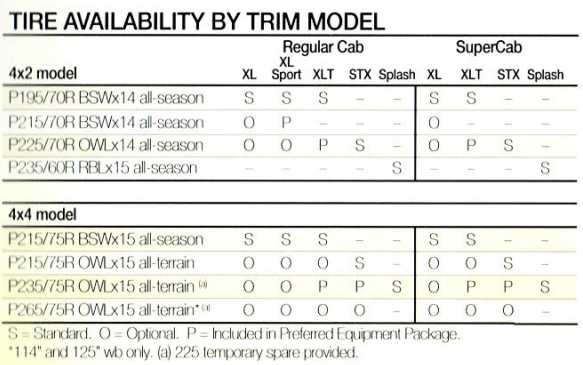

I've tried looking around, but couldn't find a real answer. I know for sure that they all came with 4.10 gearing, but did they come with 215/75R15 or 235/75R15 tires? Here's a snippet from a brochure below:

215/75R15 is standard, everything else is option or package (which I suppose is sort of an option)

4.10s were only ratio available in 2.3 4x4 Regular cab (Regular cab is redundant - you couldn't get 4x4 and SCab in 4x4).
But was the 235 tire package an option for the 2.3L 4x4? I know it came with only 4.10 gearing so I feel like that would mean it could only come with one specific tire size as there was only one gear ratio available. I could see there being multiple options for the 3.0 or 4.0 since there were more ratio options, but I want to know if it was available for the 4 cylinder.
