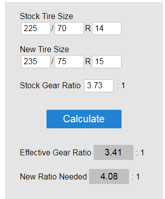

So I did the gear ratio calculator and it shows that going from stock tire size to the 235's would require the 4.10 ratio to be the same.

If the calculator says 4.10 for 235/75R15 from 225/70R14, then why were 215/75R15's made the stock size for 4x4's? My truck already revs pretty high at 65 mph on the highway with the 14's, so if I went with 4.10 gears wouldn't 215's be too small? I feel like it would rev EVEN higher.
