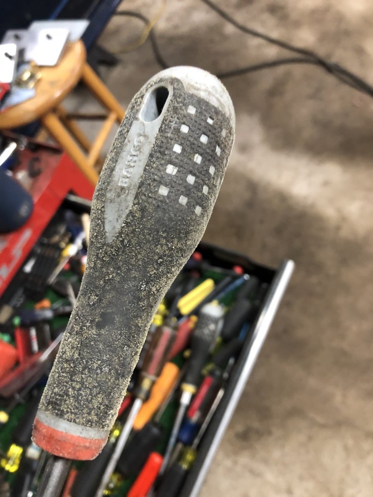

What do you guys do a about moisture and humidity in your shops/ garages?

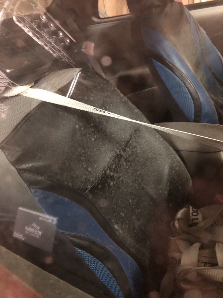

It’s always crazy humid here, and sometimes when we get a bad rain I get water running through my shop. Everything is always mold on it or getting rusty just from sitting out.
Hell, my truck started getting moldy just sitting in the driveway for a few days.
I have a dehumidifier in the basement, that helps a lot, so I am thinking about putting on in the garage too.
Does anyone have a better suggestion
