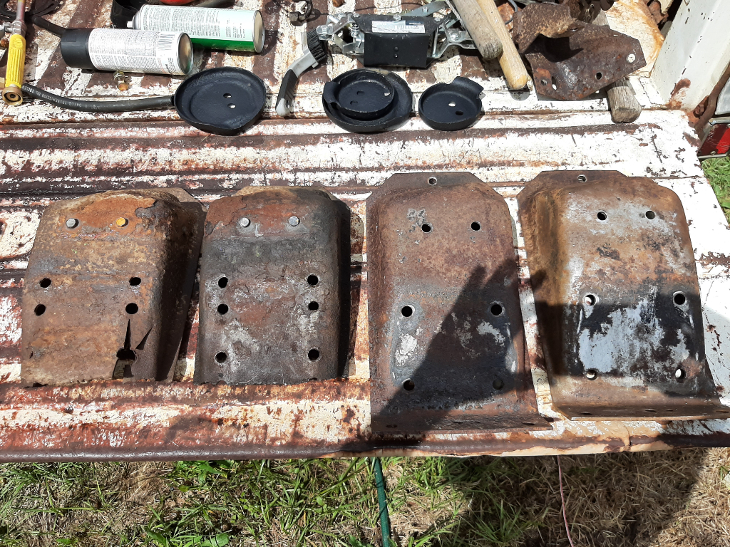

I see what you are talking about now and agree 100%. Wasn't on a Ranger, but I found this suprise on my 68 F-100 last year. Don't know how well the pictures show it. I under the driver side looking for a power steering leak and just happend to crawl under to the passenger side to look at something. I was just driving it a few days prior when the power steering failed. I knew that there were cracks going from the bottom of the tower up to the bottom bolt holes, but looked solid from there up and I wasn't driving the truck much and figured I'd remove, weld, and plate them before much longer. Looking at it after the fact it is obvious that they were cracked well past the bottom bolt holes and had been for a while (no clean metal). but couldn't see it looking at them prior
On the left are the "originals" modified by previous owner (dad) for a slight lift in the 80s, replacements on the right. Truck had this one inch "lift" plus a two inch body lift before. I replaced the original springs with taller ones from a 70s model truck to regain that inch of lift. Still want to remove the body lift and maybe do a 2-4" suspension lift, but I'm scared of the current bed falling apart due to rust if I try.
