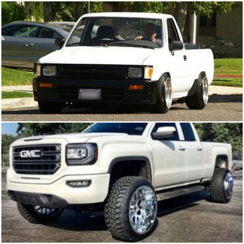

The 'yota is from the 90s, the Chevy is current.
Well, I was just thinking that a shorter, but all-season tire would give the truck a lower ride height and be less wheel for the drivetrain to turn, potentially causing slower and maybe even less wear of parts throughout the entire drive train and maybe slightly higher mpg’s and maybe less wind noise on the highway. Also, I see the wheel configuration on these new trucks, it’s less sidewall, more rim.
