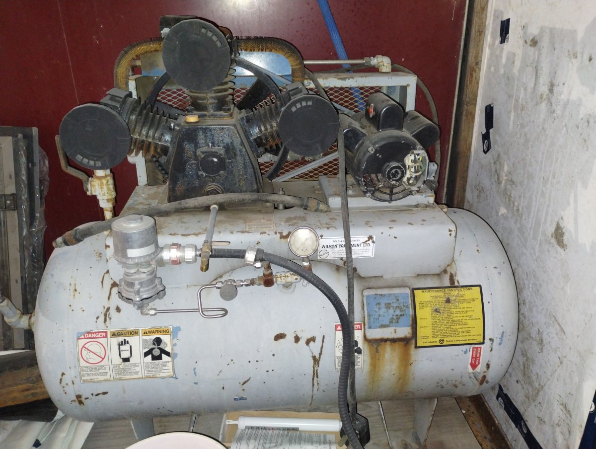

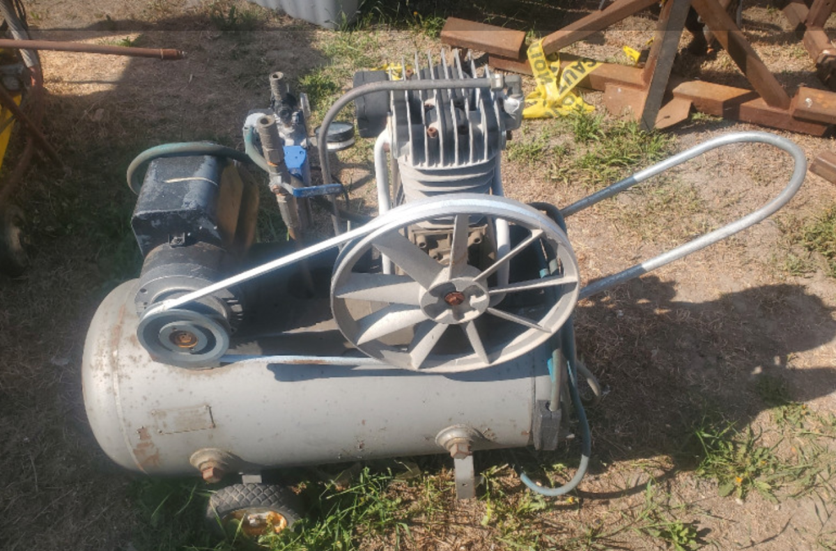

Pics;
  • What did YOU do today?
The little one looks a lot like what my motor came from. It was the old red sears craftsman, but same layout and the pump looks almost the same. We've still got the pump from it too and before finding the one I bought I'd have been happy with just find a new tank to mount both on.
That big one is a hoss, that 3 piston single stage pump aught to flow. Is it 18 CFM @ 90? Mine is two piston single stage with 15 CFM @ 90 and I'd expect that three cylinder to flow even better.
I believe it's 18 @ 90psi. I'll have to time it from empty to full to find out for sure. I just finished getting it running and winter hit so I haven't done any more with it.

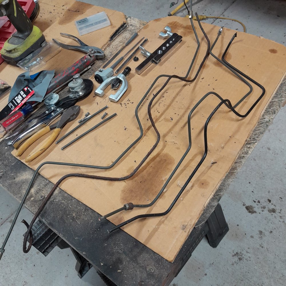

I fabbed up a couple of rear brake lines for our 02 Exp. Sport Trac..
Project is coming along slowly, but no rush
Nice bends! I can never seem to get them looking that good. Are you using steel or nicop?
