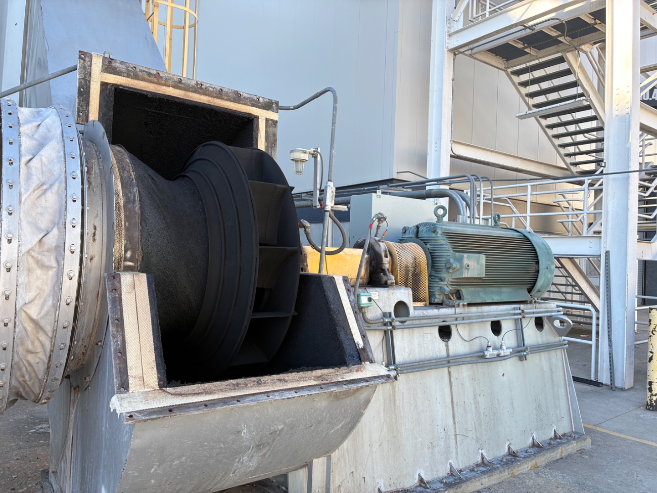

So far this morning, I’ve finished off 2 twelve ounce coffees, a pack of Pop Tarts and removed a cover from a fan so it can be pressure washed. On to the next work orders. It’s triple time day for a 12 hr shift.

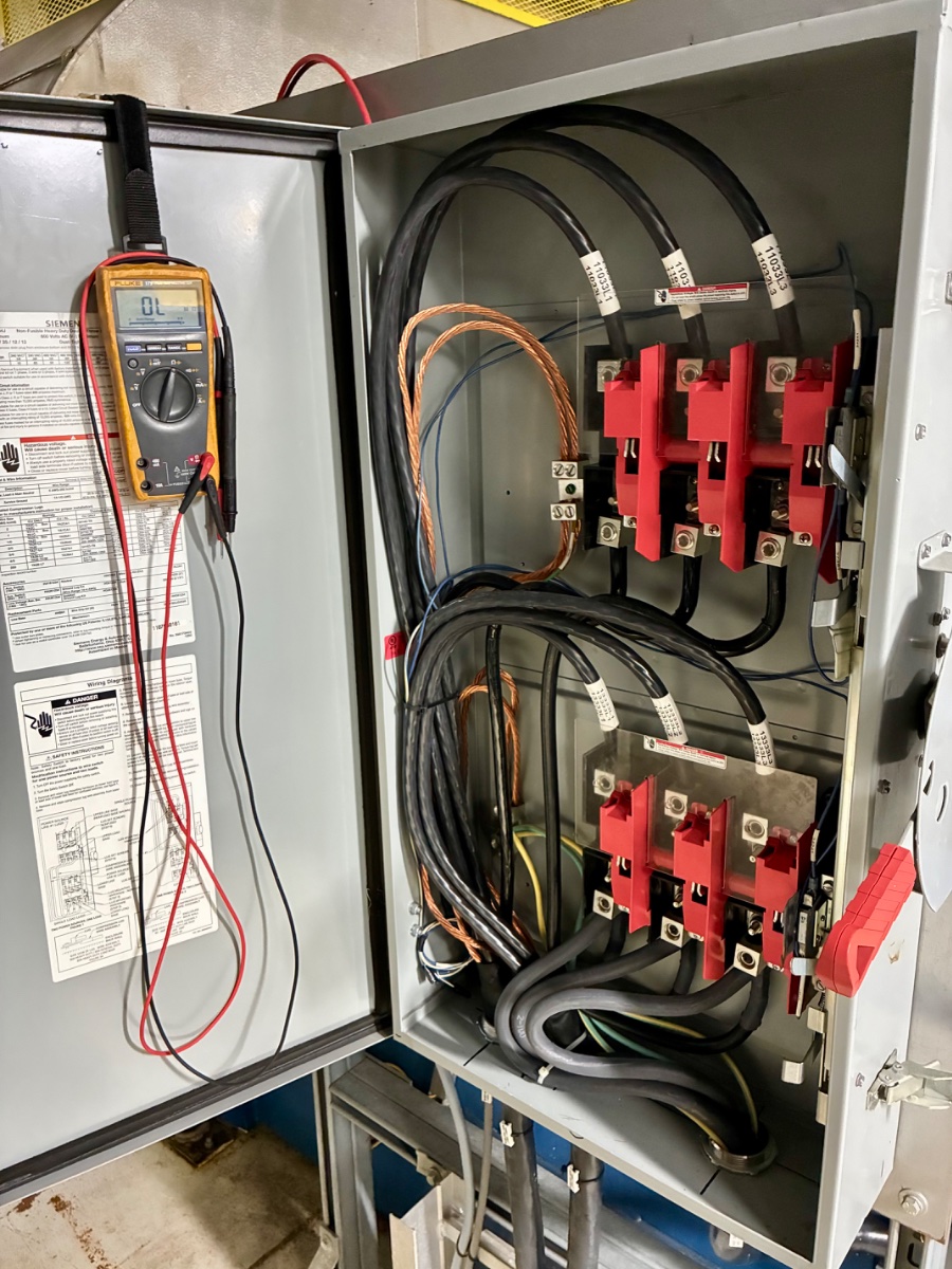

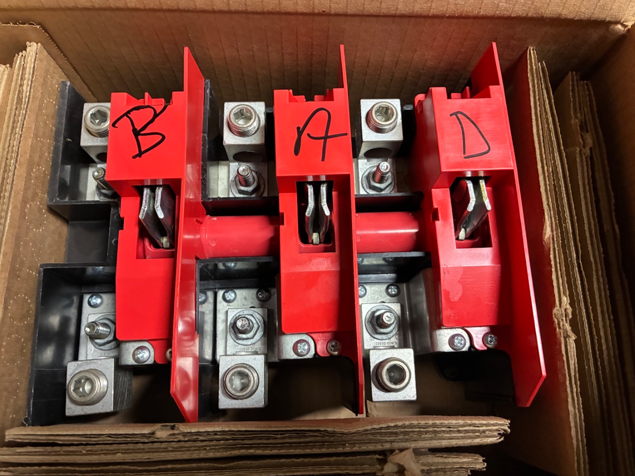

And repaired a few motor disconnects that had loose knife blade connections causing overheating.

Easy peasy. Just de-energize and replace the knife blade assembly

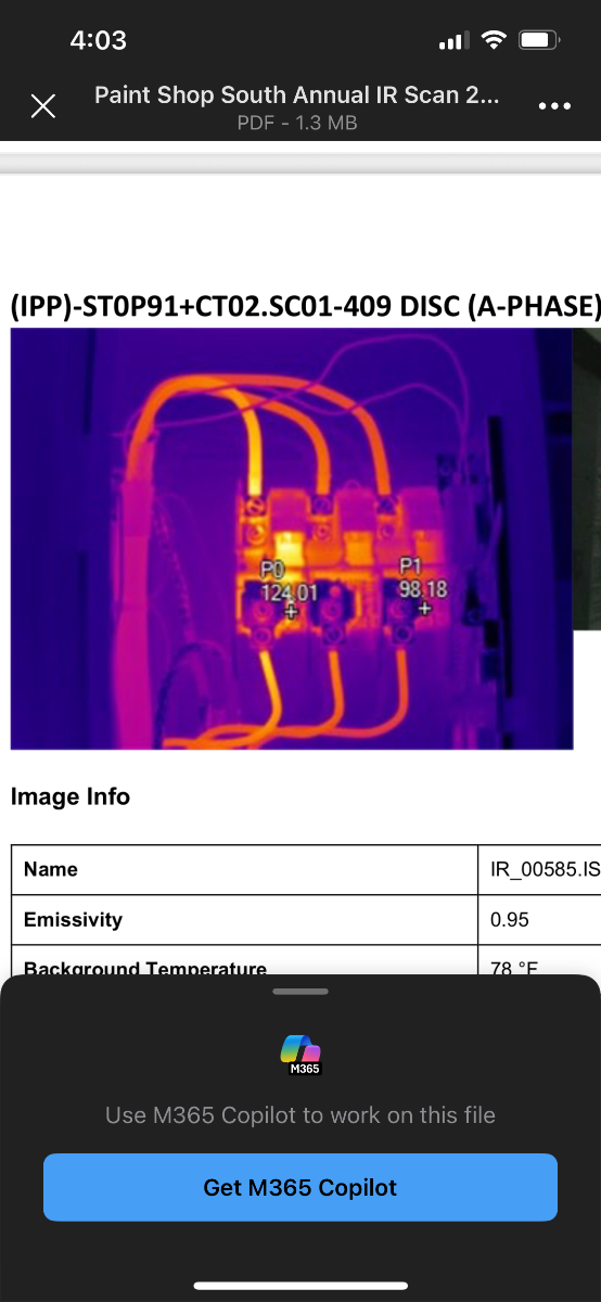

That’s no good. Once the fingers have been overheated, they lose their temper and will never grip tight again. Squeezing them doesn’t work because they are no longer springs. This causes a looser connection and more overheating with more thermal expansion and contraction making them even looser yet. Then higher temperatures… It’s a downward spiral that ends in fireballs and downtime. Once identified as overheating, the only solution is replacement. We do thermal inspection every fall and make necessary repairs ASAP. The IR camera doesn’t lie.

We can’t do it that way. Customers want their cars too quick. Notice, also that that disconnect has an upper and lower knife blade assembly. There is an extra VFD in the cabinet. So, if something happens to the VFD/breaker/fuses/ line reactor, etc. that normally feeds that motor through the upper knife blade assembly, we can turn the disconnect to the bottom position and feed the motor from the standby VFD. All our critical equipment is like that. Some equipment, like elevators in our conveyor systems even have a second motor and gearbox (motoreducer) installed. Disconnect the coupling from the bad motoreducer, connect the coupling from lifting drum to the standby motoreducer, swap the cables to the standby motor and away we go. Replace the bad stuff later during weekend shutdown shift.
