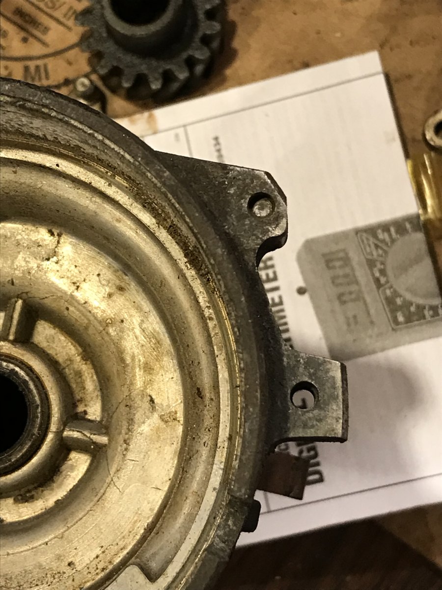

recently broke a 8-32 screw off in an old distributor, steel screw in an aluminum housing.
decided to remove it today.

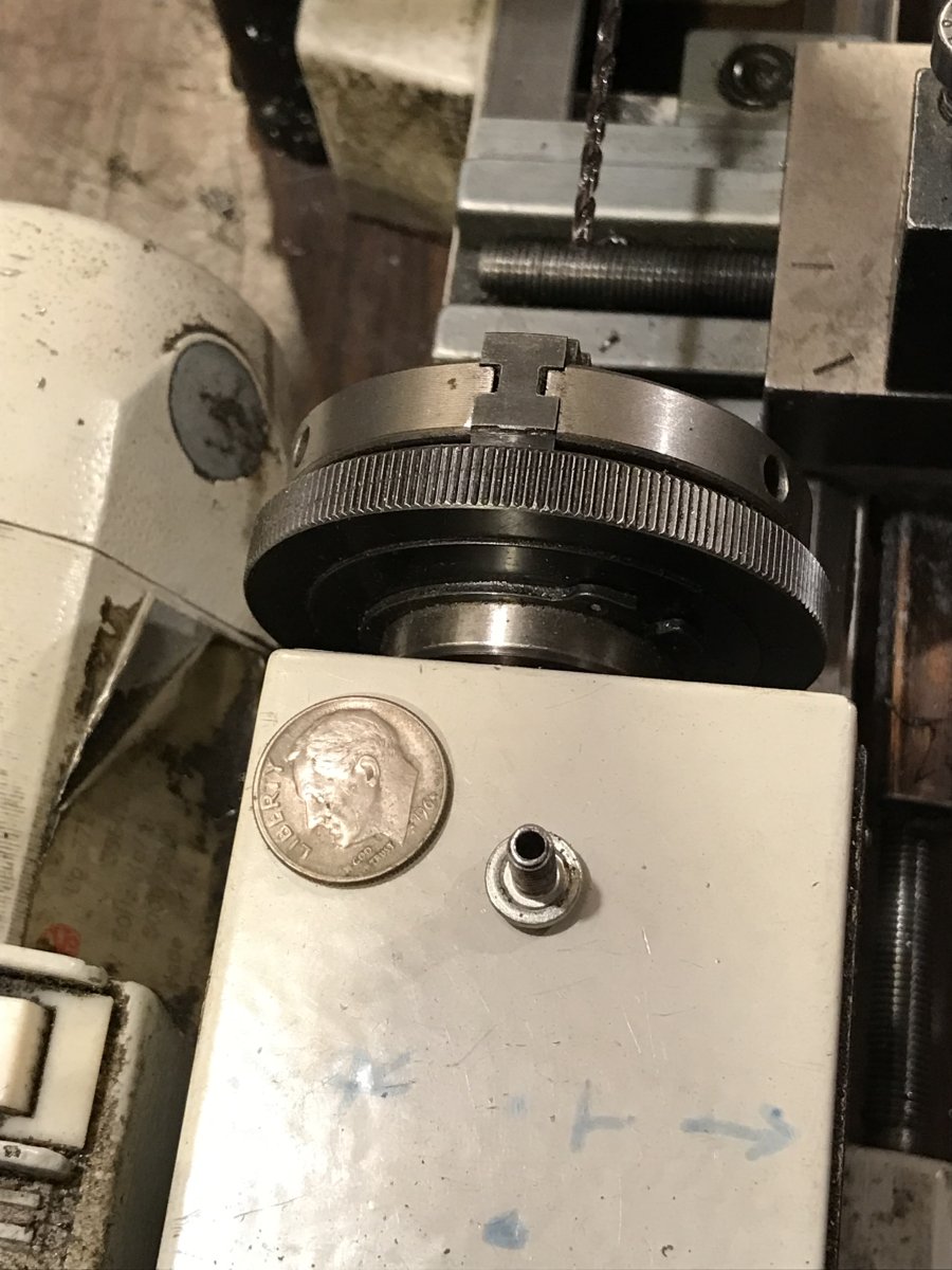

since there was still some good threads at the opposite end of the hole I made a pilot by center drilling a short 8-32 screw.
clamped the housing in a drill press and drilled the pilot holeView attachment 125045

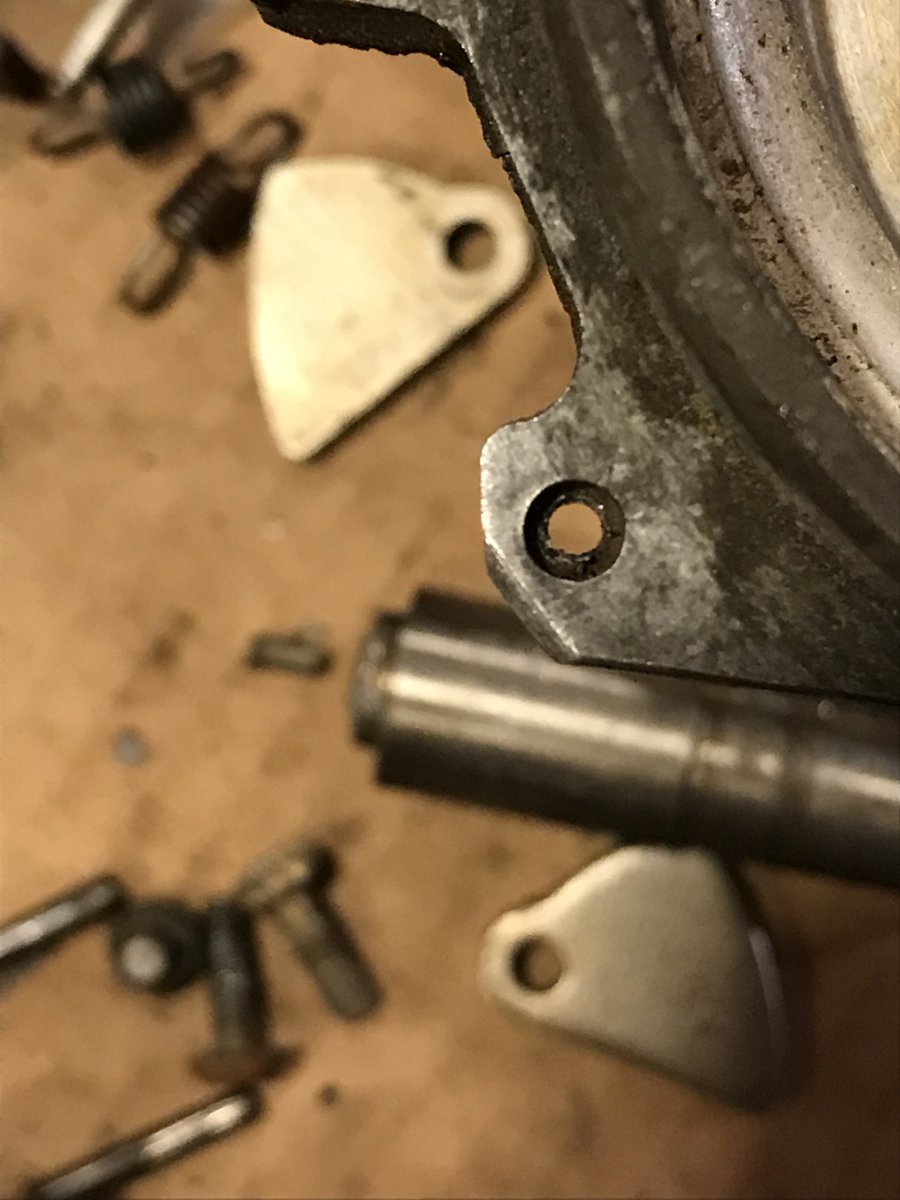

it was centered great, then opened it up to 3mm.

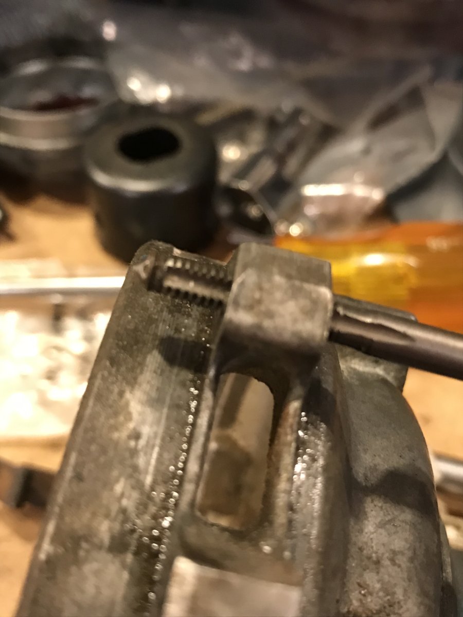

alternating between a bottom and taper tap from the good threads at the bottom it cut a few remnants then the last few turned out intact.
and success

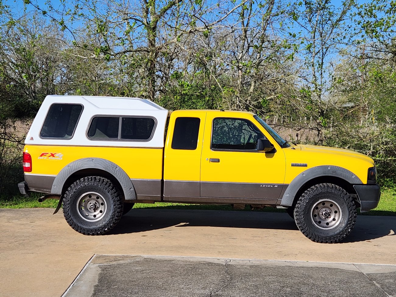

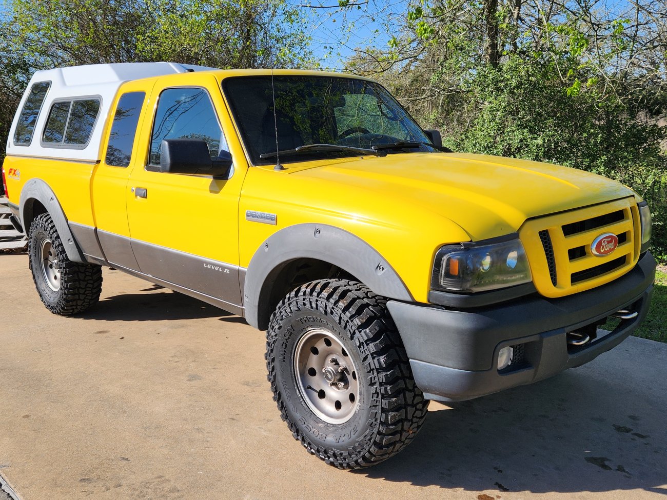

Getting another set of Mickey T's today. 33 x 12.5 x 15.... On 8 inch wide stock Alcoas Edit..7 inch wide. May become a shop queen for a couple while looking at clearance options. The 32 x 11.5 clear no issues, but 33 x 12.5? I'll post a pic later today during the blissful period ~ 1 inch body lift perhaps? I've never done one of those. Only an inch shouldn't be too tough, no more.
Getting another set of Mickey T's today. 33 x 12.5 x 15.... May become a shop queen for a couple while looking at clearance options. The 32 x 11.5 clear no issues, but 33 x 12.5? I'll post a pic later today during the blissful period ~ 1 inch body lift perhaps? I've never done one of those. Only an inch shouldn't be too tough, no more.
The 12.50's are not a great fit on your 7 inch wide Alcoa wheels. 33 10.50 15 would be a far better fit. Less clearance issues too.

I thought they were 8 inches wide. Ok, measured 8.0" - 8.5" outside to outside, from the lower spindle ball joint nut is 1/4" in from the inner outside diameter using that to hold the tape measure at, so perhaps it indeed is a 7" wheel. Well just got done attempting to find out how bad the rub actually is....they barely rub just touching the sway bar but not enough to feel it barely moving. By only maybe a 16th on the passenger side. With no spacers. Measuring the actual width of the widest part of this tire (sorry the pic doesn't show it very well) is 12", same as the last tire which was touted as 11.5" wide at the widest, the "Deegan 38" (11.5 x 32-R15). The tread it's self is of course an inch or so thinner. The Baja Boss M/T has these lugs that stick out here & there. So far today I think that the 33" size may indeed rub the plastic fender well at full up travel just a tad. But I'll be going pretty slow up there. Next month will be going to Alpine, Marfa & Terlingua, TX. rock hounding. Well there are really only a very few 32" choices, and nothing in the Mickey Thompson lineup which I am completely satisfied with. Trailing through the river (at 12,600 ft) on Imogene pass, often the very active (1-2 feet deep) stream, fully takes up the entire width of the trail often 10-15' wide for a quarter mile of so, the need for floatation is a desire. I only air down to not less than 18 psi, so praying that bead locks won't be needed at that pressure, for sure below that with a skinny wheel as it seems that I have. Can't wait for Colorado this July!
