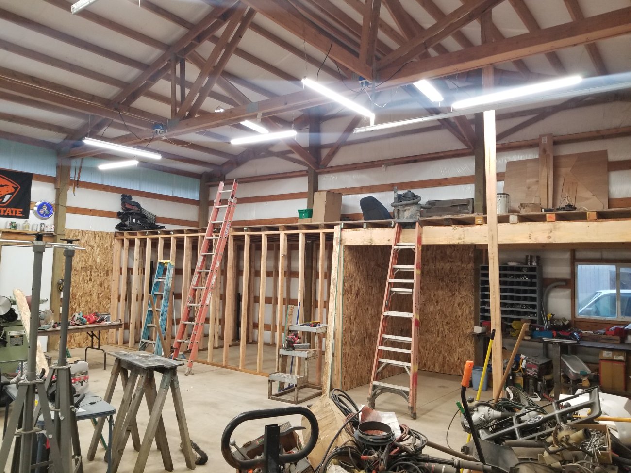

First pic is one newer than I posted before once I screwed down the floor and started putting stuff up there.

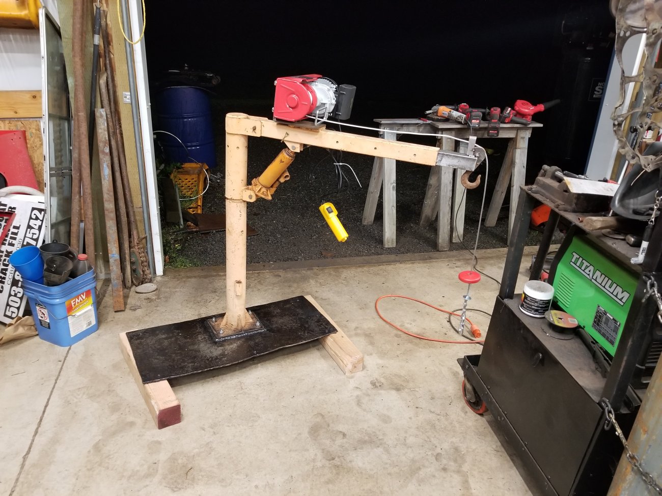

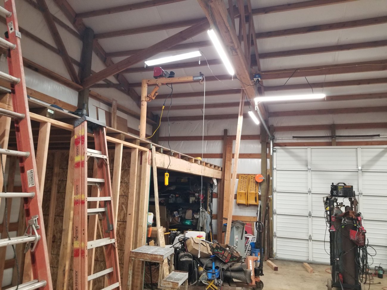

Next is the crane before and after install... I think I'm just going to leave it as is for now and see how it works when lifting heavy stuff... my joists aren't standard, they're 4x4's so they're more stable than normal and I centered it on a wall. I got the crane deal used for super cheap so it didn't come with the telescopic piece or the winch so I bought one of the 110V 1300lb units on sale the other day and had to make the telescopic part with pulley (found a pulley from a come-a-long) and the bracket so the winch would mount to the boat winch plate... used more of the 1/4" plate I used for the bottom...
