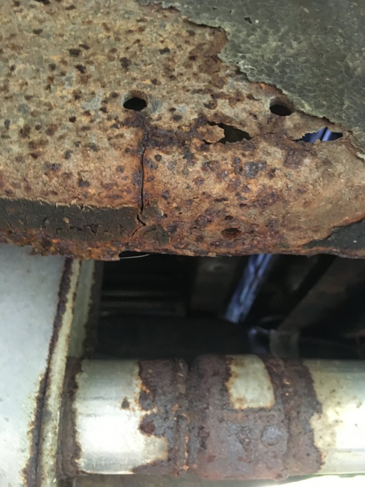

At least this crack terminates into a hole so it's not going to grow. Unfortunately, a lot of the frame around it is also missing. Maybe a good place for a frame repair patch? Weld the crack, treat the rust, and cap with a patch? Only other option is probably attempting to source a frame.

Finally got everything as good as it’s gonna get for now with the F-150 and as I was finishing up I noticed something super unwelcome…
