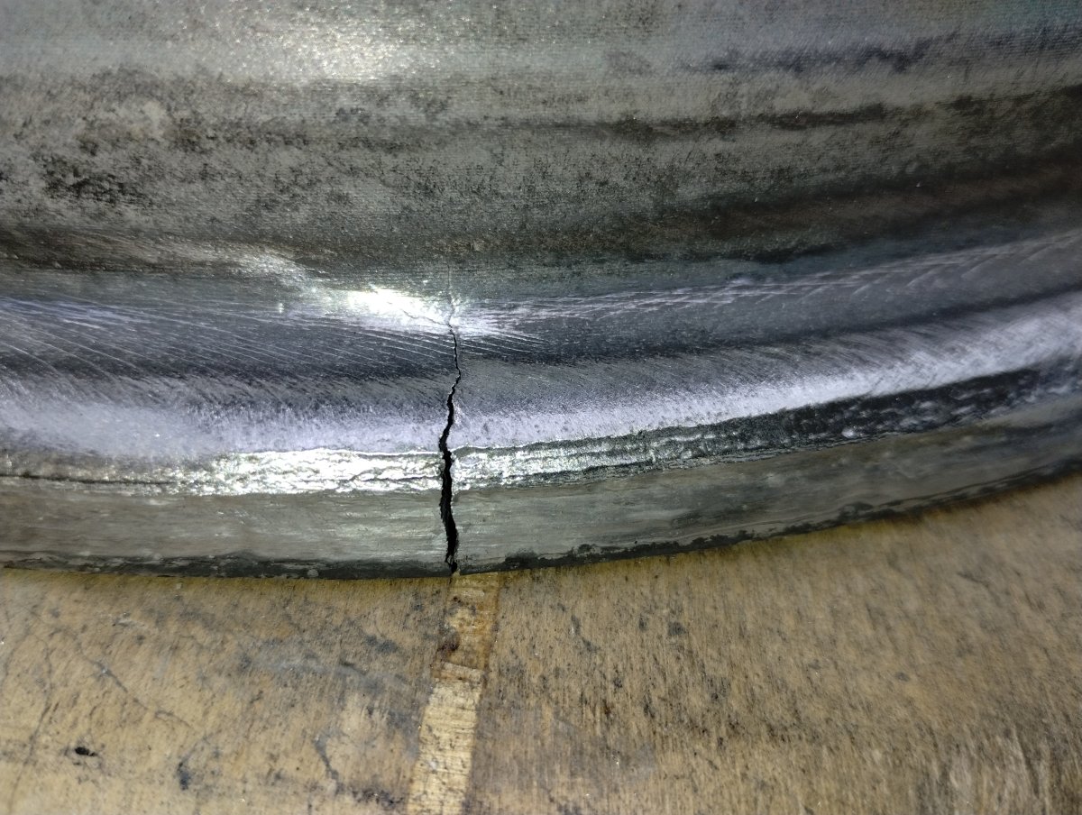

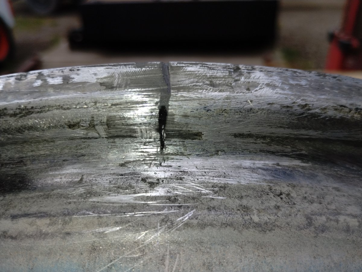

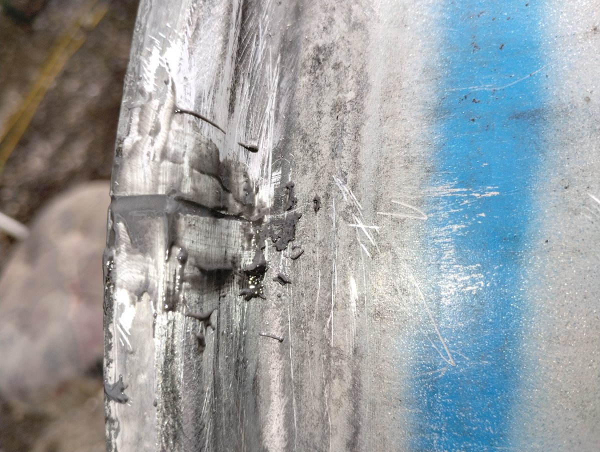

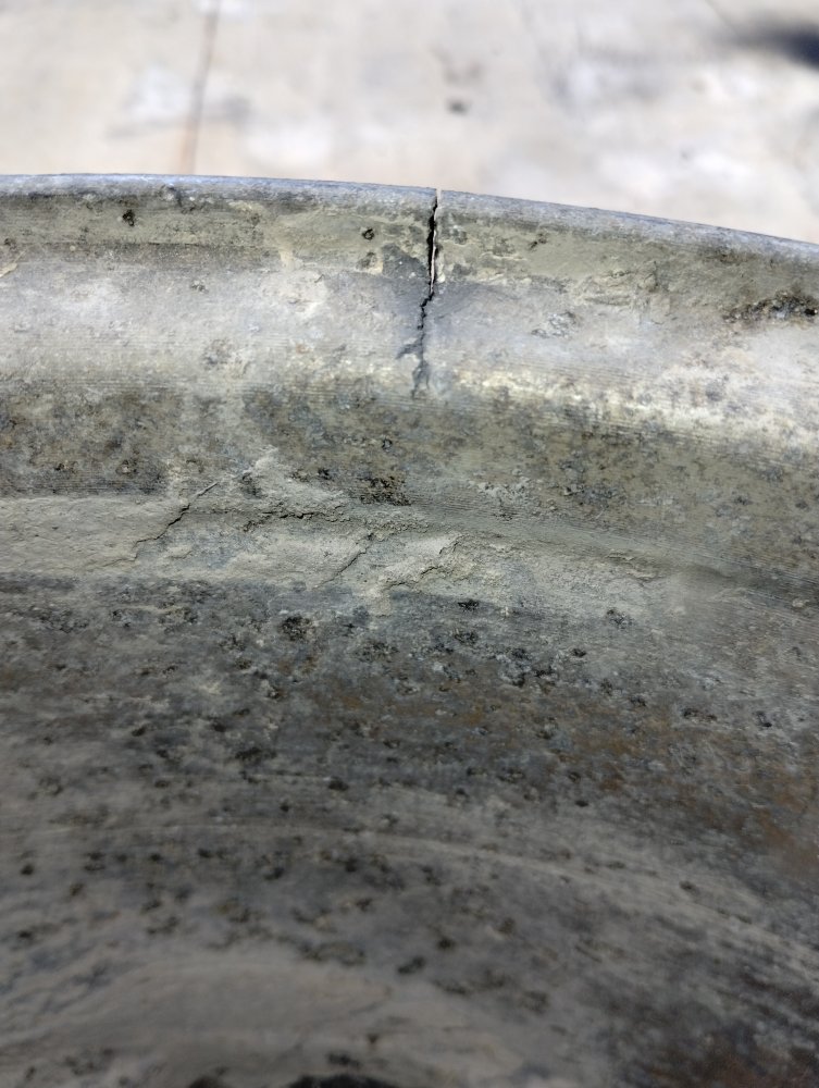

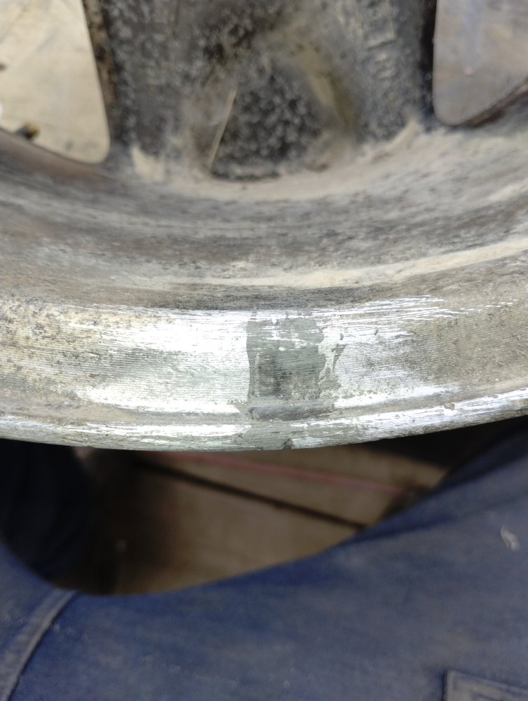

My work has a tire machine and since I had 3 tires with slow leaks, I decided to take advantage. No, I didn't do them while on the clock!...
Dismounted and cleaned the rims and used bead sealer on the rim. The last rim I did had a crack! Aluminum... FML!
Decided I had nothing to lose and v-grooved the crack and filled it with " Cold Steel " 2 part epoxy. Filed it smooth and crossing my fingers...

hate to tell you, but the vertical lip is what gives the barrel it's strength.
no way would I use that wheel. YMMV

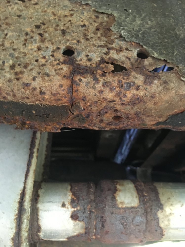

Finally got everything as good as it’s gonna get for now with the F-150 and as I was finishing up I noticed something super unwelcome…
