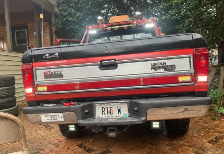

Drove it to town and met dad for lunch at a burger joint. As per the norm I parked so I could sit and look at my truck.
Teeny bopper girl drove thru in a XJ. If you picture what kind of a XJ a high school girl would drive on 33's... this one is slightly better than what you initially picture. She must have just gotten it, it was mostly still there but was beginning the downward slide.
Anyway she drives in and I am parked on the inside corner against the building right outside the window behind our booth, she is gawking coming and going and rubber necking as she drives away looking at my truck... as she keeps goosing the throttle of her Jeep as if there was anyone in the truck to be intimidated. The exhaust had a nice "blown out XJ exhaust" sound quality to it as she revved her way over to the drive thru.
I don't know of the spare tire on the back was shorting her out or what but it was funny to watch. :icon_rofl:
Initial thought was something along the lines of "I don't know how big of a V8 it would take to obliterate a 4.0... but I know how big of one I would use" but I kind of settled on just being happy that a younger person out there is into vehicles enough to get that excited by a rival vehicle.

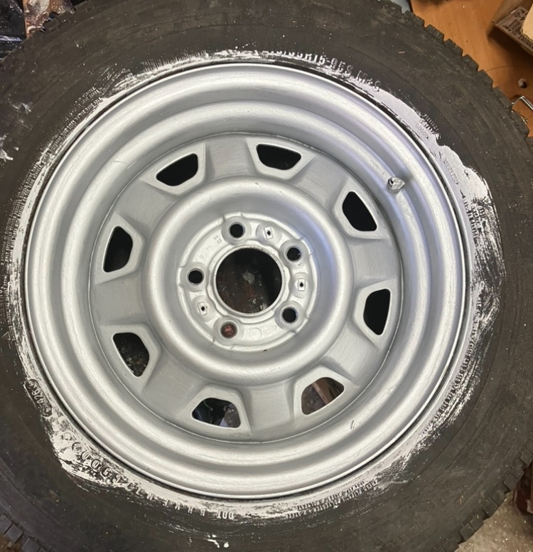

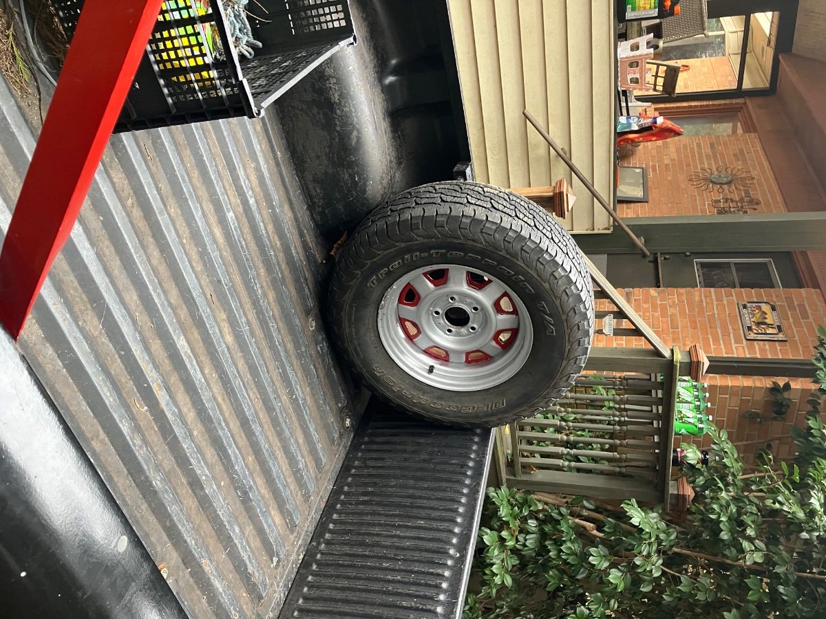

I finally got my new wheel painted up and got the fifth tire (from the set I bought for $200) mounted, so now I now have a very roadworthy matching spare.

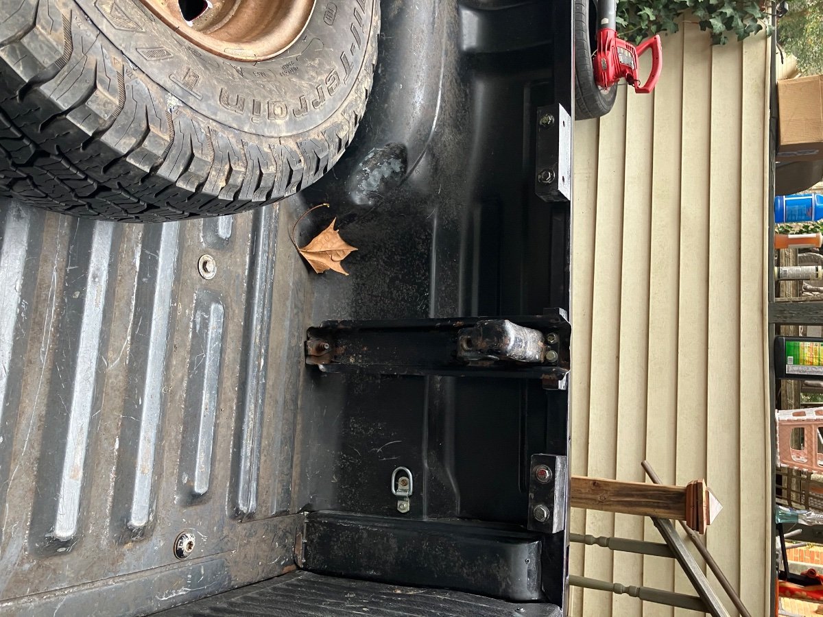

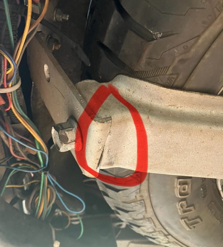

The owners of the Missing Linc before me had pulled out the spare tire carrier from underneath and chopped it up and made a mount in the corner of the bed. They used that truck for charging through the woods before they blew the engine. I started by seeing if that 235/75/15 would fit in there just in case. It fit, but it really took up a lot of space for trying to put things in and out of the bed.

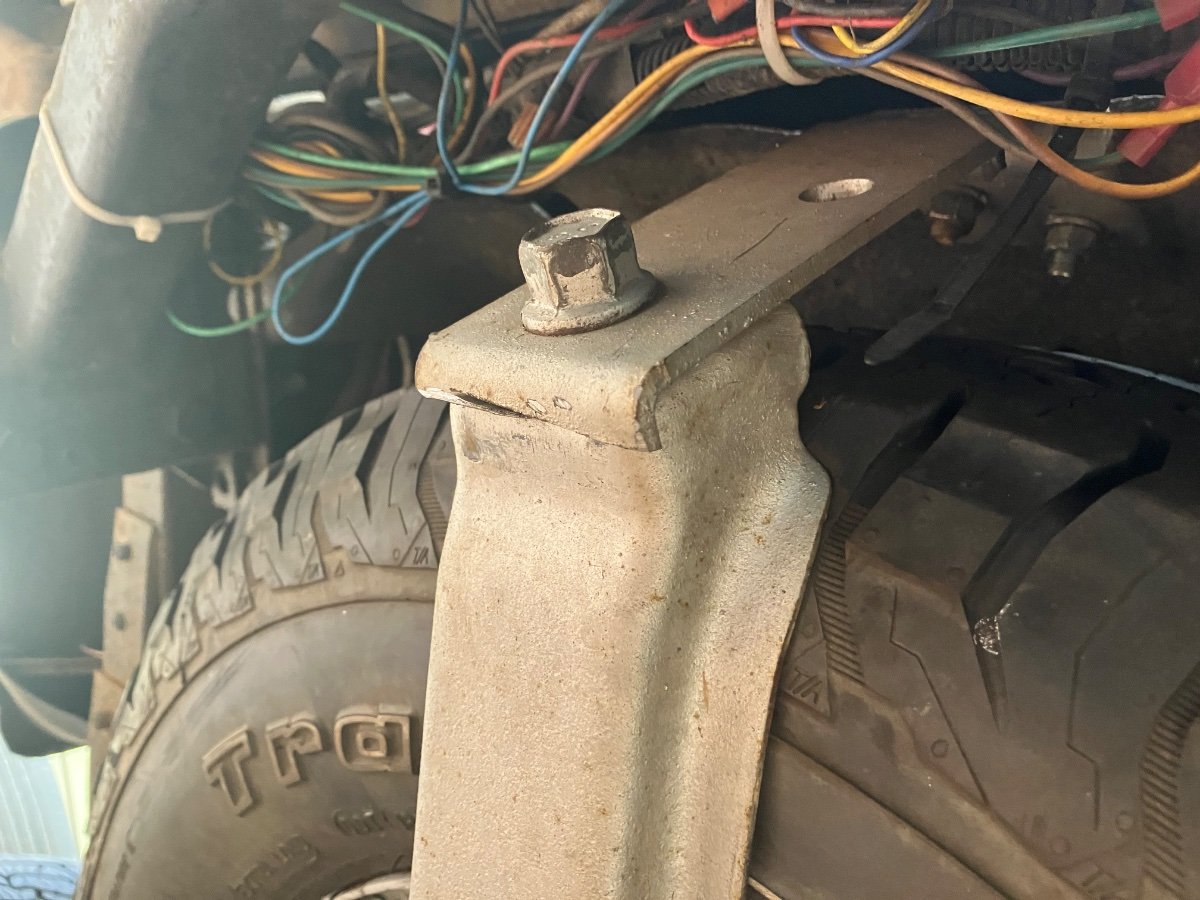

I installed one of the mounts that mounts under the bed a while ago. When I did my measurements with a tape measure, I was afraid that 235 wouldn’t fit under there. I had a 215/70/15 under there. I pulled that out, and then I was very pleasantly surprised to see that the 235 actually fit. Just barely!
When I went to swing it up, that little right angle tab that hangs down behind the license plate would not clear the diameter of the tire when I swung it up. When you tried to move it backwards, it only had about a half inch before it hit the back of the receiver. I made sure I had a spare just in case, and then I used a cut off wheel to just take off 90% of the flap that goes under the tire bracket. There’s still enough there to catch the bracket under the tire so I don’t have to hold it when I put the bolt in.

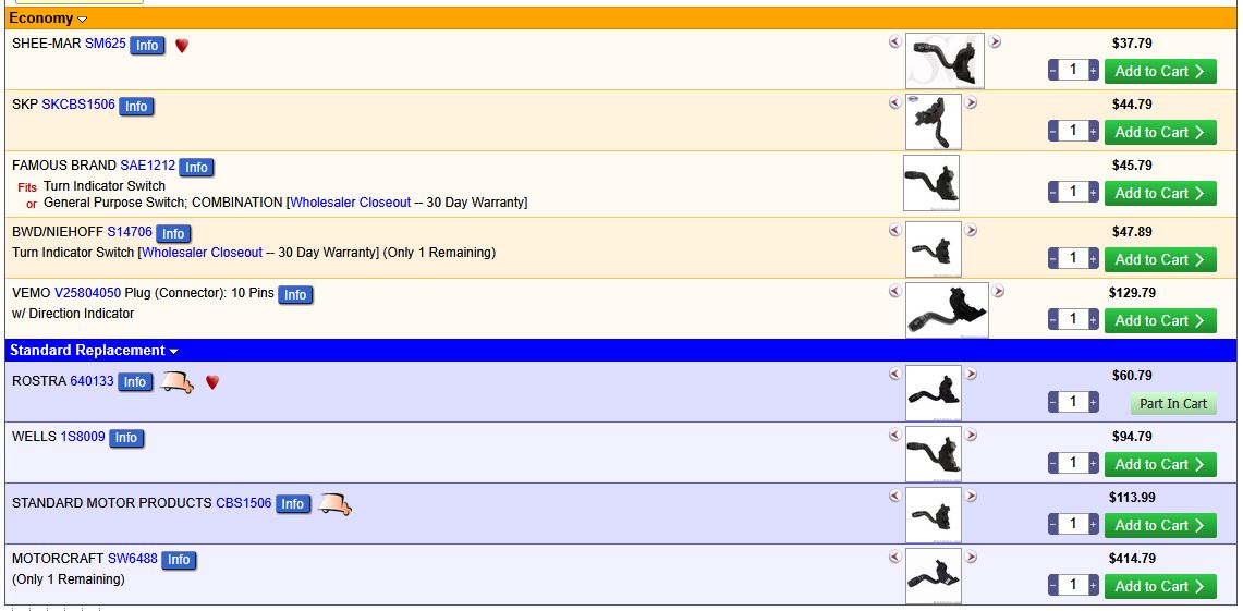

My 2011 Ranger has not been cancelling the TS after LH turns for some time. So now getting around to dealing with this. Appears my MultiFunction switch has failed.
Curious if this is the video you were referring to:
Anyone recommend an aftermarket unit to purchase? Looking at Rock Auto they range in price from about $37 up to $140. And a Motorcraft option is $414 for which I will pass.
So looking for recommendations for an aftermarket MF switch. Thinking the Rostra 640133... not the cheapest, nor the most expensive.
Anyone have any good or bad things to say about aftermarket MF switches before I buy the Rostra?

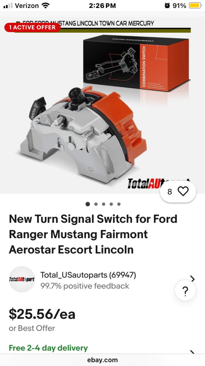

I bought this one on eBay a couple years ago. Recently I had to take it apart and clean up one of the contacts, but it’s probably not the fault of the switch. I have all kinds of extra lights and funky wiring that run off the original circuit. I didn’t even have to replace it, I just opened it up and cleaned the contacts. Also, once you do it, you’ll see that it’s so easy to take in and out, I don’t see why you’d ever pay more than the minimum price which will probably last the average guy years. But I’m pretty cheap.

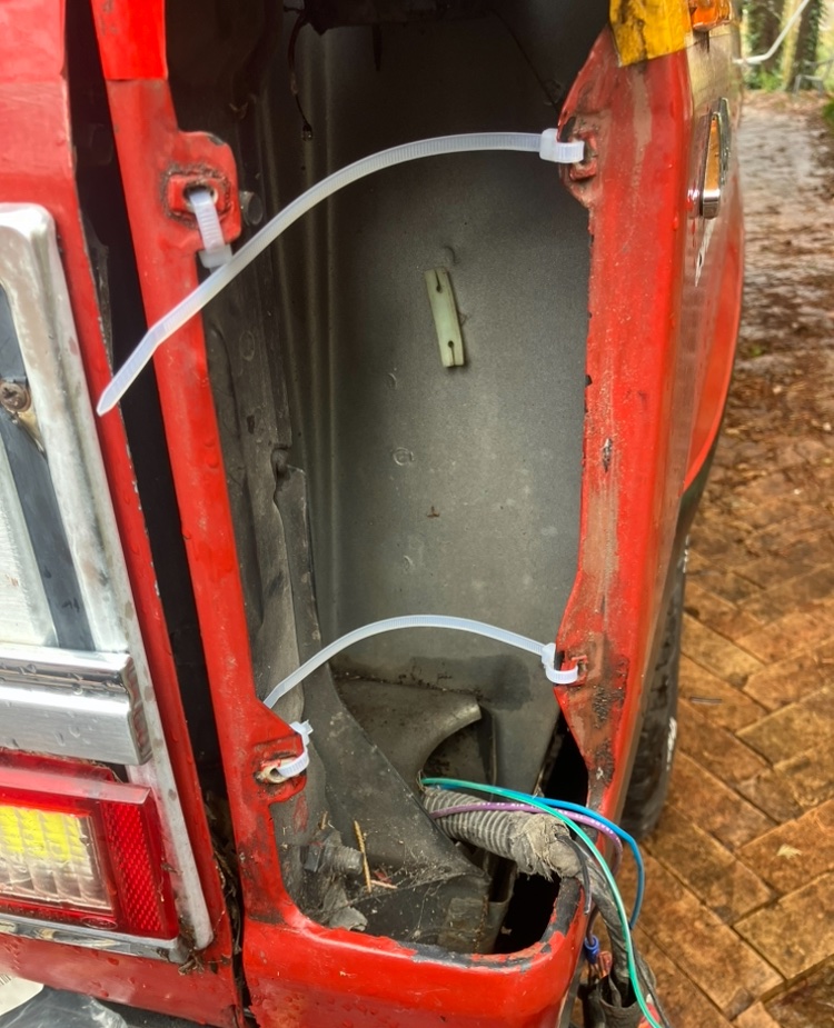

And another Rick’s tip:
Everybody’s probably experienced the little plastic screw sockets getting worn out, making it harder and harder to put the tail lights in without them wiggling. I figured out a while ago, if you just run a 8” zip tie through that plastic piece, it takes up enough space that the screws will hold tight. And since the Zip ties are nylon, they last. If they don’t, they’re cheap, use another one. On the far side, I had one that was completely missing. I took two of the 8 inch zip ties and triple looped them through the hole which ate up enough space so the screw would bite.

Your logic, that it's so EZ to replace, so go cheap - makes sense. Looking at the cheaper priced manufacture closeout, the SAE1212 @ $46. Its a module sold at Car Quest Auto Parts stores for $175-ish normally. That's a nice discount. But it's all a gamble. But I pulled the trigger on that SAE1212 mfgr closeout for $46 on your logic. Which I agree with. Thanks!

There's a formula somewhere that makes it work. Cost, install difficulty, how long til I have to do it again. OE? Sure, a lot of times it makes sense. Cheapo Chinesium? It makes sense sometimes as well.

When I took the old one out, I took it apart, and it had a bad contact in the same place, probably because of the extra lights and wiring I have added. I actually cleaned up that contact, and I have it sitting on the shelf as a spare. Even the cheap ones are kind of heavy duty because they get used constantly.

So far, Standard Motor Products seems to be fine with the stuff I've replaced. Since Rock Auto doesn't seem to have or allow reviews on parts, the hearts next to a product are a good indicator on which ones seem to be working well for others. I tend to avoid the economy marked brands and go with the standard replacement products.
As far as $414 for the Ford part, I would agree on not spending that kind of money. Especially since the part that has gone bad for me is a recall replacement for the original one that came with the truck. Granted, the replacement happened in 2011. So, it got a good number of years under it. But $400+ is a tough pill to swallow.
