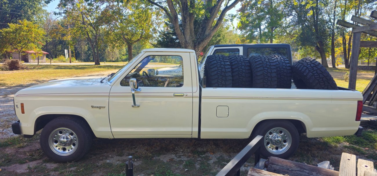

Unloaded the new-to-me tires and wheels I picked up for the Jeep. Got a smokin deal on these but had to drive 2.5 hours to pick them up. The old girl made the trip without complaint.

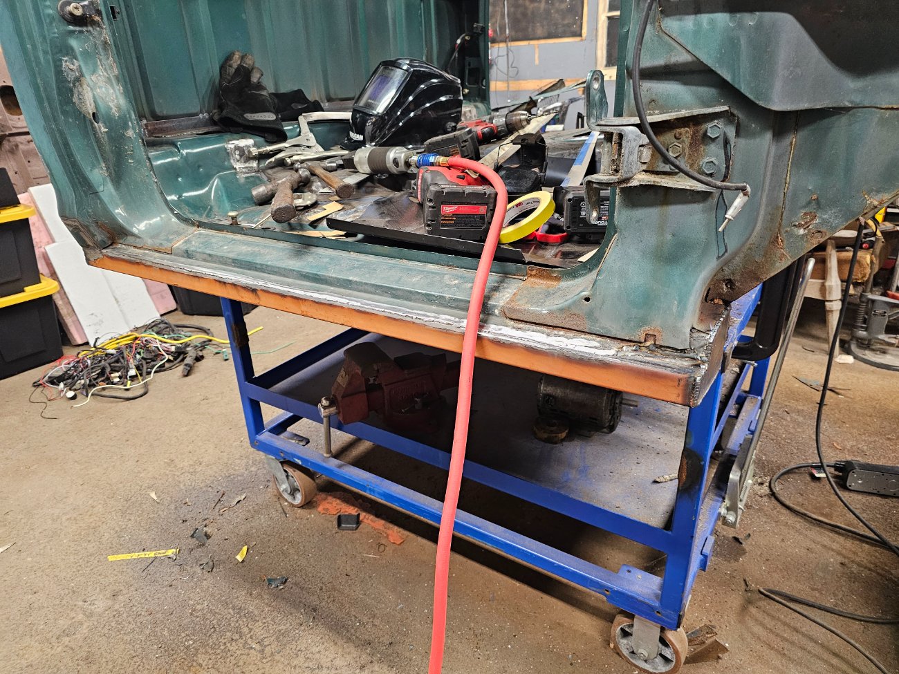

Finished fitting and welding in the other rocker panel in my replacement cab then started carving the passenger floor pan out to get it ready for replacement. I found that, much like the driver side, it's going to take some extra patches beyond the replacement pan, I'll continue messing with that tomorrow.View attachment 134862
BEst I can tell the rockers on the 85 are good, but the DS floor pan sounds about the same. Definitely going to need the standard pan replacement, but it feels like the rot runs down the door seam beside the seat. The front of the ds seat rail feels like it's floating. Also think there is some up the transmission tunnel that is t covered by a replacement pan.
That's the only real rust on the whole thing. Hoping that if I get around to fixing, I might be able to salvage patches from the totaled 84. It was hit in the passenger side back of the cab, so I'm hoping that the DS pan and tunnel is good.

In my case, it was cowl leakage that caused the floor to rot on both sides, when I removed the carpet it weighed better than 50 pounds and was soaking wet. The reason I'm going the route of doing that rather than repairing what I've got on the truck is because my current cab is structurally garbage, all of the structure around the cab mounts is shot and this one is in far better condition. Doesn't mean it's not a project though, haha. Rockers could have been fixed and straightened but I've had issues getting branches and such wedged inside of the cab corners in the terrain I wheel in.

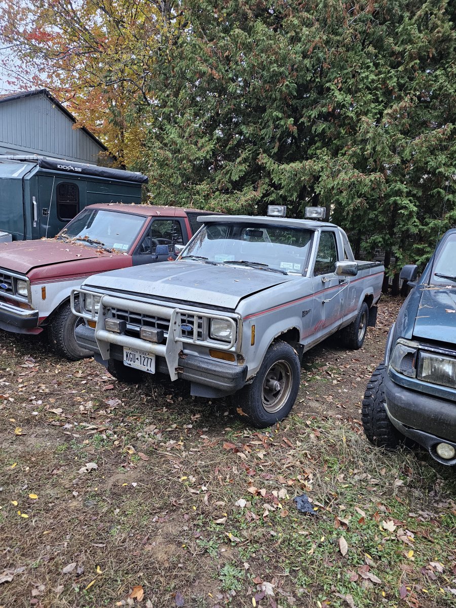

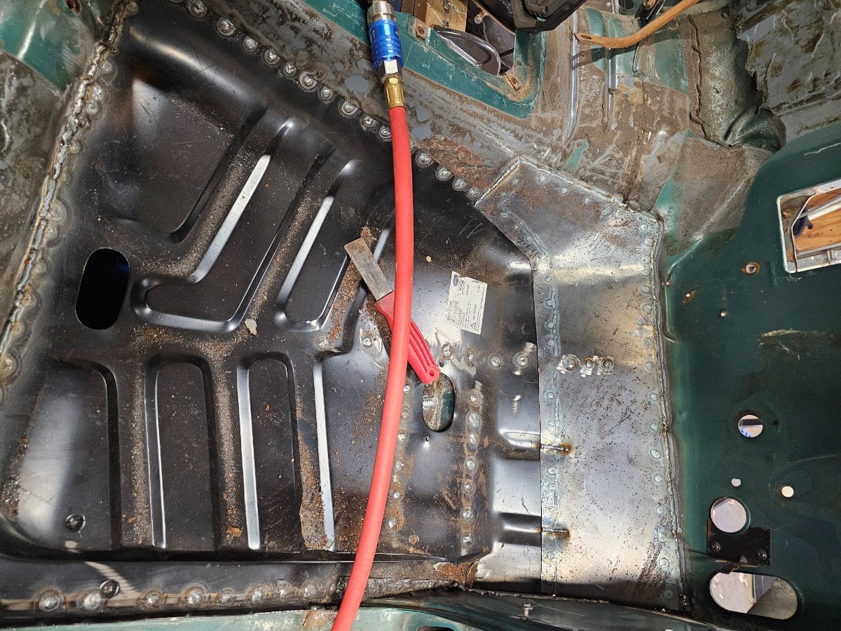

Went and paid the guy for the silver ranger I picked up a couple days ago, then worked on my replacement cab for the supercharged truck some more. The passenger side floor pan is just about done now, getting closer to finishing it up by the day.
